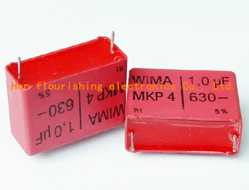

          I also have the Street Fire module sent to me for testing - I'll see if I can get it to work. Interesting to see the cap it uses. WIMA 1uf and supposed to be 435v.
          Virtually identical to this but at the 400 volt range.
Name:	original-new-100-Germany-WIMA-red-Weima-MKP4-polypropylene-film-capacitor-1uf-630V-105-100N-pitc.jpg
          So if I build my own CDI circuits, I'll be using that kind since MSD would have put these through some serious tests and they don't cost very much.

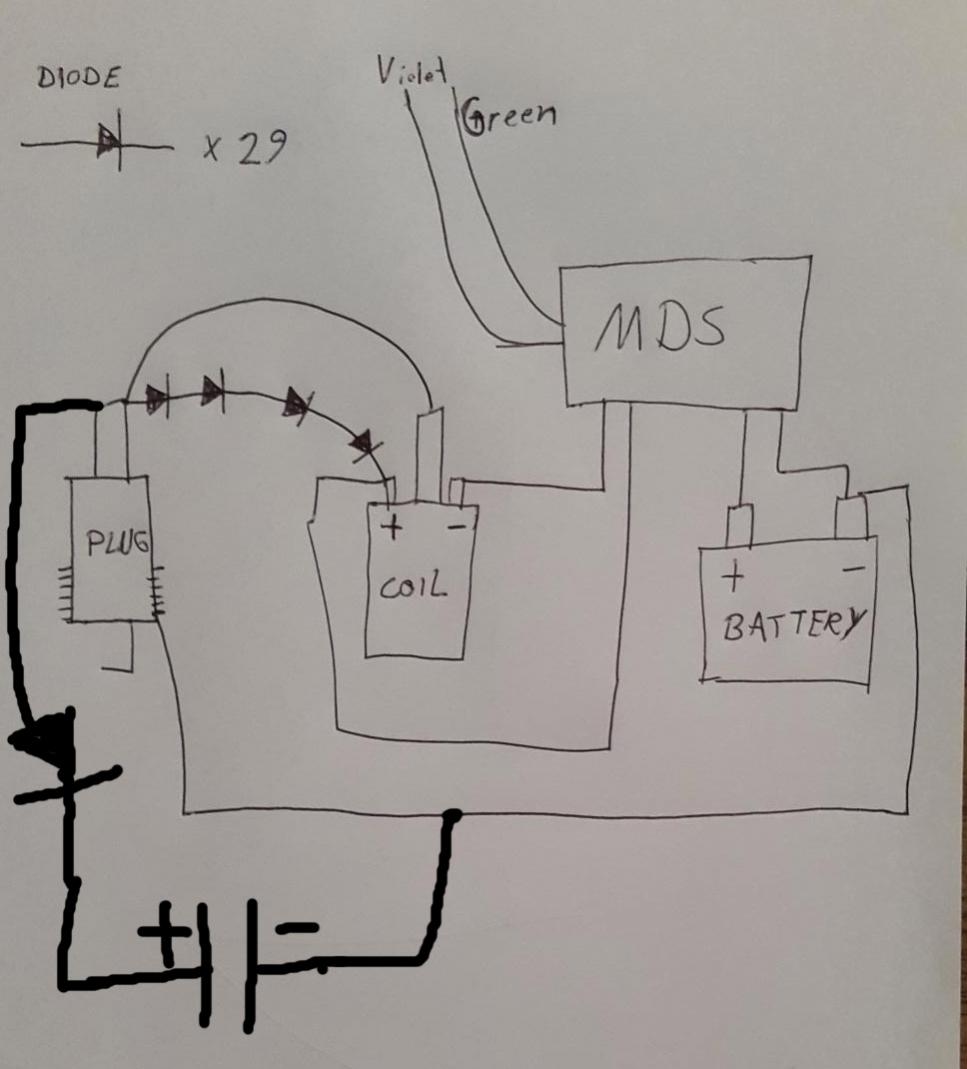

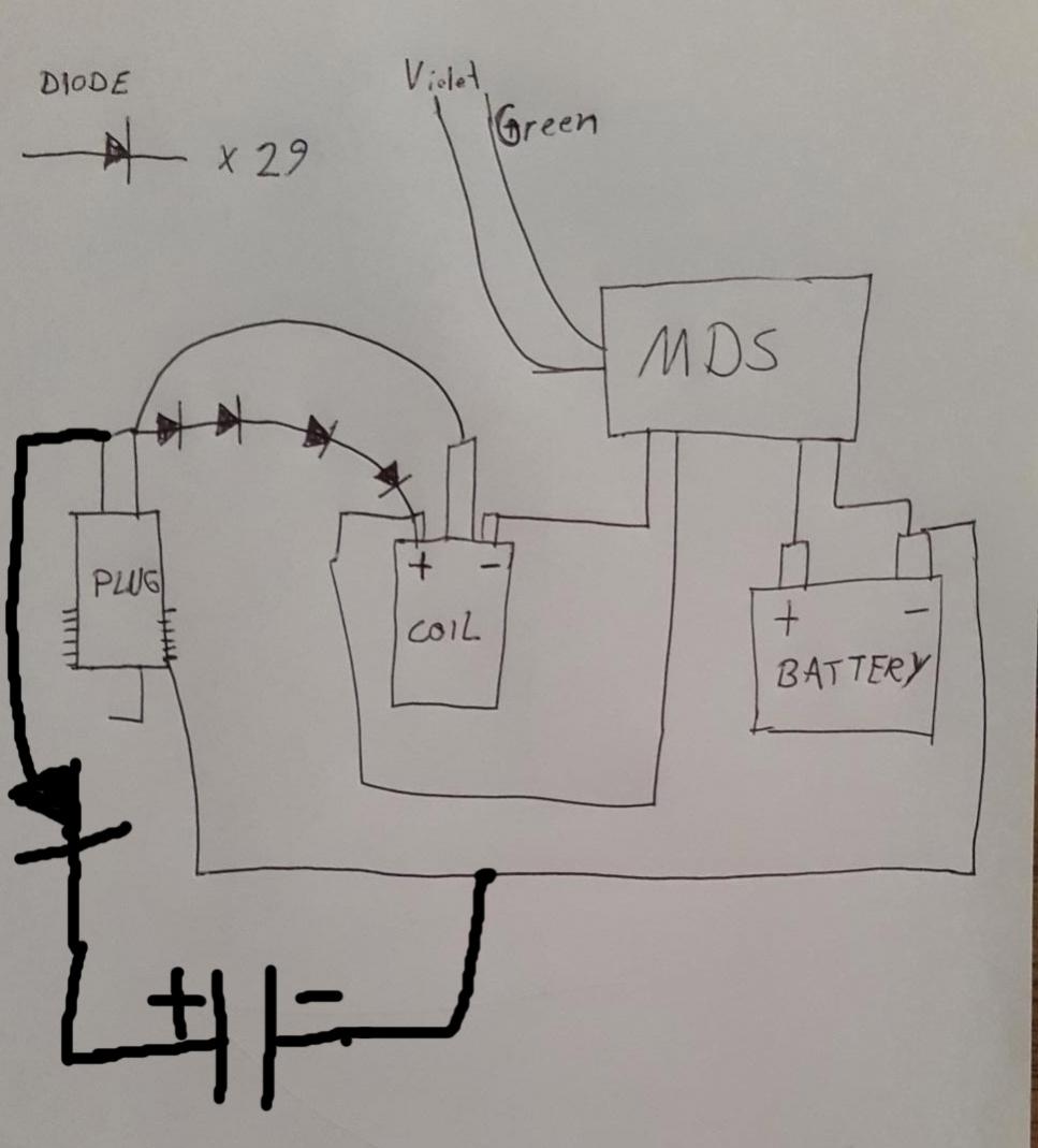

            Here is my simple diagram.
            I hope you can understand it! Witch way do I to put the diode string?
            Once I got the diode string sorted out, then I will be ready to add capacitance. I have seen on earlier posts that caps with low uf (2.2 uf) have been used.
            Will it work with lets say 4 of my 270 uf 330 volt photo flash capacitors in paralell (or series?) charged to 170 volt? I understand that the higher the uf the more time it will take to fill the caps.

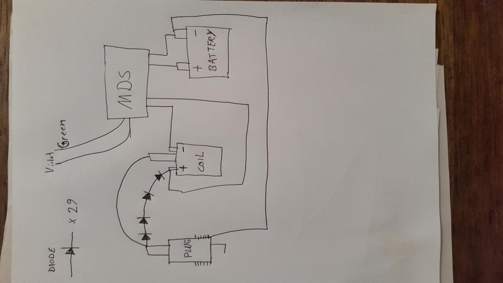

              [ATTACH=CONFIG]4013[/ATTACH]
              Thank you very much.

              I would test that with just 1 small cap first - you want to match the diode direction with that is coming from coil primary.
              Yes, you can use all 4 caps - parallel or series shouldn't matter. If you put them all in parallel, you'll have over 1000uf at 330v so charged to 170v is still a punch. Charging from the wall should be pretty quick even that that capacitance.
              Just start small and build up. Use sunglasses and hearing protection. I'm serious.

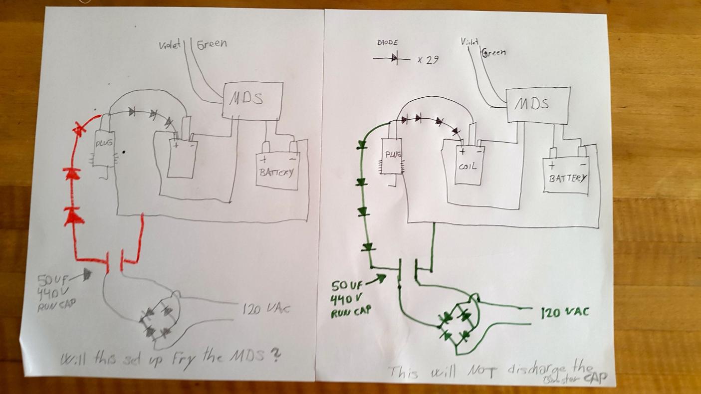

                  If I put all the diodes the same way, would that not lead to a straight path of cap dump into the MDS? I am afraid of frying the MDS.

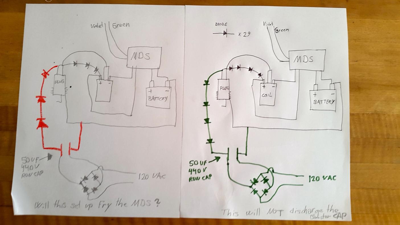

                      Diode string direction.

                      I have tried and tried, but not been able to get the booster cap discharge.
                      The diagram on the right will not discharge the capacitor. I have tried with photoflash caps 270 uf, 330 v charged to 170 volts. Run caps 5 uf, 440v, run cap 50 uf, 440 volt, charged to 120 volts and then later 350 volts.
                      I tried another coil from a 25 year old car, still no luck. I had to use my diode string the same direction on that as well, pointing towards the coil.
                      The diagram to the left, I have not given a try because to me it seems like that will give the discharging capacitor a straight path to the MDS, and then fry it.
                      What I am doing wrong, or how can I make it work?
                            I don't know if the one on the left will hurt your MSD. That is going straight to the cap of the MSD. Maybe if you put a diode from the MSD wire that goes to the positive of the primary of the ignition coil it will protect it? I don't want to be responsible for your blowing the MSD - I know I've exploded a good hand full of electronics myself!
                            Conceptually, the voltage of your booster cap would probably be lower than the MSD cap so won't go in that direction but again, I really don't know. I've done the booster cap method with an ignition coil with HV positive and not negative.
                            The one on the right, even if you have the 400 volt cap, with a 120vac line what is the highest it charges to - 160 volts peak?
