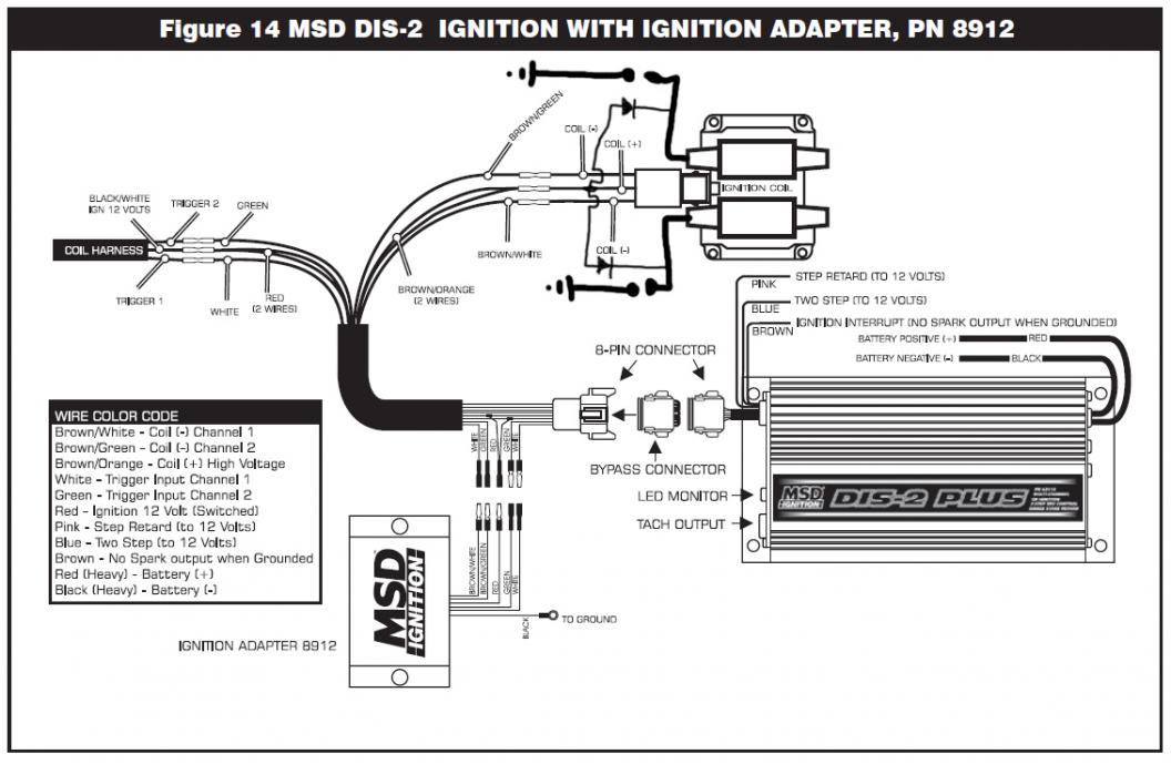

        • That ham radio diode works perfect but on my Subaru with wasted spark ignition, I can get 2 of the plugs to have plasma but not the other 2 and I tried every combination of inverted diodes on the negative, etc... you name it. Still working it out.
          This diagram is exactly how my DIS-2 is hooked up - I show the HV diode connection so I can tell that the left 2 plugs have HV positive. But the right 2, I can't get the plasma no matter what.

          I'm pretty sure the right 2 plug terminals are HV negative. The left 2 always corrode a bit but the right 2 never do. That tells me automatically they're the opposite polarity.
          I tried the diode reversed from the negative line trigger connection on the coil to the top of the plug - nothing - tried both triggers - nothing.. tried diode forward, nothing. Reversed it from the center + connection - nothing.

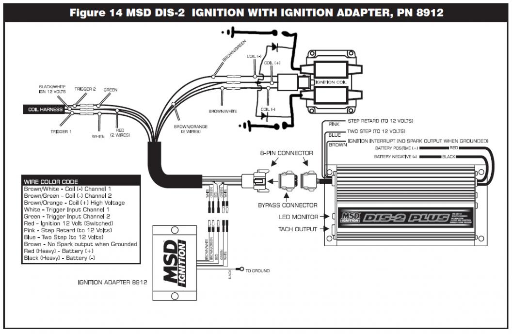

                    • I understand the sequence of events in a wasted spark ignition but never had a need to actually learn what the internal wiring diagram of the system is.

                      That means when I have the diode like below in the MSD diagram, the plasma should already be there on the other plugs - I just didn't disconnect more than one at a time.
                      The HV discharge voltage (not current) moves forward to ground and from ground back to the center electrode of the opposite side plug, which makes a complete path back to the HV winding.
                      If that is the case, then the plasma should automatically be at the plug I could see - top left and it should be there at the top right simultaneously. Therefore, just connecting one of these diodes as indicated below, plasma should be at all 4 plug.

                      • Aaron, your MSD DIS II has two internal coils each coil operates two plugs. Check to see if the circuit is open (not switching) on one of the coils, if the circuit is open on one of the coils then two of the plugs will not fire.
                        • See pg 11 for pin arrangement http://www.msdignition.com/instructi...df?terms=62152
                            I'll test that idea out soon and will report results.
                            Thanks Longhorn, that is what I realized today that 2 wouldn't fire if one is unplugged.
                            I did my test and verified that by hooking up the diodes as I showed in the diagram, I DO get plasma on the other side automatically - it is just basically jumping 2 gaps, but with my test actually jumped 3 since I left the other plug in place and just put another plug between the book and coil terminal.
                            So 1 diode like this can do the entire engine just by connecting it from the + of the coil input to the 2 plugs on the side where the HV + voltage comes out.
                            Anyway, it's a SUCCESS as predicted - the plasma works for the whole system!!
