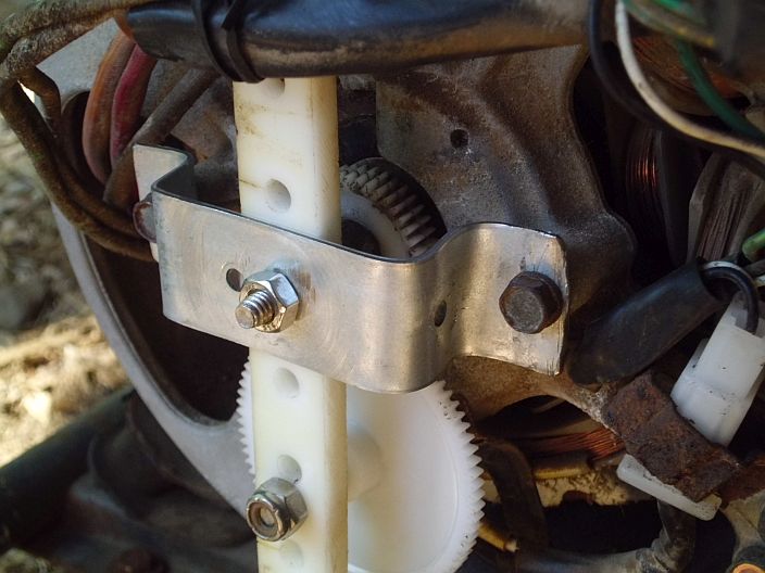

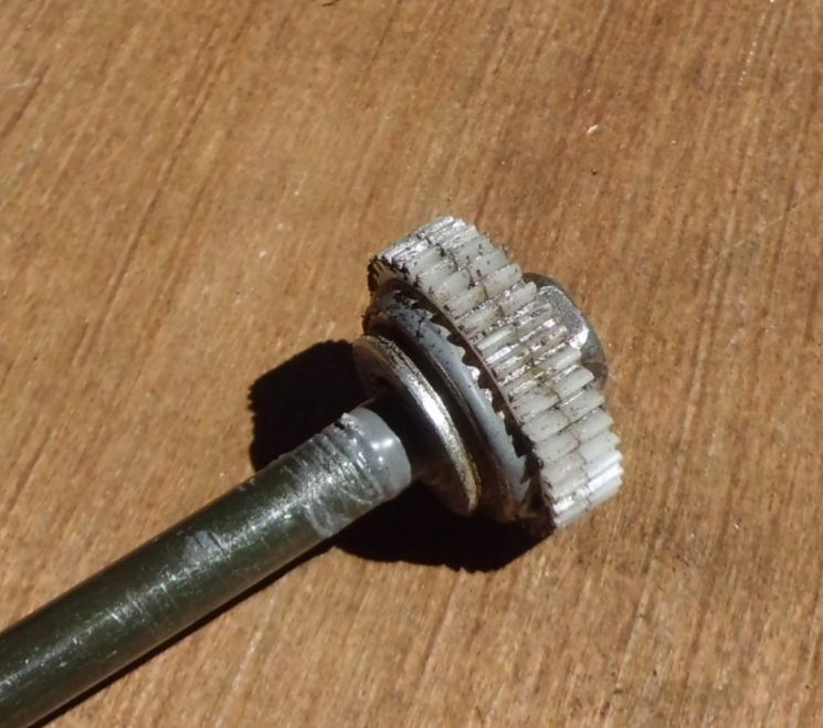

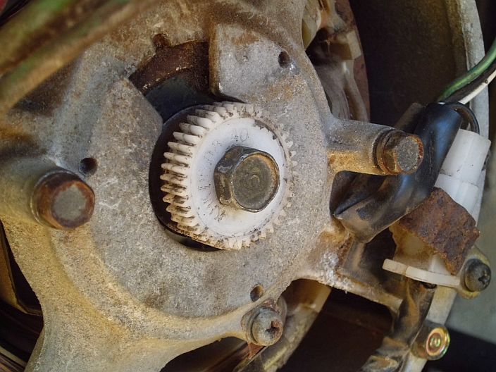

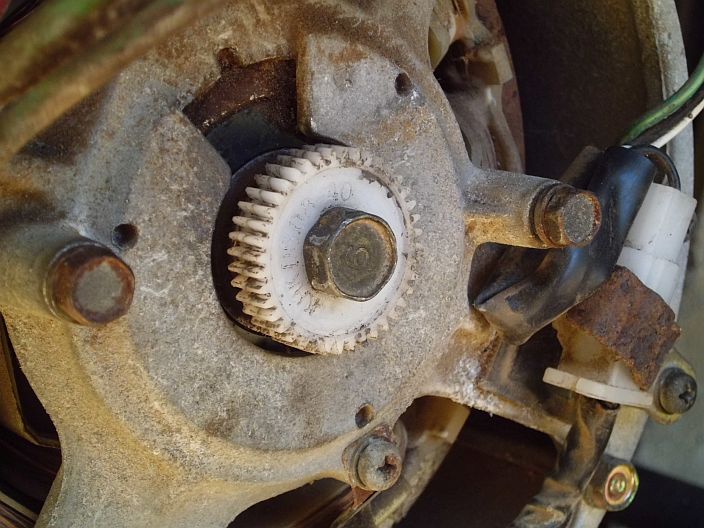

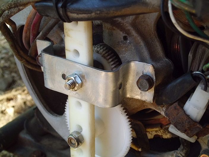

                              • Here are some pictures of how I am making the waste spark eliminator on a Yamaha YZ360 generator. My objective was to make a cheap proof of concept before sinking more money into better parts. Gears are expensive! And I am not much of a mechanic, so pardon the crude fabrication to which I am limited. I found these injection molded plastic gears from Quality Transmission Components: http://www.qtcgears.com/RFQ/default....rs/KHK110.html
                                I used the 40 and 80 tooth pieces, module 0.8. First I pulled the long bolt that fixes the rotory field magnets to the engine, and used JB Weld to attach two gears together, along with some spacers to extend the gears out of the bearing holder. I used two 40 tooth gears to make mating with the 80 tooth gear less critical, and to better withstand the torque on the bolt.
ID:	46643Click image for larger version
                                It would be better to use gears with a steel core so that they take that considerable torque to which the long bolt is tightened. It would be even better to make a new bolt that would be longer, with an added section to hold the gear such that the function of the bolt is not compromised. I then made a bracket to hold a pivot for the large gear, such that timing can be adjusted by rotating the pivot. The bracket mounts on the holes that hold the cover plate on.
                                This gear will have the magnet which will trigger the hall effect device. It's a work in progress. I suspect the gears will last a while, since there is no stress on them. I hope that the rotor won't decide to slip in the generator due to the lessened torque on the bolt. Overall cost is low.
                                At first I looked at the use of a pulse delay circuit to effect the ignition retardation, as shown in the material from Patrick Kelly, but eventually I thought better of it, as it only will make the proper delay at one value of RPM. That might be OK for a 3600 RPM generator, but getting there is the problem. If we are dealing with high flame speed, then only a mechanically syncronised ignition will give a spark at 0 degrees TDC at any RPM. Backfiring is to be avoided!
