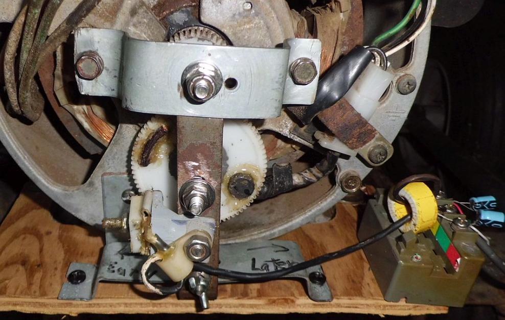

      Here are some details of what I have done so far with my Yamaha 5kW generator testing. No need to be impressed, it is rough and ready, just for R and D (repair and destroy). Below is the Hall effect ignition controller, which accomplishes the waste spark elimination and one level of timing control. This works well so far:

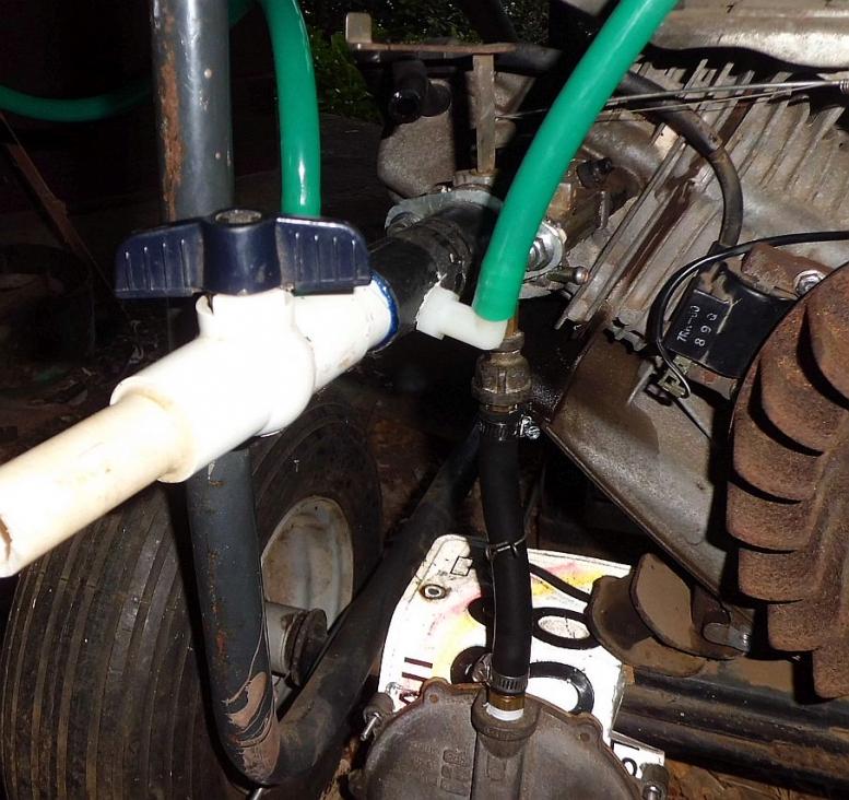

      Here is the modified carb, with hoses for air, propane, HHO, and water vapor:

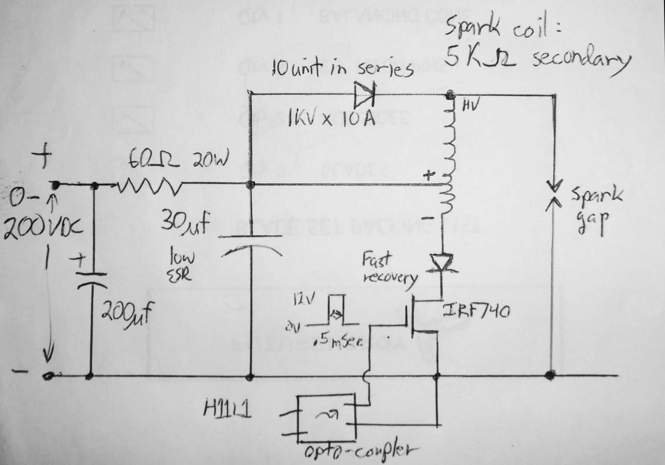

      Then the schematic I am using to generate the plasma spark. It uses a standard old automotive spark coil, an isolated variable 200VDC power supply, and an opto-coupled input from the pulse generator hooked to the ignition pickup. I am using an NGK BP4ES plug, which has no resistor, and have bent the gap well open. It makes a nice thick spark. I have a scope on the other side of the opto-coupler, so as to keep out that nasty EMP as much as possible. I can add another delay to the ignition pickup circuit to control ignition timing to a greater degree.:

      I can generate about 1 lpm of HHO using a standard brute force electrolyzer. I have two cold mist units, one a simple puck that draws about 30W, the other the nebulizer I posted about earlier. As for that particular unit, one should know that these (many similar ones out there) have a blower fan internally, so that they will also be adding air to the output. That may not be what is wanted. My simple mist generator is sealed inside a glass jar and lets no air in, just vapor out.
      Playing with all this, I can say that I have *not* been able to get any sign of ignition using just that small amount of HHO, with or without the vapor. I tried ignition timing from TDC plus or minus 20 degrees. Nothing. So it may be too small an amount of HHO.
      I can get things running on propane, and lean out the mix while adding HHO and vapor, but I have no real measurements on that yet. Clearly the combustion is clean, as that characteristic propane generator smell is absent. But there has to be some hydrocarbons present to get the engine to run. The ignition timing ends up being about the same as stock.
      I want to try some of the other types of spark plugs, which are made for this sort of pulse. Also, I am looking at ways to prolong the plasma spark. My first idea will be to add some small inductance in series between the HV diode and the discharge capacitor. These ideas were put forth earlier in this thread but nothing more was heard on that subject.
      Lots of work for not much result yet, but I wanted to make a data point in response to the info in Patrick Kelly's chapter 10 PDF. The generator conversion there was using modified timing, no plasma spark, water mist, and 5 lpm of HHO. Not being able to find any sign of ignition with my setup, sans propane, makes me wonder about that. Still testing....

                      For plug ware reduction by eliminating the waste spark, when it sparks, the exhaust port is open and there is no pressurized gases at the gap so the dielectric resistance value at the gap is very low and only requires a few thousand volts to fire so the corresponding current will be quite low and probably doesn't contribute to much plug wear.
                      The simplest way for anyone to delay ignition closer to TDC, not much, but free and easy is to have the biggest gap possible at the plug since it takes a bit more time to jump the gap if the gap is bigger. If we use surface gap plugs, then we have about as big of a gap as we can get.

                          With booster caps, yes, that is to err on the side of caution. However, it would be nice to see some test of prolonged use of plasma at different strengths and have the engine disassembled to see what the actual damage is. That would be awesome - haven't seen that yet. I just saw the bench test damage of different electrodes and coupled with the fact that the plasma grows with air and moisture, that was all I needed to know to realize that plasma on the smaller side is probably best for most applications.
                          I have put diodes from the HV output of the coil to keep anything from going backwards into it but I've never seen that it has made any difference.

                            Way too many diodes. 10kV total rating is plenty, IMHO. Try 15 in series if you want lots of safety margin.
                            As was pointed out early in this thread, seeing the spark gap as a switch makes this all quite easy to grasp. The spark coil is only putting out enough voltage to jump the gap, which is probably less than 10kV given even a wide open spark plug. As soon as the gap is jumped, i.e. the switch is closed, then the voltage across it goes down, and the cap dumps its charge into that low resistance. So the diode voltage rating is defined by the spark gap voltage. The size of the resulting plasma spark is determined by the size of the capacitor and the peak current through the diodes. Most diodes have a continuous rating, and an avalanche rating which is much higher. The avalanche rating is what this circuit will be stressing as the average current is low.
                            As Aaron mentions, I think it is easy to go overkill on the plasma spark, so no need for extremity.
