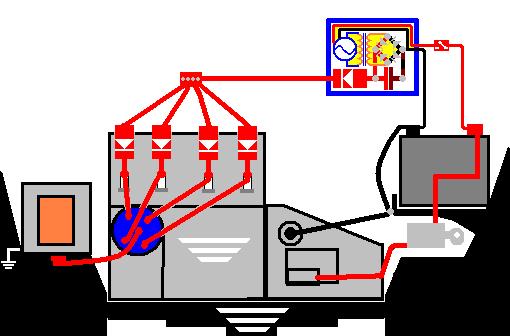

    But with the coil pack HV (-) output and the booster cap (-) output both grounded onto the engine head, say, central to all 4 spark plugs...
    1) might the cap (-) output flow backwards from the booster into that HV (-) wire into the secondary winding of the coil pack?
    2) might the HV (-) output flow into the LV (-) cap output along the wire into the booster?
    In both cases I hope that the HV (+) event in the gap will be enough to make both above mentioned worries, an impossibility. But I would like some logic and wisdom regarding this, so i can just do the connection, and move on to something like ionizing the intake air.

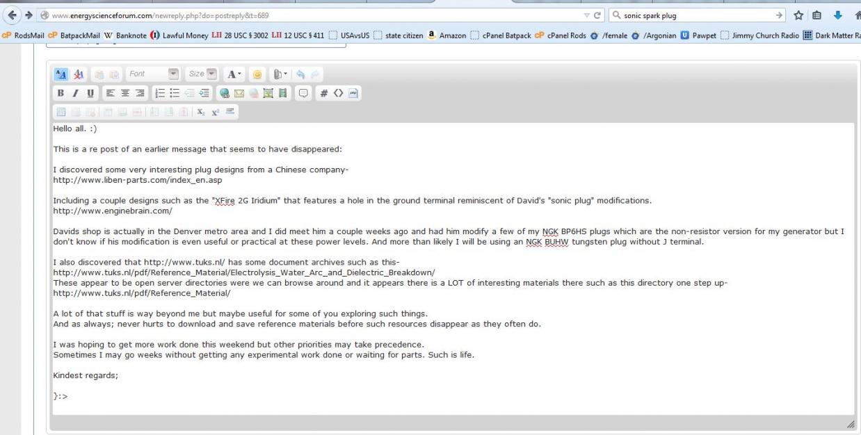

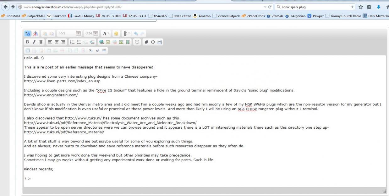

          Hello all.
          This is a re post of an earlier message that seems to have disappeared:
          I discovered some very interesting plug designs from a Chinese company-
          Including a couple designs such as the "XFire 2G Iridium" that features a hole in the ground terminal reminiscent of David's "sonic plug" modifications.
          Davids shop is actually in the Denver metro area and I did meet him a couple weeks ago and had him modify a few of my NGK BP6HS plugs which are the non-resistor version for my generator but I don't know if his modification is even useful or practical at these power levels. And more than likely I will be using an NGK BUHW tungsten plug without J terminal.
          I also discovered that http://www.tuks.nl/ has some document archives such as this-
          These appear to be open server directories were we can browse around and it appears there is a LOT of interesting materials there such as this directory one step up-
          A lot of that stuff is way beyond me but maybe useful for some of you exploring such things.
          And as always; never hurts to download and save reference materials before such resources disappear as they often do.
          I was hoping to get more work done this weekend but other priorities may take precedence.
          Sometimes I may go weeks without getting any experimental work done or waiting for parts. Such is life.
          Kindest regards;

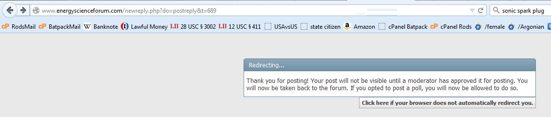

          • Post failed again.
            Hey Aaron.
            If this is the case then maybe there is something specific to this message or one of the URLS because it just did the same thing again.
            I attempted to post this message then got this response. (see attached)
            But then, if this message comes through . . . then don't know what is going on regarding why that specific message is generating that system response requiring a moderator approval...
            Not sure what the issue with the post is. They don't require moderation before showing up.

                Ok - I was seeing the messages but you weren't. I approved 2 moderated posts. You have some that post automatically and some that require moderation. Makes no sense to me. Will have to look into that.
                This is the first time I've seen that there were moderated posts. I hope that hasn't been the case the entire time for all users. Looks like it might be just with posts that have links in them.

                                Can you post a diagram?
                                Sorry Aaron, I didn't see your request. I used Microsoft Paint and drew the picture of how my cap booster box I connected onto my wife's Fiat Uno 1.4 engine.
                                The blue box is my cap booster [black in real life], and its cap charge circuit is represented by an AC symbol of sorts in this drawing.
                                In my actual box is an MMC capacitor, but I don't know its peak rating - after everything soldered together. the box's output measured 910Vdc, so a few transformer secondary loops were took off to reduce output to just over 400Vdc so oscillator mosfets run cooler [they have their own heat sink external to the plastic box not shown here].
                                The diode symbol in the box drawing represents its 30kV 6A diode string.
                                We used dark grey 11kV insulated Neon Sign Wire for both the cap (+) output wire connected to a 4 terminal block, and as well as for the individual wires connected in parallel with HV ignition wires onto the spark plugs.
                                The individual diodes connected parallel onto the spark plug wire connectors are 20kV 0.5A MWO diodes - so total protection in series for the cap (+) output and thus cap charger circuit [excluding the FWRB] is 50kV 6.5A.
                                Now my confession:
                                Cap (-) & charger (-) I in my opinion WRONGLY made common, grounding both onto battery (-)...
                                In retrospect it appears to me that spark plug bases only get whats left of the "hot current" after the parallel split on the battery (-) pole, between the battery and the long-resistance path via battery ground cable, over metal gearbox casing and engine metal, to screwed-in spark plug basis.
                                It maybe helps to get the booster's cap "charged" at not less than battery (-) volts... and it might add a longer-duration LV (+) on spark plug center electrodes [therefore maybe the funny red-blue dark purple little plasma ot helsp to achieve..
                                BUT.. it is a ridiculous connection of the booster's LV (-) output, since its charge circuit can keep the cap charged-up up to even whats required by Mika's rotary rev-limit range.
                                Proposed Solution:
                                Separate cap (-) output from Charge Circuit (-) input, and GROUND cap (-) output onto engine [even an old kettering's condensor is grounded on the engine!]
                                Request for Your Advice:
                                IF cap (-) were connected onto an engine nut closest to the amp box for shortest discharge path, will each spark plug get the same cap LV, or will it reduce as the spark plug is situated further from that LV connecting nut?
                                Or would a parallel terminal block setup [like i did with the cap (+) output] better accomplish equal power output among the spark plugs, each having a wire connected on the closest nut to it?
                                [I know for sure that connecting the LV directly on the spark plug base would be path of LEAST RESISTANCE but not all engine heads leave enough space for more cabling between engine head and spark plug for cables to reach the base and not get heated up by engine head pressing against it]
                                Normal electric logic says that in a parallel circuit Amps are divided according to the Resistance of each component, but that the Volts on all those components will be exactly the same as that of the Voltage Source.
                                But HOW does that apply to plasma ignition - is there diversion from this law or is it one that we can still apply here?
                                [don't worry, I'm not barking up the "don't dare change the laws" tree ]
                                I think it very much have relevance to connecting wasted spark HV output in parallel onto the spark plugs as discussed in previous posts on this thread, since spark gap in compressed piston gasses, and spark gap in exhaust gasses, experience unlike gap resistances...
                                So if the above mention parallel "law" does apply to plasma ignition, especially adding cap booster, on wasted spark ignition in HV PARALLEL mode, the WRONG gap will get "hot current"... most going to spark gap in the Exhaust Stroke that does NOT NEED it, and the least amount going to the spark gap in the Compression Stroke were it actually IS NEEDED...
                                That will be such MORE WAST of battery and alternator and fuel for already WASTED SPARK ignition, working against the solution of connecting spark plug pares in parallel onto the coil pack HV (+) poles that you suggested in previous posts in this thread for wasted spark ignition.
