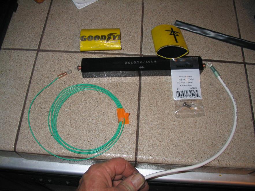

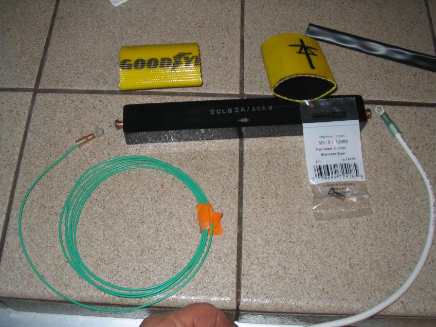

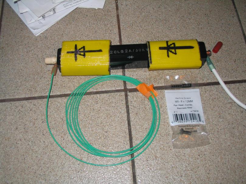

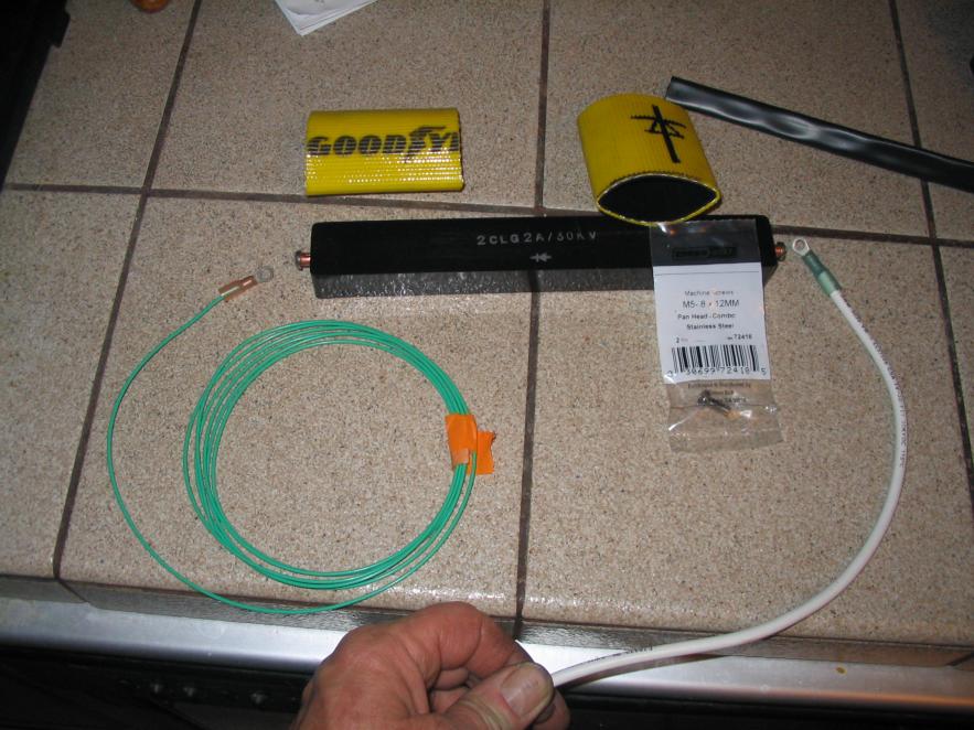

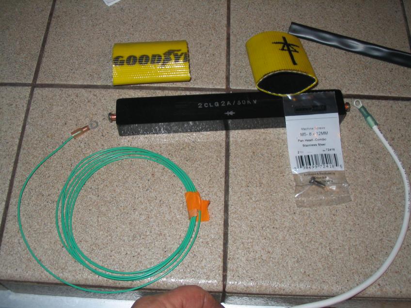

            Ok here's some pics/info 'bout how I did the diode Blocks/wires on my Subaru.
            I found auction on ebay for "Ham diode HV" after Aaron gave clue to look for those as diode solution. I picked 2A 30 KV ones. They came w/o screws for end terminals. Found M5 stainless screws at home depot and cut little pieces copper tubing for crush spacers to take up extra screw legnth. Other auctions included screws, BTW. Thin 22 Gau. (Ithink it is) green hi temp insulated wire from Silver State Wire goes to end of block that diode arrow symbol points at, to coil + primary side. Blocks are wired daisy-chain together then to coil+.
            30KV white silicone wire (ebay) goes to other end of blocks. I used the black industrial shrink tubing from Silver State over full legnth of these wires for xtra protection, just my idea. These are the wires that connect into the plug term. of plug wires.
            I found some yellow Goodyear industrial hi pressure water hose at an industrial rubber/hose supply house. got 2 ft., cut to 3 inch pieces to act as cushion & sheilding for ends of blocks, attached to blocks w/ zip ties. I put vinyl vacuum caps on ends of the screws on blocks for insulation. Different stuff, seems to work so far. Click image for larger version
