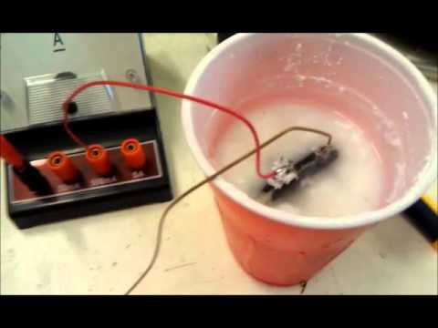

                Discharge Curve Alum Battery
                Here is a quick vid I did to see the discharge curve of the alum battery.
                Les

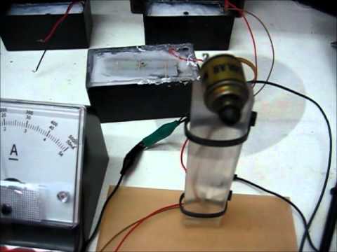

                    The fly is alive in the new hybrid Alum/Lead battery!
                    Ok Lidmotor and all:
                    This video shows the new Hybrid Alum/Lead battery running the lamp after being charged with the solar panels on the lamp. The panels are in series and
                    sums the solar cells voltage to just over 18 volts. The batteries standing voltage is 1.8 volts.So as you can see the battery is fine with that potential from the solar cells. In testing the battery it was found that it does not heat up like a traditional Lead/Acid battery. There was a question from a member about how safe the battery is at the energyscienceforum.com. Well, we had a small fly land in the battery while it was charging outside in the sun. After the battery was brought inside for testing the fly climed out and got on top of the battery. After 2 hours the fly was fine. I don't think the fly would have lasted that long with the Sulfuric Acid. So the new hybrid Alum/Lead battery is safe for flys at least
                    This battery only charged for 3hrs and will run all night on the lamp which has four (4) 10mm Super bright LEDs and 2 oscillators. This battery only has 2 plates and really fast charges as John Bedini has shown in other videos. It can be charged many ways as well.These technologies will be for sale very soon to the public for those that are not hobbiest. Thanks for watching.
                    Chuck Hupp

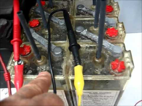

                          • NEWS FLASH!! Ben (K4zep) has done a great replicatiom---with computer graphing
                            @ John, Chuck, and All
                            Ben (k4zep on Youtube) has converted a full size Interstate marine battery and is doing computer graphed load testing on it. The procedure is very similar to what you are doing John. He is even using one of your chargers on it. So far the results validate what you have shown. The battery was on his boat and was damaged by discharging accidently until dead. He has revived it and is showing the results on Youtube.
                            The Bedini Pickle Battery - YouTube
                            Pickle Battery, Day 2, Second charge/discharge cycle. - YouTube
                            This is really good news for all of us working on this project. I have watched Ben's work for years and he tells it like it is. He doesn't pull any punches.
