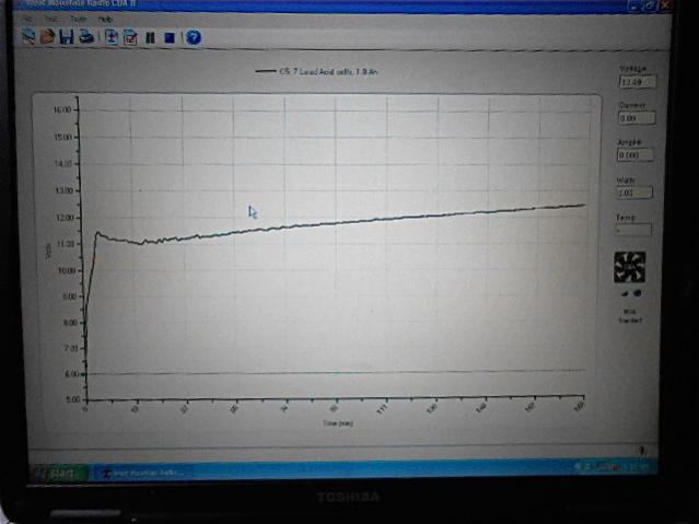

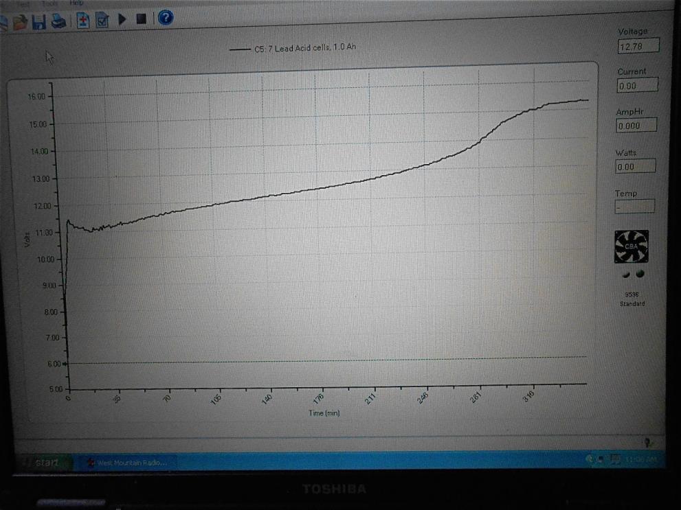

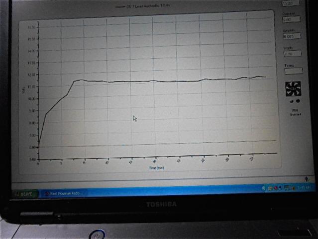

                      Just a short update to let all know how my marine battery conversion is coming along. It is a straight forward conversion. After cleaning, I simply replaced the acid with ALUM, 4 oz to the quart, 1# to the gallon in distilled water. Each charge, discharge cycle it gets better capacity wise.
                      A few things I have found out and John has already showed us. This big battery needs current in the charging process. I am finding that about 10A is a good charging currentfor this big battery. Last night when my #4 discharge was interrupted and the graph lost, I decided to then start over. I discharged the battery to 0.1VDC, I mean DEAD. Then I put in on my old 10A charger, a picture of the first 30 min or so is here. Click image for larger version

ID:	44770 The second picture is at 3hours +. Nice charge curve. The third picture is the finish charge curve. Now on discharge.
                      Interesting things noted on this charge cycle is that when totally discharged, the battery impedance is high, in the first 3-4 min, the current was only about 5 amps as the voltage built up. Around 11.4 volts, the battery kicked in, impedance went down,voltage went down to about 11.0 volts with a bit of an overshoot and then it started its basic linear slow charge curve upwards. At this point it is running about 10 amps in. It will continue this way till it is fully charged where the impedance will start to rise and voltage curve will start rapidly up to 15-16 V but I suspect not much more energy is being added at this point. When it is charged, I'll start a 5 amp (about C-10) discharge and see what we got now. All, this is so simple and it works! I'll put a video here tonight showing the results.
