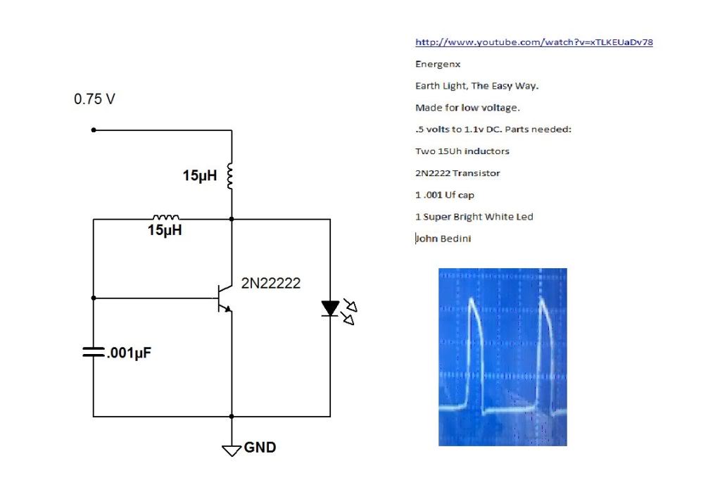

    Bedini Earthlight The Easy Way
    Bedini Earthlight The Easy wayClick image for larger version

    John Bedini

        SG Oscillator
        Hi John,
        cool forum and thanks for announcing the shift over at yahoo.
        At the conference you also showed a different oscillator which was related to the SG.
        I think it had a 40 feet bifilar coil, a unspecified resistor and some more stuff. Could you or some else post the exact circuit with the specs of the components?
        Cheers and good luck,
        Prato
        BTW: How are the pressure cells and the baked cells with manganese dioxide doing?
          Hi John & All,
          I've been following the Energetic Forum for ages & have ordered all the parts (difficult from here - had to import some from China!) for the crystal batteries. I have the DVD from Bob French too (what do you think of it?). I'm not much of a chemist, so my initial interest was in your circuit, as I've been an electronic technician since 1997 & designing & building my own circuits from age 15 (some are still working!). I think I've built & tuned all the circuits on the Energetic Forum & the one you show above works the best. I made up my own PCBs, very tiny, using all SMD components. I have a similar sort of blocking oscillator design out of an old electronics magazine that went into a three part article trying to explain everything about how it works, designing it to suit every specific application & actually building it. I built it & tabled tuning values versus power output & efficiency for my Design Project in College in 1996/7. I was wondering if you'd be interested in looking at it & commenting on it &/or modifying it? My reason for mentioning this is that it can be designed & tuned to convert, say a volt (down to 0.6V I think I got it to), up to a much higher voltage, say to run one of those big LED 12V Flood Lamps straight from a crystal battery. This could save a lot of money on chemicals or use cells in parallel instead of series to get much higher currents. What do people think?

            @Prato
            Here is a link to Bedini's patent on his oscillator, it should contain parts values. Patent US7990110 - Circuits and related methods for charging a battery - Google Patents

                  I was reading through the posts on the old energetic forum & noticed John B posted words to the effect of "the best oscillator is a cable oscillator... 0.9V gives 6V out". I haven't been able to find a mention of it since. Is this oscillator still under test? Wouldn't this work well with the crystal batteries? I'd be very interested in building it & posting my test results here.
                  I was also interested in what has & has not been tried & tested with the above patented circuit, "Bedini Earth Light The Easy Way". Can it not also be done with a PNP transistor? Have Germanium transistors been tried & wouldn't that mean an even lower input voltage can be used? I can still buy many different types new here, quite cheap. Do you recall the experiments others did with the above circuit & how the placement & proximity of the inductors was critical to achieve maximum light output? I think maximum light output occurred when the inductors were placed one atop the other. Therefore, would not a single centre-tapped inductor (quite cheap here), work best? I looked up the Digikey reference given early on & found that these inductors had a Q of around 50, which is quite high. Is this a critical factor? Are there any other considerations we should watch for, like minimizing DC resistance of the inductors & frequency response?
                  I'm interested in more discussion on the circuit, as I feel it has been largely & unfairly ignored. People just seemed to go crazy with Joule Thief circuits & the like when, in my opinion, the above circuit works best for the money & simplicity & output.

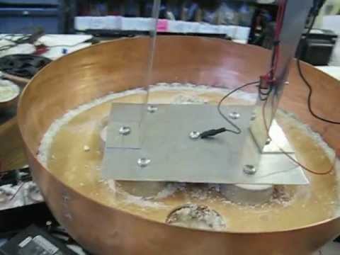

                    New Crystal Batteries20 John Bedini and Chuck Hupp
                    In This video I'm showing some new thing Chuck and I have been working on. First I show the Crystal Batteries that were used during the convention and what they will run after being dried out. The oscillators are based on US patent US 7,990,110 this also covers the Cable oscillator. The conversion process for a lead battery Chuck and I are not ready to disclose the mixture just yet. This is all discussed on Energysciencefourm.

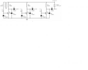

                              Originally posted by mrbr00k5 View Post
                              @Prato
                              Hi John B,
                              I believe this patent is what you would call your Cable Oscillator? Amazing work! I've been trying to get my head around the latest embodiment as you have shown in your video as well. I'm not sure where in this forum is the best place to discuss this, but I hope you find it. If I may draw your attention to figure 5, which appears to be a tripple cascade of figure three? I'd like you to confirm this diagram is 100% correct to build from. My problem is with two juctions that appear to join the trigger coil right across two out of three of the other coils. This looks nothing like a logical extension or cascade of the circuit in figure 3 & I cannot understand how it would work like this. I'm thinking this sort of thing is what happens when drawing a line through junctions that aren't meant to connect on most circuit design software programs around today, that it automatically joins them up for you. Removing those two junctions joining the top of each base resistor to the collector of the same transistor (except the last one) would make perfect sense, in line with all of your other brilliant designs I have seen thus far. I have re-drawn it in the image below without any wires crossing over each other, using on-page connectors instead. I'd like you to look into this & verify that the top of that trigger coil should not be joined to the collectors of those two transistors in figure 5, but only to the base resistors of all three transistors.
                              Many Thanks.
