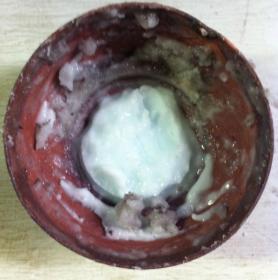

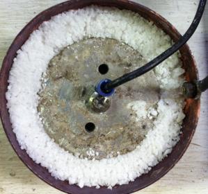

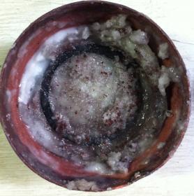

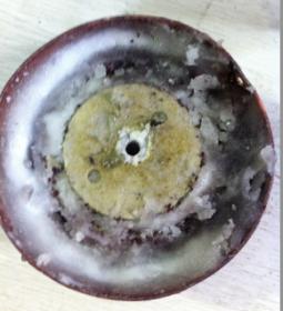

    Hi Mr. Bedini
    Are you using a new mix for your crystal light that you sell?
    If you are what is it?
    I have 2 lights, the mix went bad in one of them.
    I put new alum in it and it works great. (see other post for the rest of the rebuild)
    Thank You
    Geoffrey sr miller

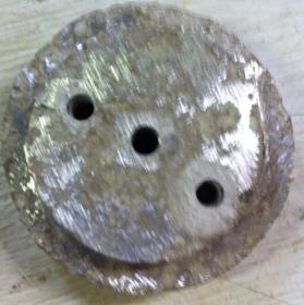

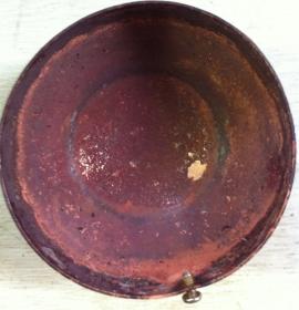

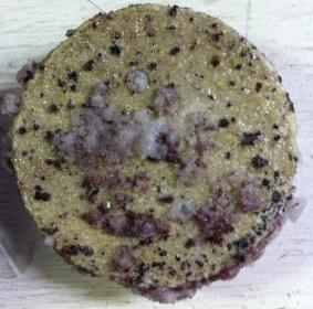

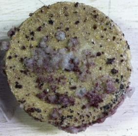

    • #77
      Hi Mr. Bedini
      Post no. 2 Rebuild
      Thank You
      Geoffrey sr miller

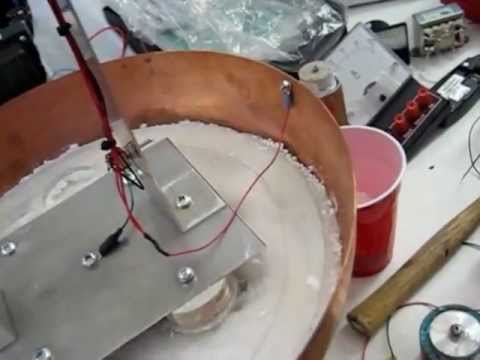

      • #78
        In this video I show exactly how I do the crystal cells using old Gel Cells I have developed a way to make an instant crystal and do not need to wait for them to grow from a seed Crystal.
        John Bedini

          Geoffery sr miller, Chuck Hupp here...
          I have not seen that before. what did you put in there? We have built hundreds of those cells and added tap water and or distilled water and never seen anything like that before. I have not seen anyone else post anything like it either.

          • #80
            MR. Hupp & Mr. Bedini
            I put Only Pure Distilled H2o @14 Drops in the light about every 3 days or so.
            This is why I ask ? I did, the other light works great.
            Geoffrey

              • #82
                Originally posted by geoffrey sr miller View Post
                Hi Mr. Bedini
                Thank You
                Geoffrey sr miller
                [ATTACH=CONFIG]640[/ATTACH][ATTACH=CONFIG]641[/ATTACH][ATTACH=CONFIG]642[/ATTACH][ATTACH=CONFIG]643[/ATTACH][ATTACH=CONFIG]644[/ATTACH]
                Hi geoffery sr miller and all. Here is a video of the cell you have and we make all the production cells the same. I have tried alot of different things with the Alum Cu Mg H2O cell and not seen that type of reaction. It almost looks like some kind of chemical reaction as it looks as though it covered the whole cell and carried the black copper up through the mix. Also it looks like when you took the cell appart it had a very "white and smooth creamy looking substance" on part of the Cu bowl (Picture #3). Thats not typical of Alum as it is very course.
                At everyone: Has anyone seen anything like this?

                    [QUOTE=Chuck Hupp;1495]Hi geoffery sr miller and all. Here is a video of the cell you have and we make all the production cells the same. I have tried alot of different things with the Alum Cu Mg H2O cell and not seen that type of reaction. It almost looks like some kind of chemical reaction as it looks as though it covered the whole cell and carried the black copper up through the mix. Also it looks like when you took the cell appart it had a very "white and smooth creamy looking substance" on part of the Cu bowl (Picture #3). Thats not typical of Alum as it is very course.

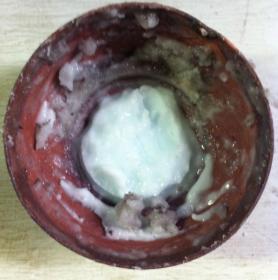

                    Hi Mr. Hupp & Mr. Bedini
                    The "white and smooth creamy looking substance" Is what the cell came with.
                    The other crystal light has the rough alum and works fine.
                    This is why I ask the ? when the light stop working.
                    I have used Aulm for years
                    I will shoot a video to show the blue/white alum.
                    you can call me at 215-900-1167 if you want to talk about it.
                    I hope you call, here are pics. of the gooy stuff.
                    Thanks and have a great night.

                        Geoffery,
                        As chuck answered we have never seen anything like that, Chuck made a video for you on the cells here. In that video I said a pinch of cream of tartar and I have said that here. Unless we got a bad piece of Magnesium I don’t know how to answer you what caused that, I have never seen that. That looks almost like some other chemical reaction but that is not what Alum does to the metal. Did you try to reverse charge the cell? Only trying to help you to find out what went wrong.
                        Hi Mr. Bedini
                        No reverse charge of crystal light, why mess with something that WORKS Well.
                        1. open shipping box.
                        2. put distilled H2o on alum.
                        3. light goes on.
                        4. Drink a good beer and look at the light work all night long or until the beer runs out !!
                        After about 2mo. light went out the other day.
                        I then rebuilt it, and keep all of the old alum.
                        see pic.
                        Here is my phone# 215-900-1167
                        let's talk about it.
                        Thanks have a nice night.
                        GeoffreyClick image for larger version
Name:	Screen Shot 2012-09-11 at 2.52.47 PM.jpg

                                Hi John
                                Here is a video of the bad alum from crystal light no. 2
                                It was fun to talk, I PM you with my address.
                                Have Fun.
                                Geoffrey
