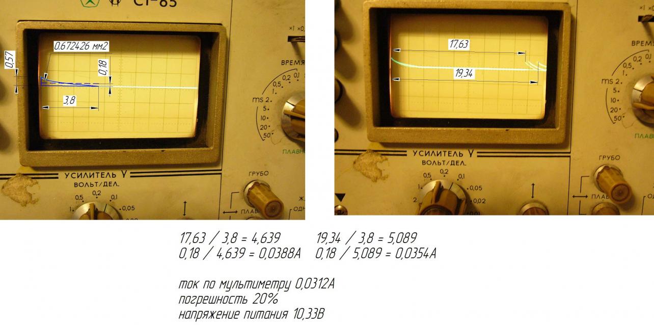

                      Thank you very much, Tom. I keep trying to find my mistake. On this, I constantly changing device settings, searching for the right answer. After reading your response, I thought it might the reason in diameter wire or strength of the magnets. In the coil diameter of the wire, I used #21 and #20 (approximately 330 feet, each). The force of the magnets I showed this video -> Finding the correct gap and height coil. - YouTube But no one commented.
                      I measure the the amperage on the oscilloscope. For this, I connect 1 ohm resistor in series with the secondary battery. And the recorded waveform voltage to the resistor. In this 1Volt must equal 1 Amp. Is that correct? I then, with the help of design software, creating a large-scale chart, and calculate the area under it. Then I calculate the average current pulse. Then, I divide it by the ratio of the pulse duration to the time between pulses. Get current flowing into the secondary battery. Here is a picture illustrating it Click image for larger version
                      I noticed that when I drop the voltage on SSG, the opening of the transistor (the shelves in the "h" wave) is reduced. Consequently, the current will decrease. So, I switched to a lower power.
                      If this does not work, I plan to experiment with the gap between the core and the magnets. The problem is that it takes a very long time. But I hope that when or whether I will find the cause.

                      • #86
                        Constantin,
                        1- your wire length is too long bring it down to 130 feet, bifilar. that is the specification for wire that size.
                        2- the 1 ohm resistor test is where you REPLACE the charging battery with a 1 ohm resistor. if the resistor heats up you are using too much cuurrent.
                        3- do NOT measure the current on the charge side, only worry about what is coming out of the primary.
                        4- from the video, the washer is magnetized that is why it is hanging on to the transformet laminations. can you get any welding rod?
                        5- tune the machine with THE PRIMARY CURRENT. use your ammeter setting on your multimeter.
