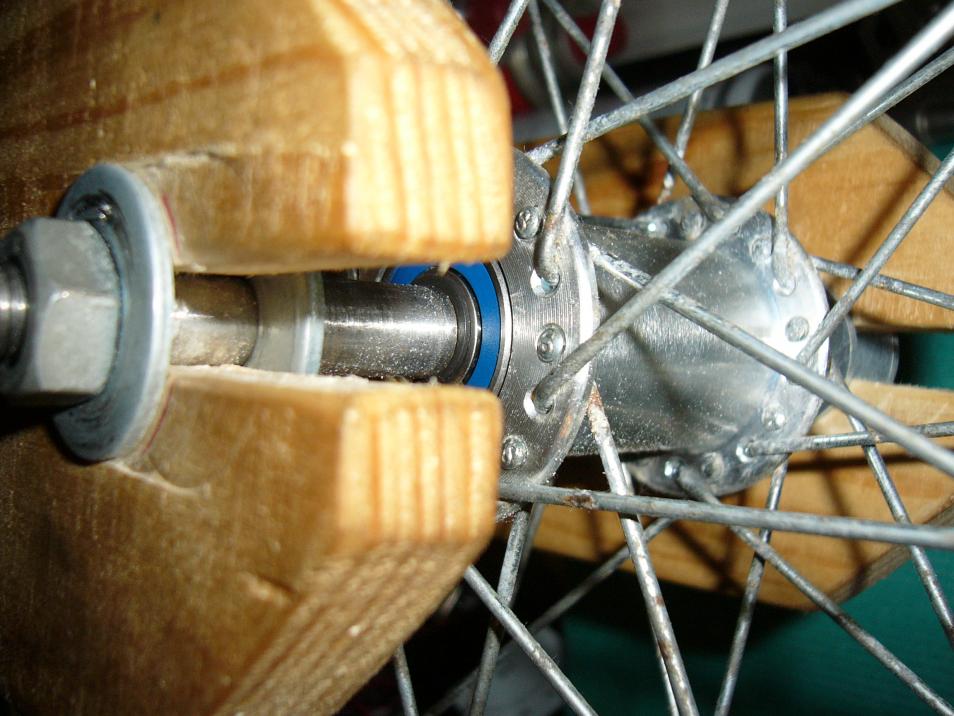

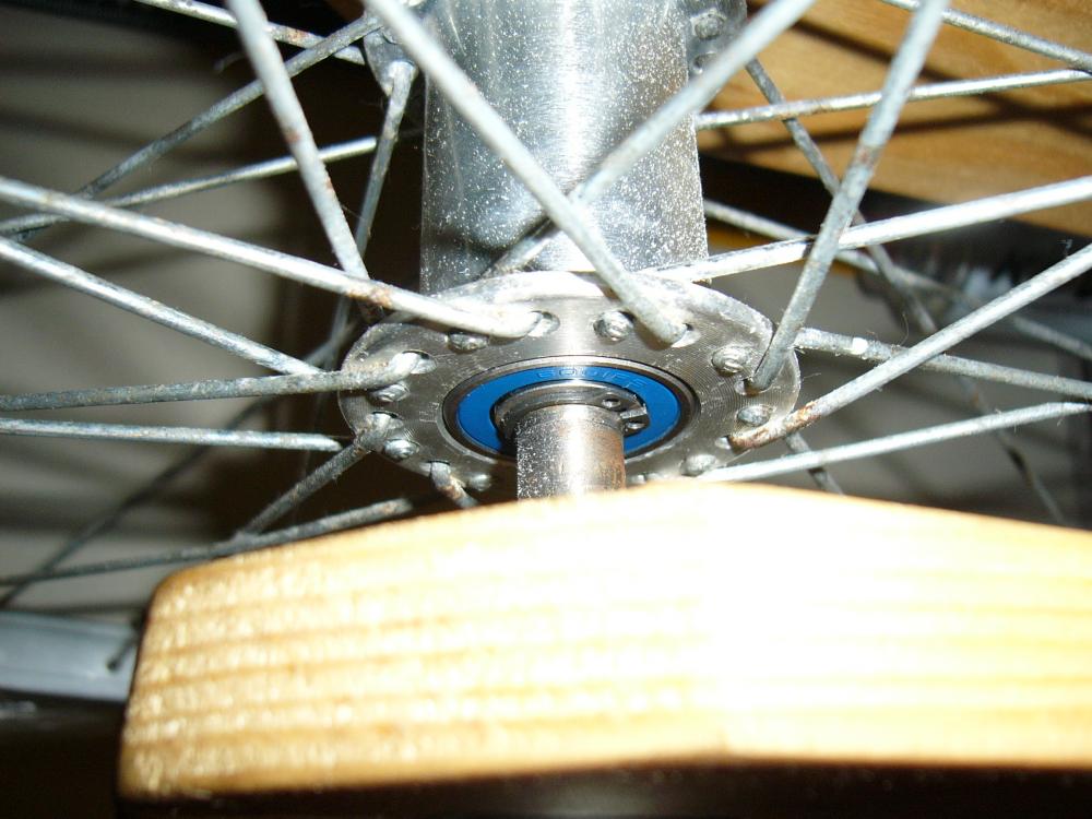

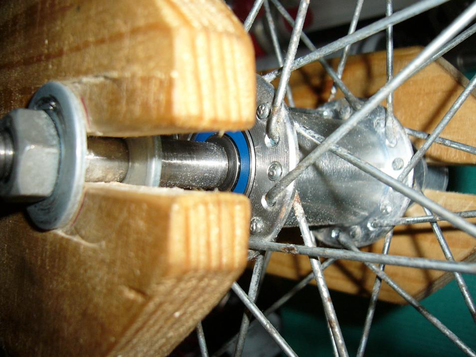

                    I used the all-new 6001 bearings for the axle. Also, I cleansed them from grease and smeared with machine oil. Free rotation of the wheel a little more than 5 minutes. The manual says that this should be sufficient. With an installed the coil, the rotation of the wheel is 4 minutes.
ID:	44964Click image for larger version
                    Konstantin.

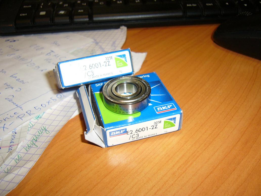

                      I recently bought such bearings. Click image for larger version
ID:	44966 I can install them, but I'm not sure that it will give the best result.
                      Konstantin.
