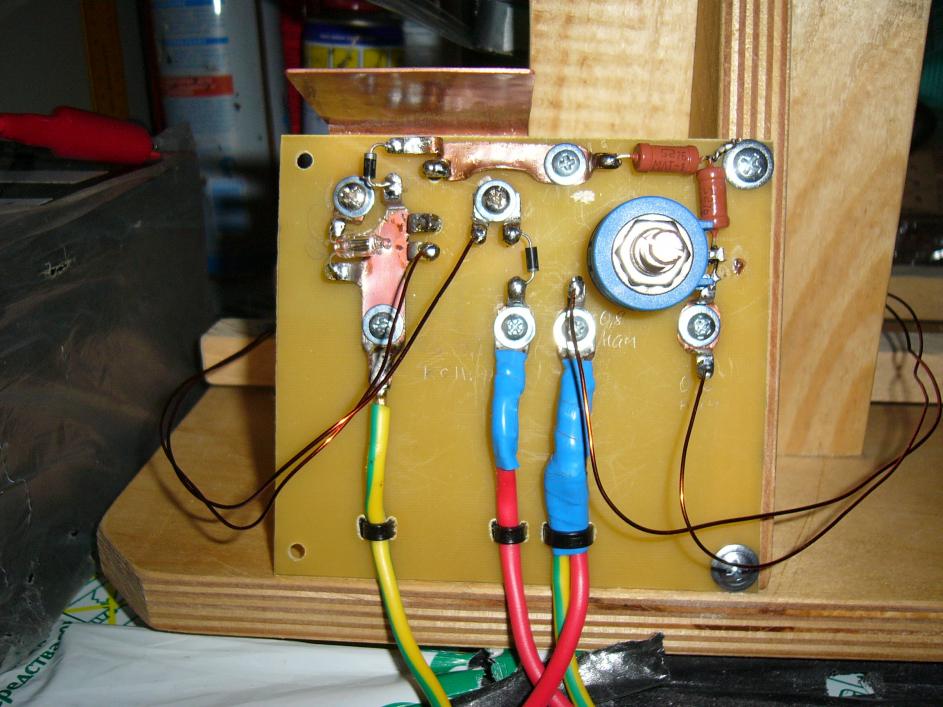

My first board:

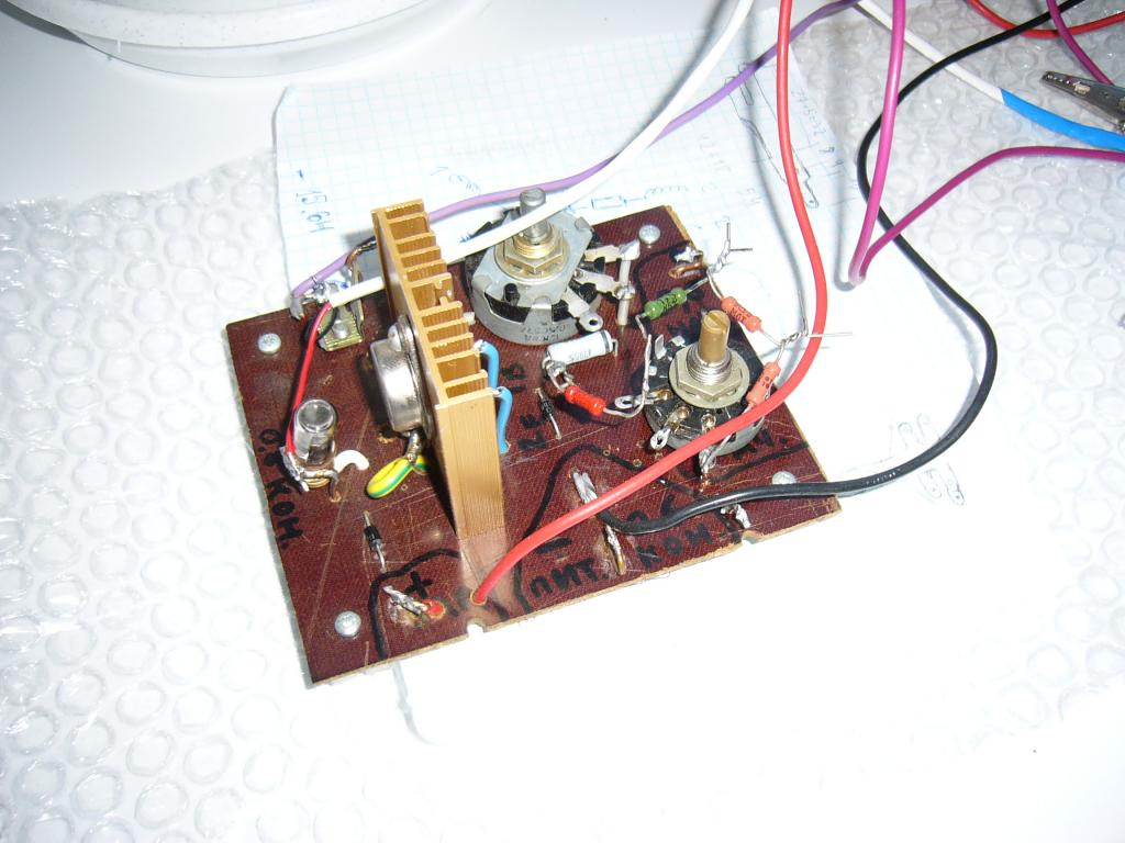

Now I built another one:

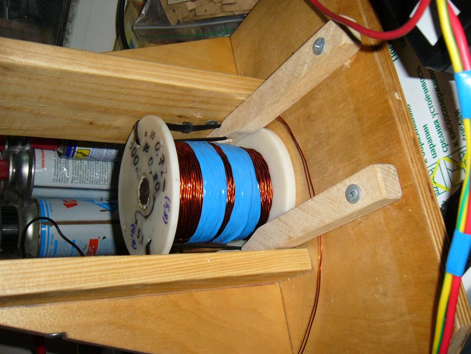

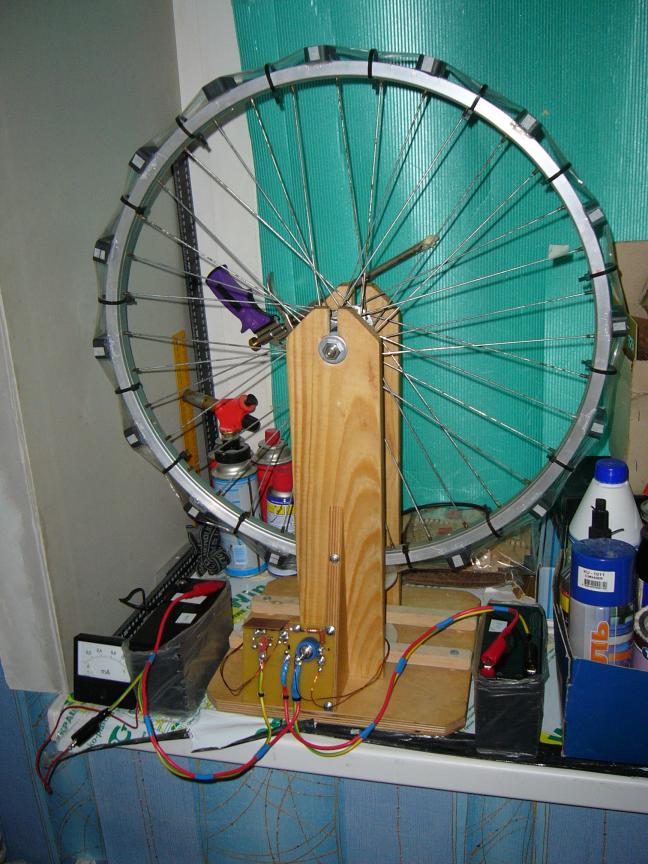

Device overview:

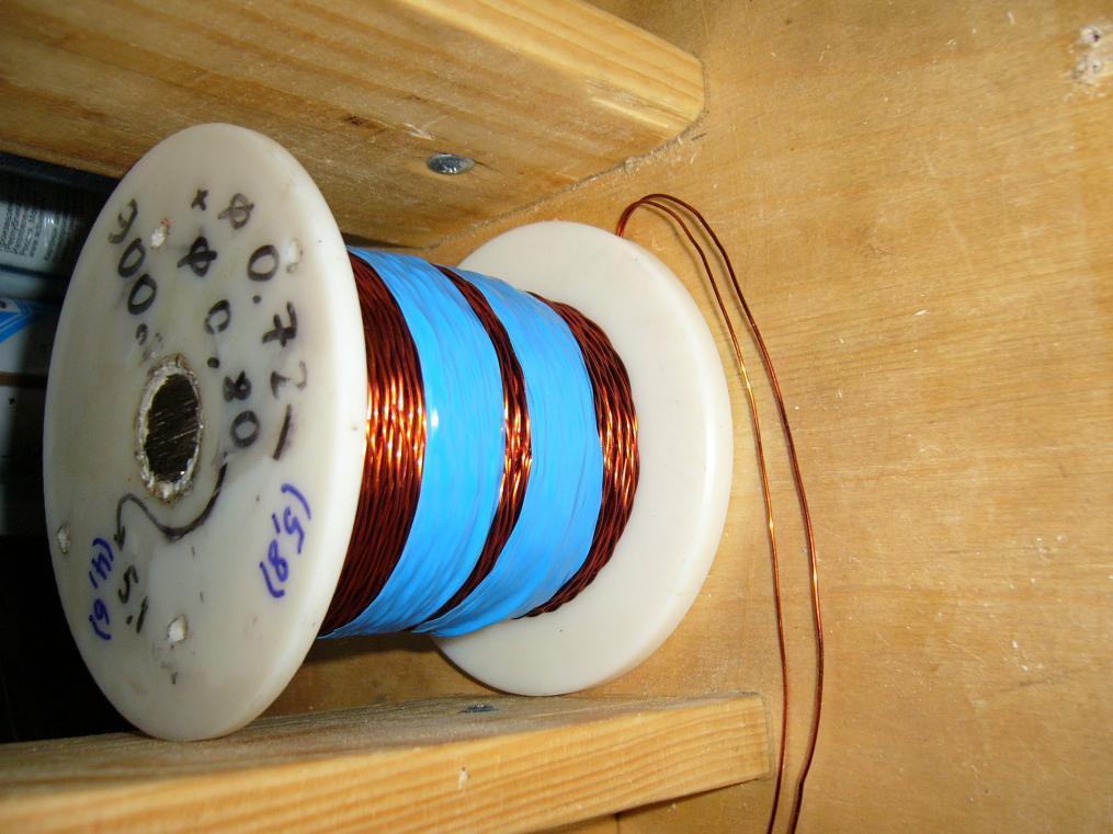

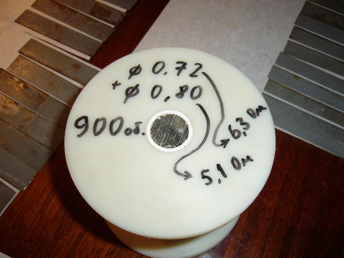

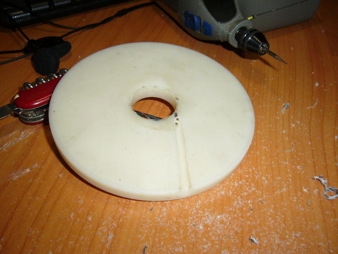

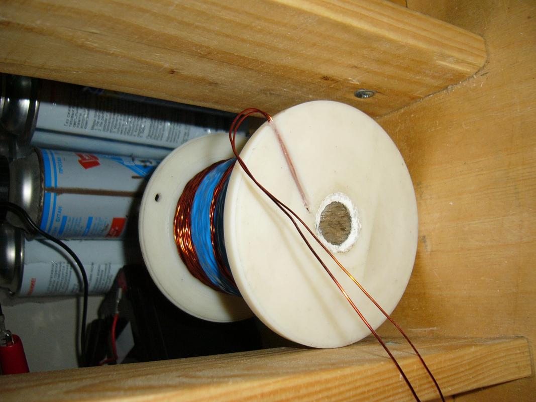

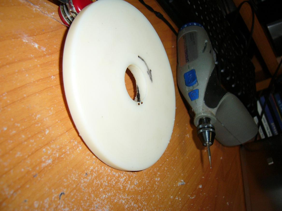

For the manufacture of coil, I used a wire 21AWG (0,72 mm) and 20AWG (0.8 mm), of 900 turns each. The core of the transformer plates.
I did not find the recommended electrodes in our country. I could not find the right bulb for the resistance on the basis of the transistor. So I did without her. Maximum speed with minimum amps I have received during 1694 ohms. Max 162 rpm at input 0.075 amps, 0.030 amps output. But these parameters change during charging. At the start of charging parameters such 142 rpm, input 0.085 amps, output 0.040 amps. When raising the voltage on a rechargeable battery to about 14.5 volts, the parameters are changed to 162 rpm at input 0.075 amps, 0.030 amps output. Is it ok? And what settings do I use the calculator SSG at the table?
