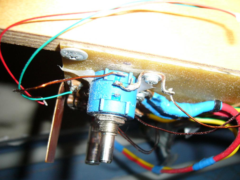

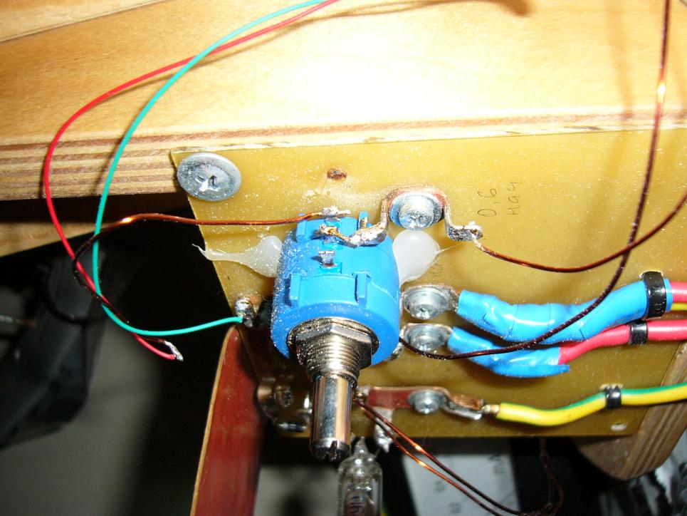

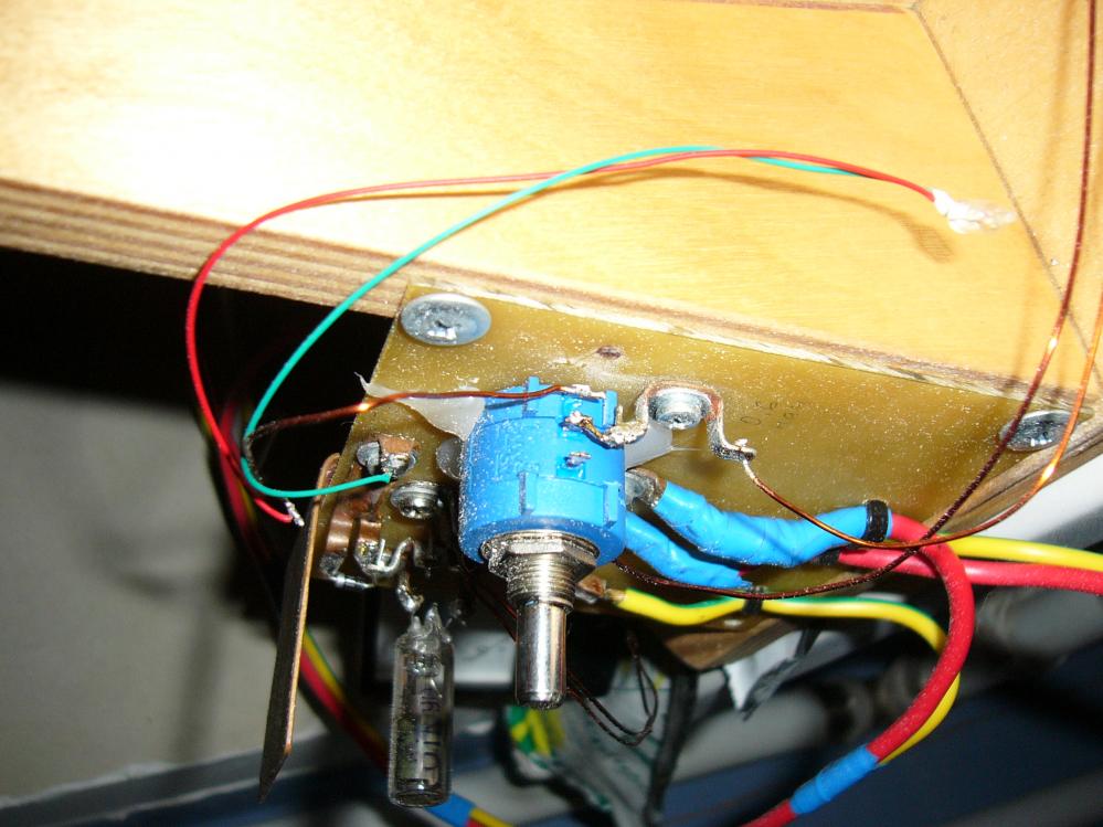

                      • #41
                        I took a few pictures that you can see better. Potentiometer is not shorted.
ID:	44933Click image for larger version
ID:	44934Click image for larger version
                        Konstantin.
                        • #42
                          until you can adjust your wheel speed with your potentiometer your circuit is not working correctly.
                          • #43
                            Try to replace your potentiometer mate...
                            Just in case,
                            Cheers
                            Alfin
                            • #44
                              With potentiometer is all right, it's new for 1k ohm, 2W. The resistance can be set to an accuracy + -1 ohm. Magnitude values ​​are very stable.
                              Konstantin.
