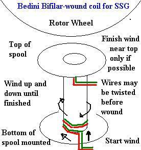

    there are lots of errors including coil winding, it is supposed to be wound clockwise from the core it shows it counter clockwise. miki is not part of this group and has been banned by John B years ago. he was booted from the yahoo groups also.
    • #92
      Damn. I'm sorry.
      I also have the manual (I found it later):Bedini Monopole 3 Group Experiment V1.01.pdf This contains correct information?
      I wound a coil as shown in the figure:Click image for larger version
ID:	45076 Is that correct?
      Konstantin.
      • #93
        Constantin, yes that diagram is correct.

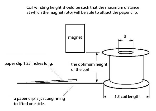

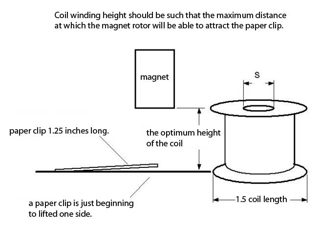

                    • Please tell me whether you know this picture?
                      Can I use it to find the correct height of the coil?
                      Konstantin.
                      • where did you fing this diagram?
                        • I do not remember where I found it. It was in Russian, I translated it.
                          It is not right?
                          Konstantin.
                          • I will measure a spool when I get home or someone here can chime in.
                            • Thank you, Tom. I'll be waiting for your reply.
                              Konstantin.
                              • the spool is manufactured by pittsfield it is 3 1/8 inch tall 3 1/2 inch diameter with a 3/4 inch core diameter.
