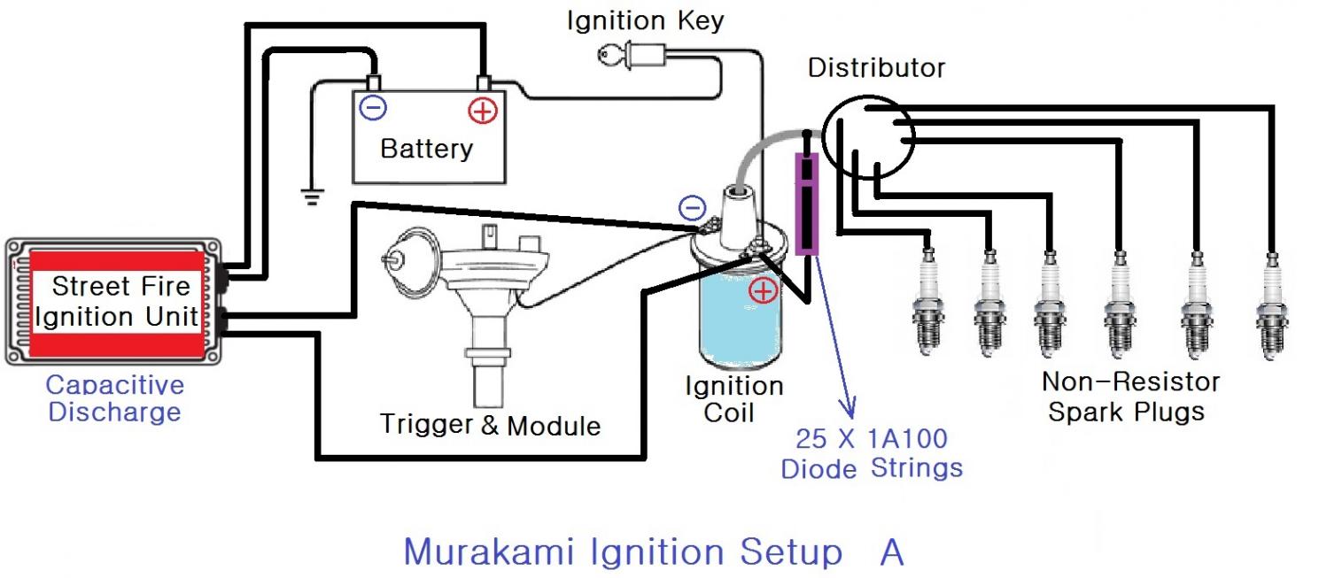

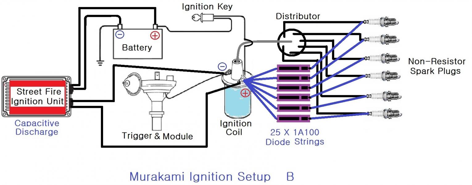

              • Which ways is correct hook up method ? A or B ?
                Hello !
                This post for @ Aaron and Subadude.
                I read your book "The Ignition Secrets".
                After I read your book, I try to install the plasma setup to my car.
                But I have a question regarding the diode string hook up method.
                I upload two kind hook up diagram that A and B.
                A has only one diode string for plasma ignition and
                B is hook up the diode string each spark plugs.
                Any opinion by your real world experience ?
                Please help me right method.
                Thank you.
Name:	Murakami Ignition A.jpg
ID:	45780Click image for larger version
Name:	Murakami Ignition B.jpg

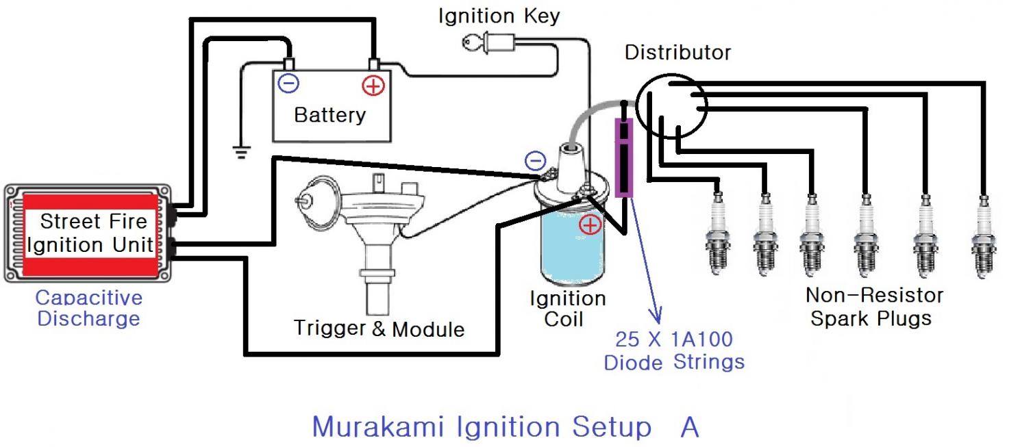

                • Originally posted by luishan View Post
                  Hello !
                  Thank you.
                  [ATTACH=CONFIG]2563[/ATTACH][ATTACH=CONFIG]2564[/ATTACH]
                  Hi Luishan,
                  B is the way to do it. With A, you can get the plasma in the distributor and you don't want that. With B, only the normal HV is in the distributor cap and the LV cap discharge over the gap will happen at the plug.
