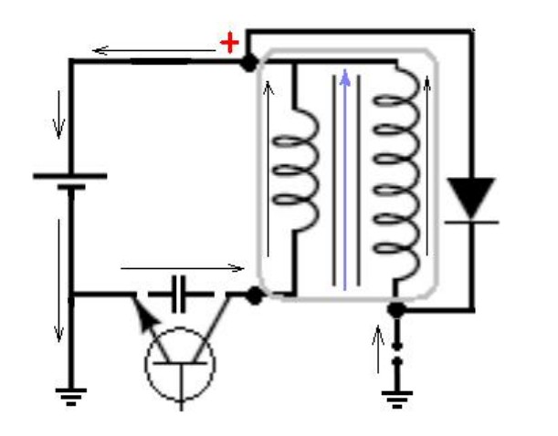

                            • @ Aaron:
                              I did get myself a Velleman K2543 Transistor Ignition kit that makes the condenser unneeded, only indirectly uses the points as low volt trigger, and the TDI itself handles switching coil current supply on and off.
                              BUT... although during firing the TDI will disconnect (isolate) the coil "-" from battery "-" (ground), the coil's "+" still is connected to battery "+".
                              So I managed to upload a diagram - its based on your Water Spark Plug diagram:
                              (1) Coil Secondary and diode string flapped over 180 deg to show relation to Coil Core.
                              (2) I show TDI Transistor in stead of a switch, but on the Minus Side, since that's the TDI's wiring orientation.
                              (3) The TDI uses a 630 V 0.22 uf cap to protect the Transistor, so its not part of powering the Coil.
                              (4) It shows electron flow direction from battery "-" to "+" (not standard current flow notation) which gives the Coil Firing Direction too.
                              While 12 V is running through the Coil Primary, it drops the voltage against the current flow oposing the change in current through it.
                              Then when the Transistor is switched off, the Coil drops about 250 V voltage IN THE DIRECTION of the current flow, trying to maintain the level of current flow through it.
                              But it also then shows that the Coil Secondary is fired towards the Battery "+".
                              IS MY DIAGRAM WRONG HERE?
