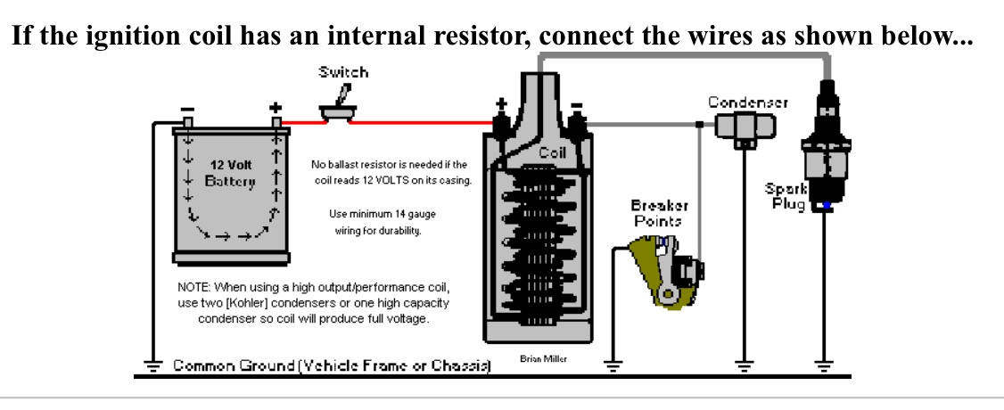

                        • Off subject some but in anyone’s opinion there’s a company by the name Nology that makes spark plug wires the they claim can increase spark output from a capitor in the wire. From my understanding it’s a wire mesh sleeve that goes over the inner wire that causes resistance and ups the spark. They claim in can increase spark by 300%. Could this work, I know it’s a far cry from a plasma ignition but just asking. Thanks
                            At $299 a set for my 8 cylinder I don't think it can work for me.
                            At hvstuff.com I can get; 30kV 330pF High Voltage Ceramic Disc Capacitor $0.79 each
                            But if money is no object then it looks like an easy way to go, maybe.
                            Likely need to experiment.
                            Richard Gieser
                              Those are spark plug cables with capacitance built into them. Basically, just an extravagant peaking capacitor. I don't see why they wouldn't work with the plasma.

                                Problem is I tried the ceramic capacitors and they wouldn’t work with for my application, I’m trying to use it on a points breaker ignition system and not something a magneto or cdi box. Click image for larger version
