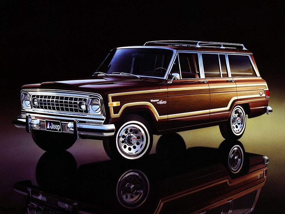

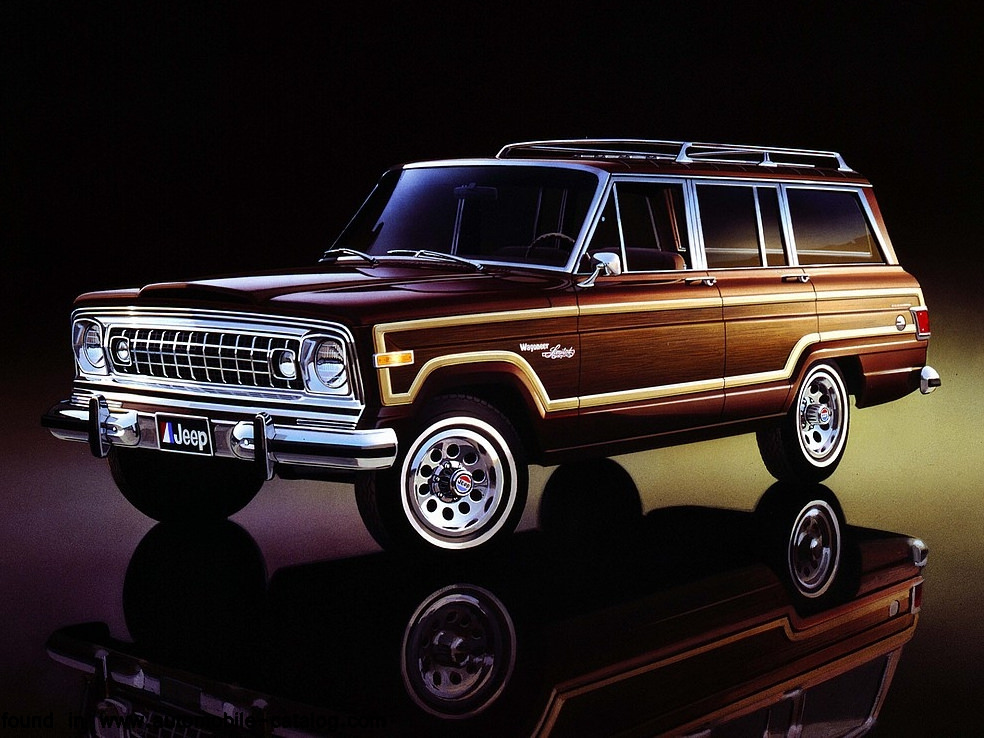

                      • Hello Folks,
                        My car is a Jeep Wagoneer Limited 1979 AMC V8 5.9L
                        Today, i played with the ignition timing in combination with the plasma ignition.
                        What is strange is that the motor likes as much advance as possible.
                        When i push it to TDC i get backfires. Maybe because its an old engine there is some lack on the timing chain.
                        I let it stay at maximum advance, and it has a lot more power and she's very responsive. Next is leaning out, i ordered the jets.

                          Hello Folks,
