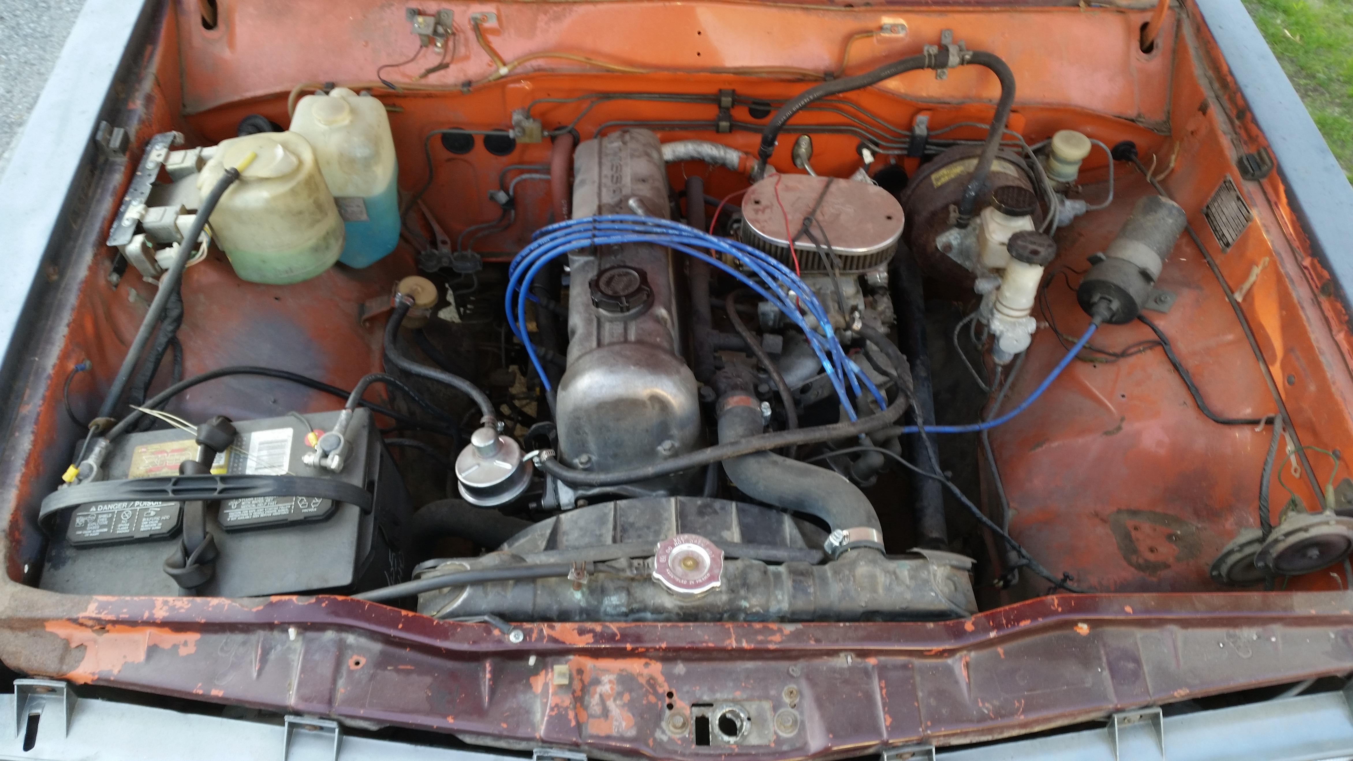

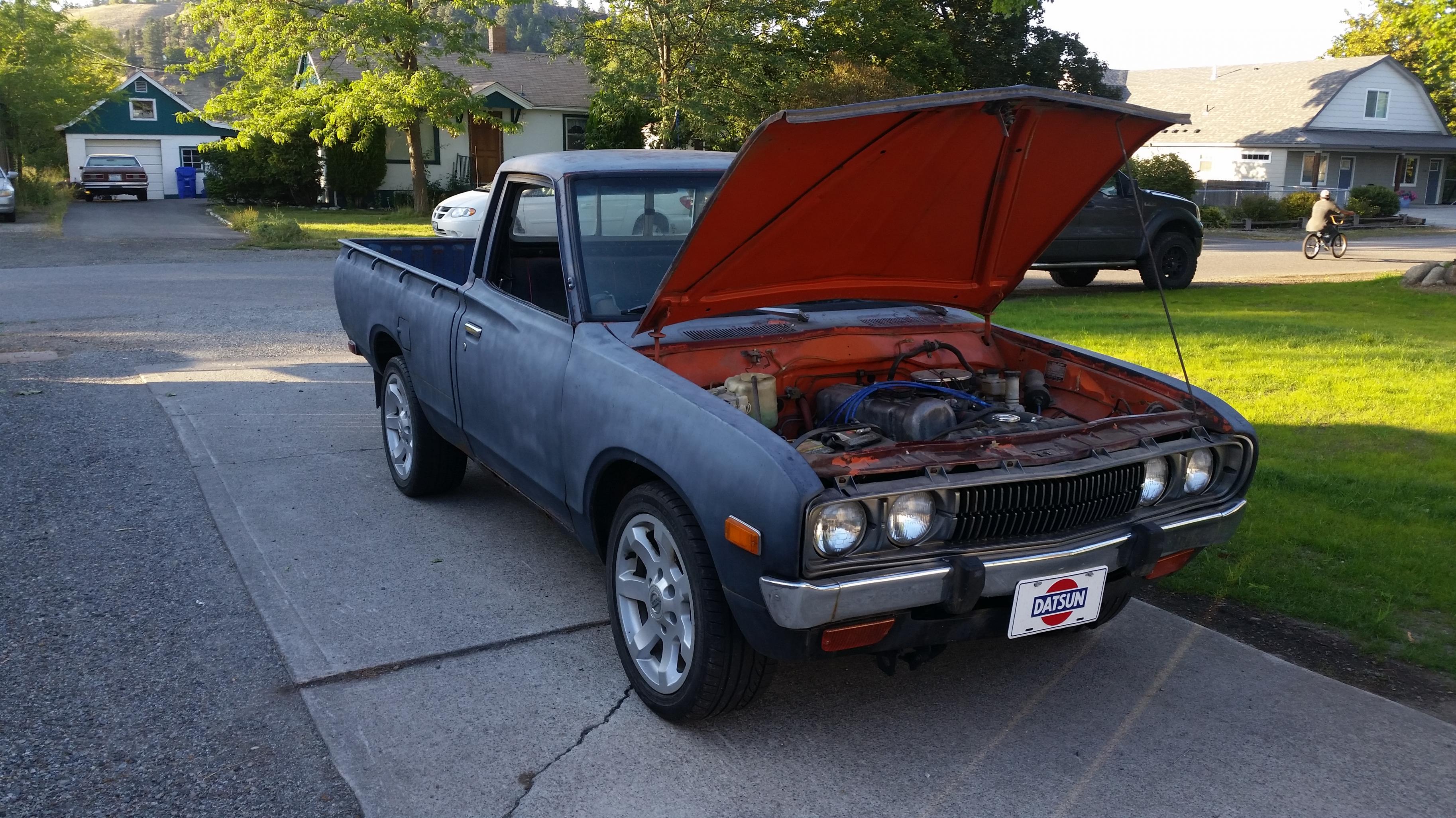

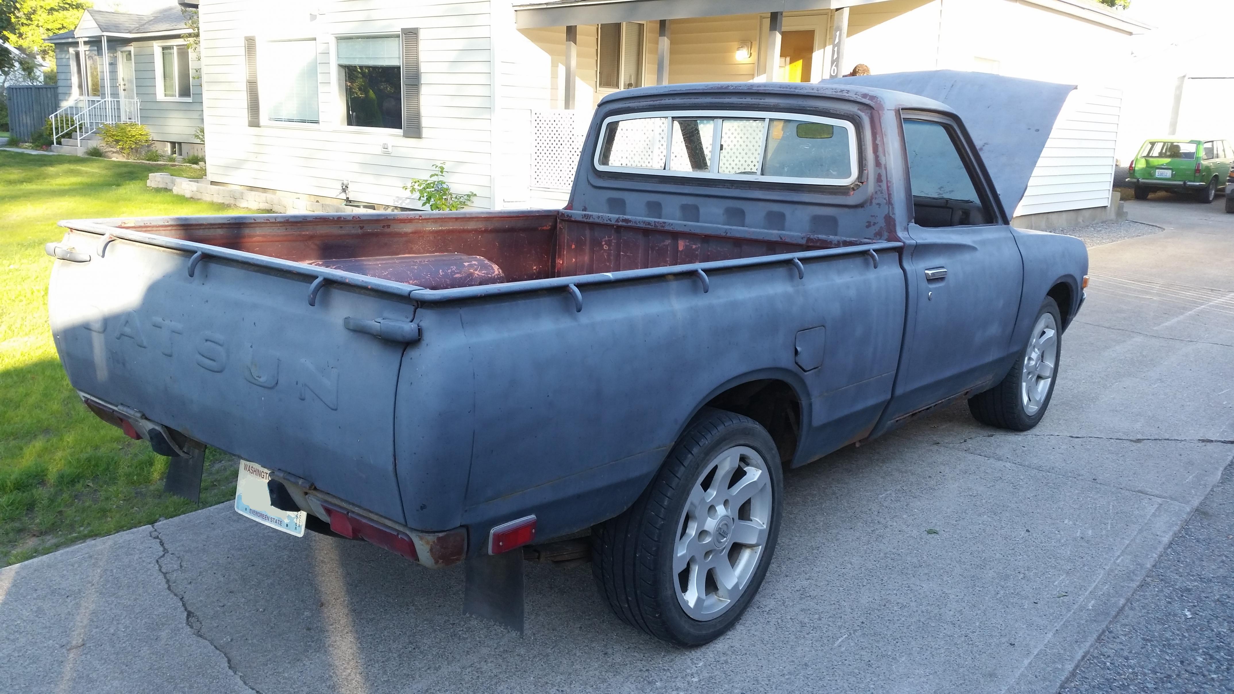

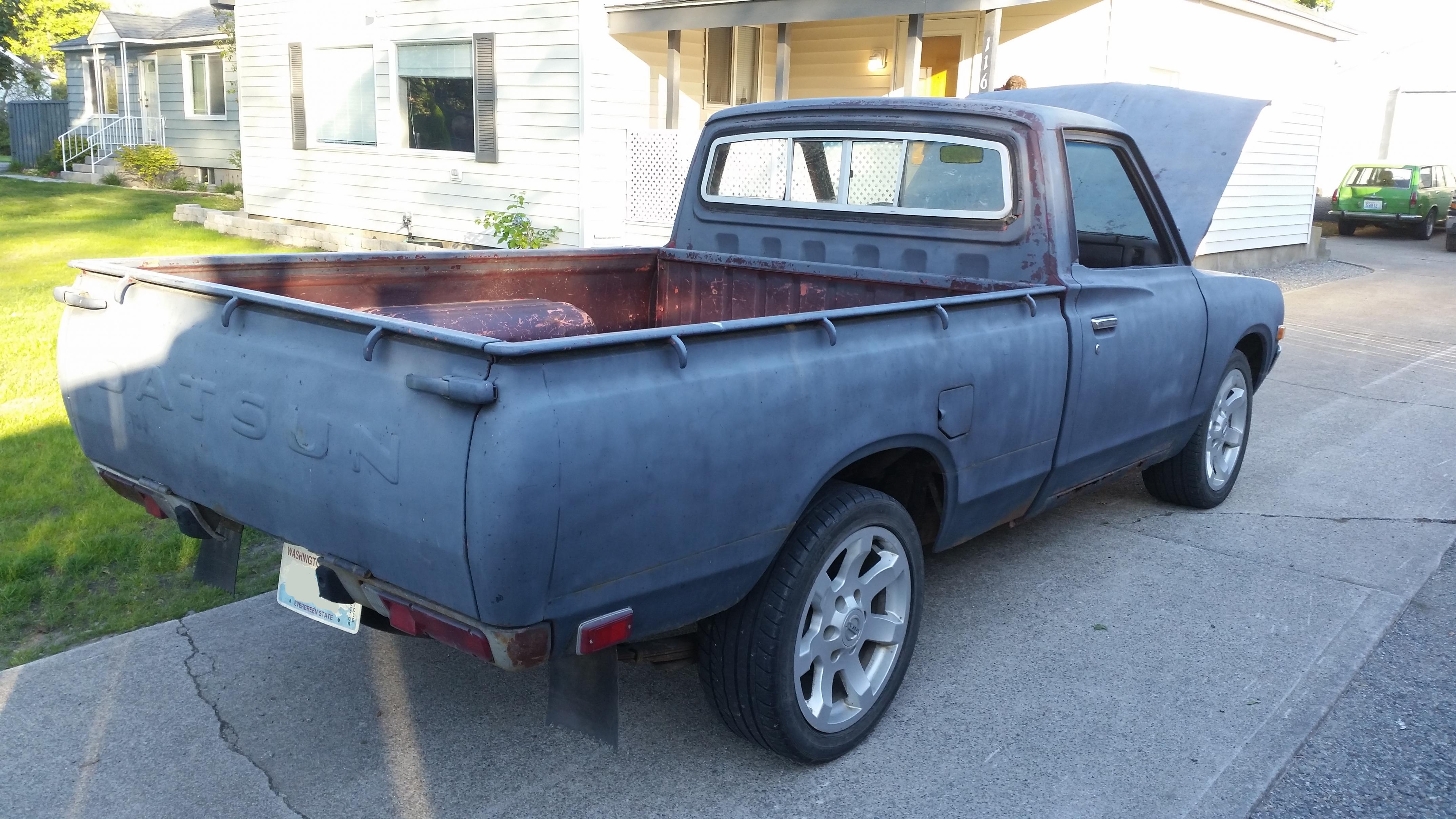

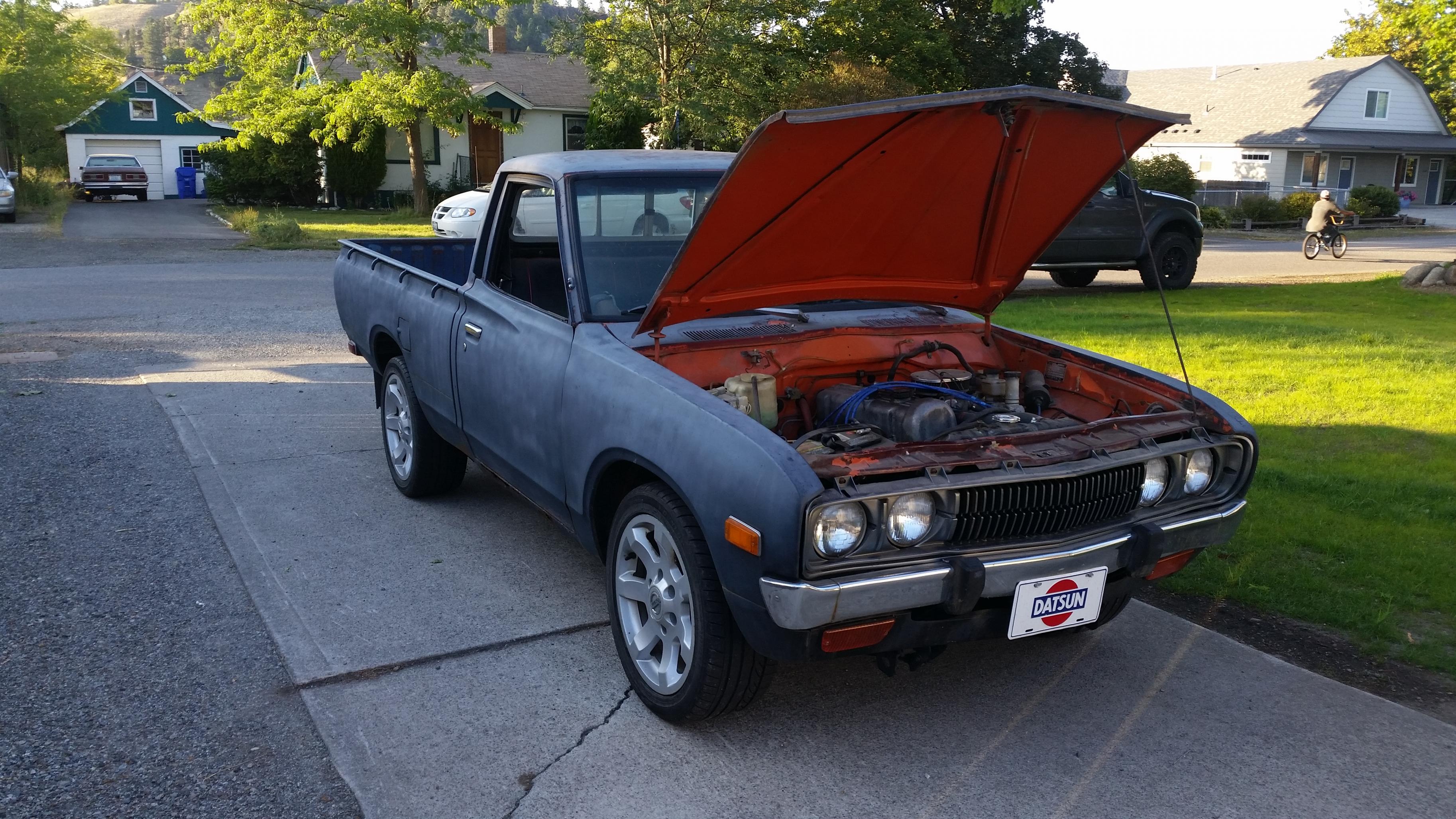

                      • Thanks Scorch, here's my own update...
                        Just got this 1977 Datsun 620 pickup. Has about 100 miles on a rebuilt engine - L20B 4 cylinder with a Weber carb.
                        So far only put in non-resistor plugs and a Pertronix Flame Thrower coil with 0.3 ohms on the primary.
                        I'm waiting for my Granatelli non-resistor cables - plasma discharge will bypass the cables and go to the top of the plugs but I want every bit of spark I'm paying for.
                        Just got a MSD factory refurbished unit that I'll put on soon - still have to put on a new emergency brake cable system first before I do much else.
                        Been wanting an old engine like this to experiment on because I'm tired of the electronics - can't get any simpler than this.
                        Will be adding an HHO cell and other goodies as time permits. Will post whatever results when I have them good or bad.

                        • Hey Aaron.
                          Yay! An old school drive train where you can actually see the engine under the hood.
                          And I am reminded of the world's fastest electric, street legal car which is also a Datsun.
                          This is a great acquisition with manual transmission and a perfect test bed for these experiments.
                          And after you get it running on water; you can always convert to electric to get rid of all that mechanical complication and run it on source field energy.
                          Kindest regards;

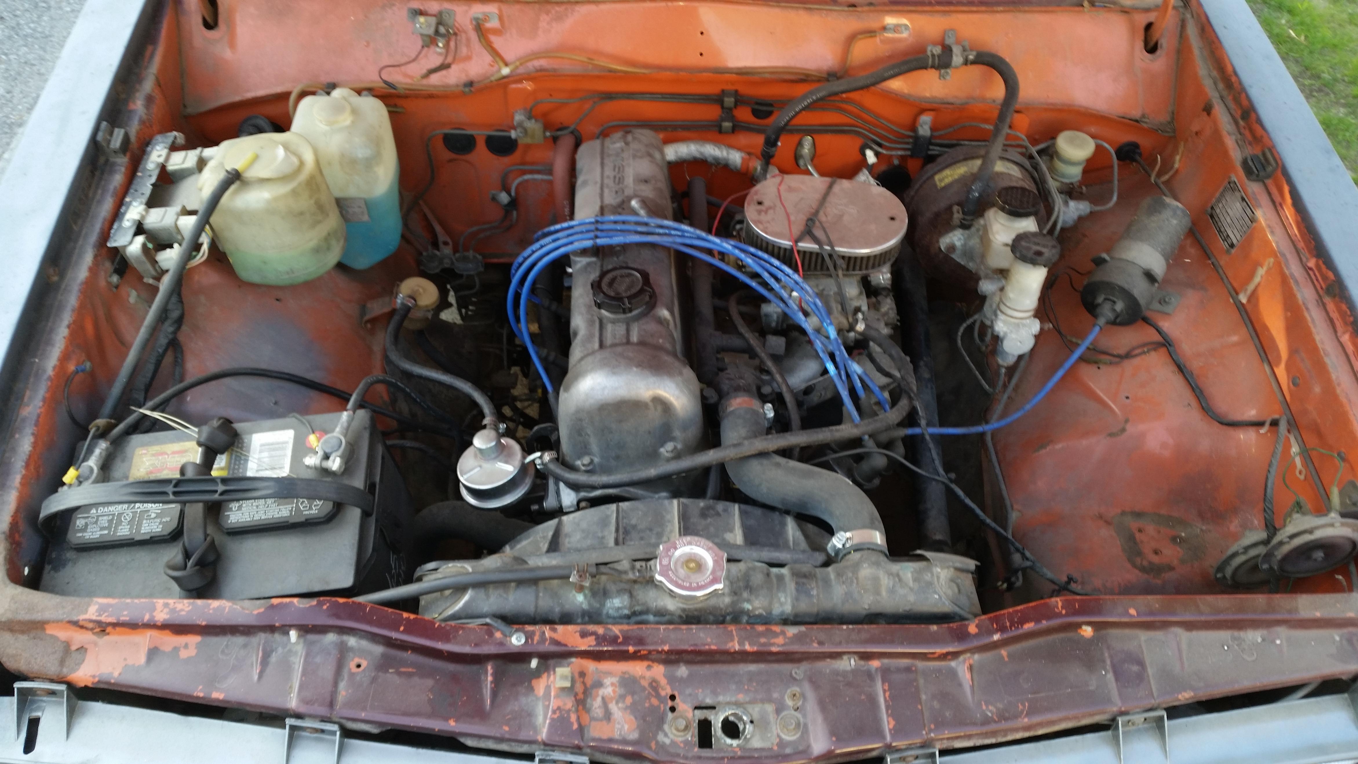

                          Just got this 1977 Datsun 620 pickup. Has about 100 miles on a rebuilt engine - L20B 4 cylinder with a Weber carb. . .
                          . . . Been wanting an old engine like this to experiment on because I'm tired of the electronics - can't get any simpler than this.

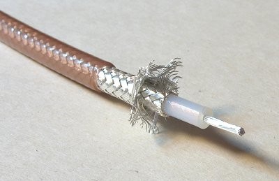

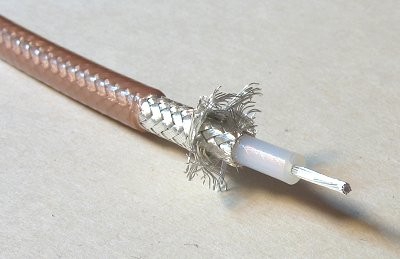

                              • Hello Aaron,
                                I think the K2543 module is for points only.
                                The Granatelli wires are very expensive. In this aircraft document on page 6 they use regular RG400 Coax wire http://www.lightspeedengineering.com...l_20130317.pdf The RG400 wire is used much in aircraft ignition wires. In the document they also use CDI plasma ignition.
