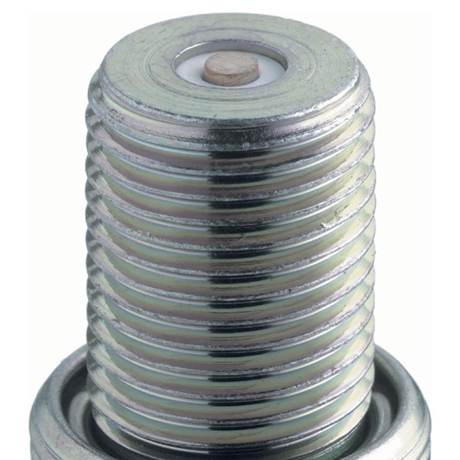

    1)Surface discharge spark plug.
        [ATTACH=CONFIG]5400[/ATTACH]

        NGK BUE, surface discharge, cold start.
        And here is my tribute to "groundless", (surface discharge), spark plug:
        http://www.4troxoi.gr/phpBB3/viewtopic.php?f=6&t=58492
