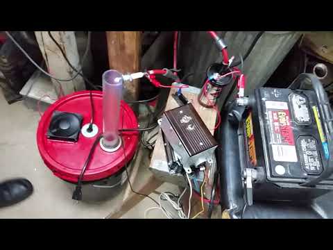

      I just finished a replication of Aaron's 555 timer circuit driving a street-fire MSD module thru a MSD Blaster coil. Here's a video of it installed over a fogger unit while I was demonstrating it to my son and grandson (and exposing them to dangerous radiation - LOL ).
      The video starts out with a surface gap plug installed without fog and then with fog. Next comes a regular plug with conventional gap. It runs both with and without fog added. Then a little propane gas is added (both with the fog and without the fog), and finally I show my plasma lighter.
      We all lived thru the experiment and my son Bob took the video.
                  Nice test setup Gary - I like the pipe method coming off the 5 gal bucket. Do you have an electrolyzer cell where you can take the water gas and inject it into that pipe somewhere below the level of the plug?

                    Thanks for sharing your plasma method and 555 timer circuit with us. That was the inspiration for me to do this.
                    ..............................................Do you have an electrolyzer cell where you can take the water gas and inject it into that pipe somewhere below the level of the plug?
                    NO, I haven't made an electrolyzer yet. I will first probably try adding propane to the pipe below the plug to see how that works.
                    I'm also thinking about electrically ionizing the fog, then pulling it thru a couple of ring magnets, and next some pulsed coils and infrared LEDs similar to Walt's patent. Might have to add an electrolyzer as well just to see what happens.
                    The plasma ignition is definitely going on my Bradley GT very soon and then maybe even the fogger. The Bradley already has a MSD 6A box and hall effect pickup installed, so all I need to add are the diodes. Plus it's electronically fuel injected with dash tuneable control module and an air/fuel ratio meter, so I can experiment with lean burn as well.
