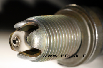

                          • What do you think of Brisk LGS plug for plasma ignition use? It is resistorless plug with silver electrodes.
                            Is silver durable material for plasma use? My car has kind of special plugs, I don't know how many different kinds are even available for RX8.
                            • Originally posted by Mika View Post
                              Arvind at Aquapulser tested them and found they held up longer than the average non resistor plug.
                              Short term, I'm going with NGK non resistors with a tungsten center electrode.
