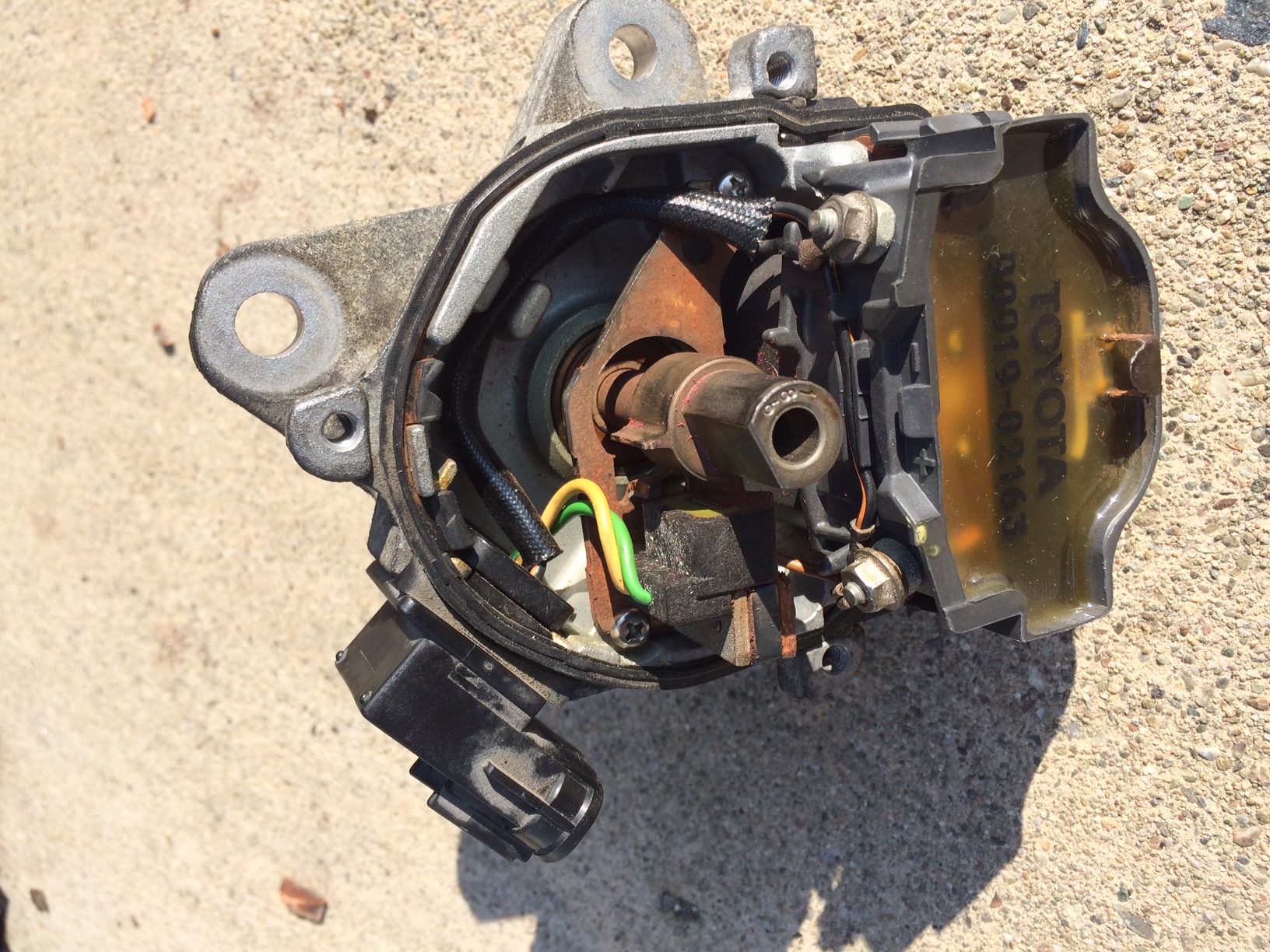

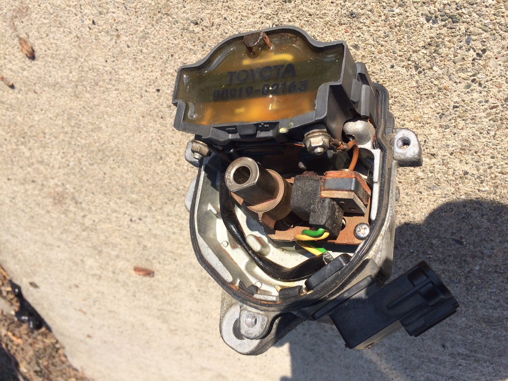

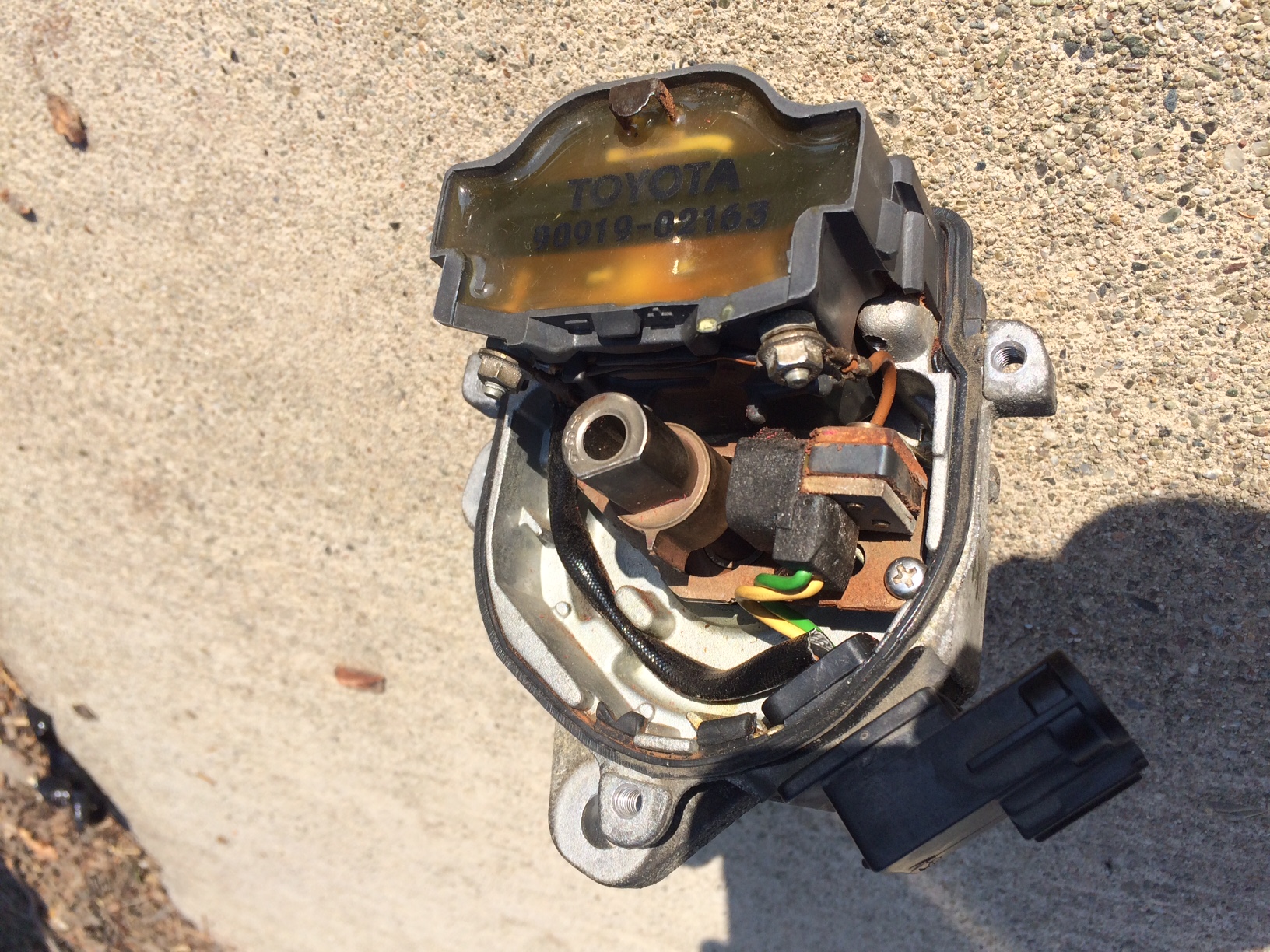

                Here are some pics of the inside of my distributor.

                    What is the red wire from the + of the coil to the back of the magnetic pickup in the pics?

                      I didn't see that at first glance and was wondering about it after my last post. I suspect it provides 12 volts (+) to the magnetic pickup since it fastens to the coil (+) terminal along with the wire coming from the ignition switch. This complicates matters as the magnetic pickup will still need 12 volts (+) on this lead to trigger the computer. But the coil has to be separated and driven only by the MSD orange and black wires.
                      In order to retain and use the stock coil, a new (fifth) lead will have to enter somewhere other than thru the existing connector which has only four leads. (Can't use lead sharing when driving the coil with the MSD.)
                      If the external coil is used then the original coil must be disconnected or removed (and replaced with some type of filler block shaped like the coil) and the lead from the ignition switch then connected directly to the red wire you asked about going to the magnetic pickup. If the coil is only disconnected and left in place as a filler block, the secondary terminal will need to be removed and well insulated from it's original contact with the cap.

                        • That little red wire goes to a condenser set down into the distributor housing
                              My best guess is the condenser was probably there to help filter out back spikes from the original coil and prevent them from messing with the magnetic pickup.
