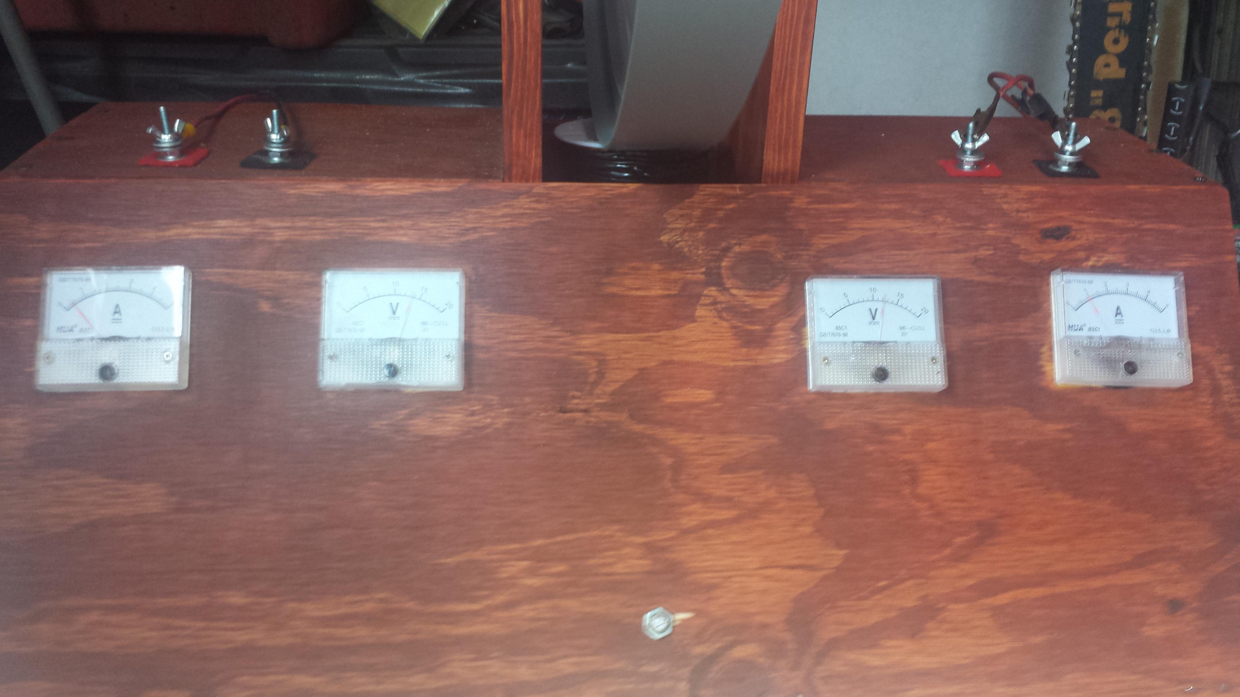

                When I measured the output voltage, I used a diode from the output positive to the battery, and have an analogue VOLT panel meter hooked up before the diode. Without using the diode it shows the voltage of the battery instead of whats coming out of the machine. I DO NOT run it without the charge battery hooked up... I learned that lesson with my smaller machine. I also have an analogue AMP panel meter showing the current going out to the charge battery.
                The input current is measured with an analogue AMP panel meter as well, which shows the current draw into the machine. The VOLT panel meter on the input side is showing the total input battery voltage, not what it is using... (SEE PICTURE - Input is on the right side, output is on the left side.)
                So your saying I shouldn't use the meters at all? Or maybe put them on a switch to cut the meters on and off? I do not have a way to check the actual voltage spikes as I do not have an oscilloscope.

                  After my last post I went back to look at your photos again, and I see how you have the panel meters wired in. I didn't think the output ammeter would show any current, but I was wrong about that. I experimented with mine, placing an analog multi-meter (set on the 16 amp scale) in the negative output lead. To my surprise, it was reading about 1/2 amp! But this also caused the voltage spikes on the o-scope across the transistor to jump from 65 volts to about 95 volts. The neons didn't come on, but they must have been close to it! I should have realized this, because I can hook up a 500 ma LED panel across the battery while charging and it still continues to charge but at a slower rate.
                  But to answer your question ....
                  ..........the ammeter in the output will definitely reduce the charging rate as witnessed by the higher voltage across the transistor. This may also be the cause of the 4 volt drop you measured between your output and the battery positive as you had the meter in the positive lead. I recommend removing the output ammeter completely because of the detrimental effect it has on the circuit. The input ammeter can be wired with a switch for momentary readings. The volt meters will have less effect on the circuit but can also reduce the performance. Especially panel meters, more so than digital multi-meters, because of their lower input resistance. So yes, I would even put switches on the volt meters.
                  P.S. ... Anything you can do to reduce resistance in the input, output, or coil windings will give you better results and faster charging.

                    Im looking for a cheap, usb oscilloscope that I can run from my laptop... Key word here is cheap! Any suggestions? I don't need anything fancy or expensive, just something that will read the spikes your talking about properly...
                    Also, would it make a difference if I switched over to digital meters? or should I just go with the on/off switches for the panel meters I have? If possible, Id like to be able to constantly see whats going on with the input and output of the machine, without having to "probe" it every time.

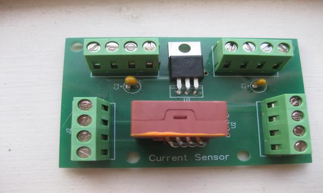

                            • #89
                              Hi P. G. --
                              Your SG build is very nice. Congrats on getting it running. Like Yaro mentioned below the high tech current sensor was designed by me and it does not degrade the performance of the SG machine. I have two each on each of my SG machines. You can hook voltage meters directly to them and with a simple formula convert that voltage to a current. Attached is a picture of the current sensor.
                              -- James

                                So using this circuit I can hook my panel meters directly up to it without affecting the SG's performance? Where do I get this circuit board? or even the schematic to build one? I print boards all the time through OshPark for various things... If the price is right Id just buy one, or two, or 4... however many it takes as I have 4 panel meters total at the moment.
