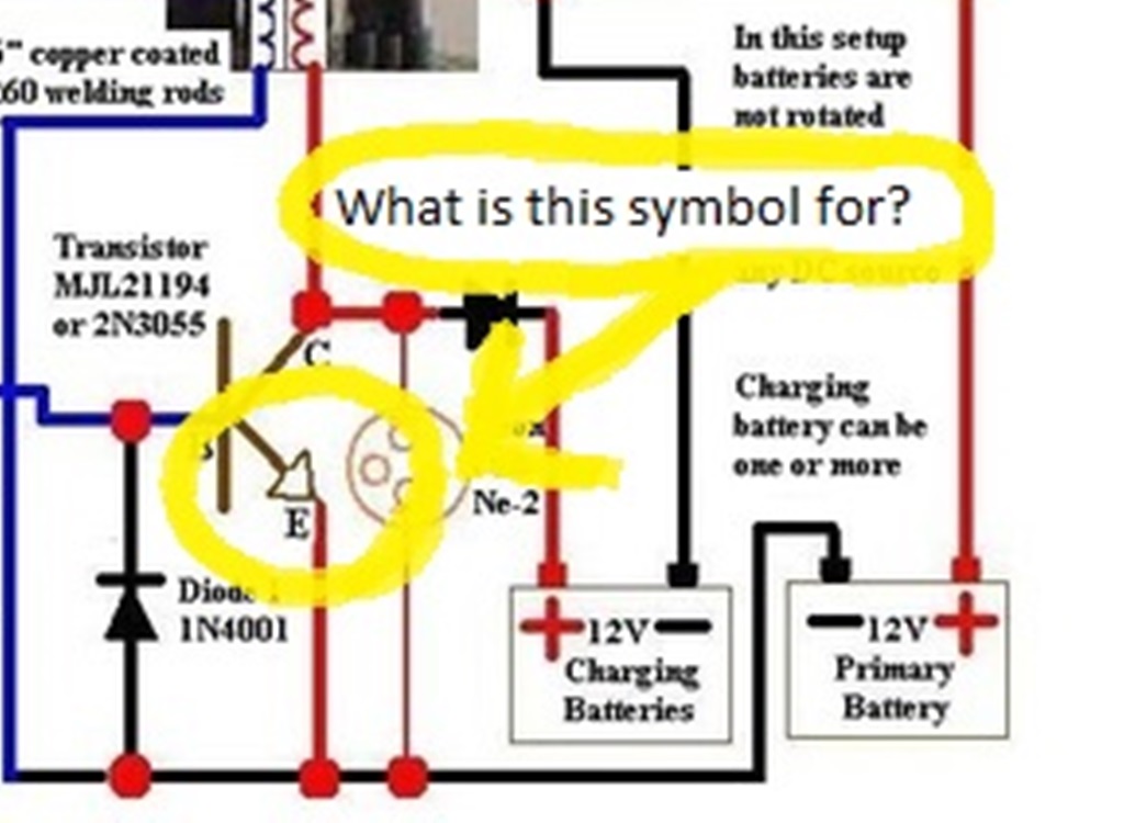

        ok, Ill be checking those today sometime... I have a question though, and the best way I can figure out to represent what I'm asking is through a picture... I THINK it is just showing the flow of power from the emitter to the negative pole, but I'm not sure... is this another diode? or resistor? or something else??? I have circled the "triangle" symbol in the picture and attached it to this post...
Name:	Monopole1 - Copy.jpg

              Also, I realized after closer inspection that I have the neon bulb hooked up wrong... currently it is directly connected from the emitter to the base... which is wrong according to this diagram. Is this possibly why the batteries drained after it stopped running??? I havent changed it around yet, its been a busy day. Ill be correcting that problem either today or tomorrow though.
                Hi Joshua,
                The wiring pictorial you linked to is correct except for one thing. It has the symbol for a PNP transistor in place of an NPN. The PNP symbol has the arrow head pointing inward toward the straight line inside the circle , while the NPN symbol has the arrow head pointing toward the outside of the circle. The little arrow you inquired about signifies which kind of transistor to use.
                The correct circuit as drawn uses an NPN. In order to use a PNP the circuit would need to be changed.
                Also the neon bulb will only conduct when the voltage across it exceeds 90 volts. So having it connected to the base would not have drained the batteries. It also would not protect the transistor from overvoltage when running with the charge batteries disconnected. And If the charge batteries failed on their own while unattended, you probably blew the transistor as well. You also may have damaged the coil with too much current through a shorted transistor.

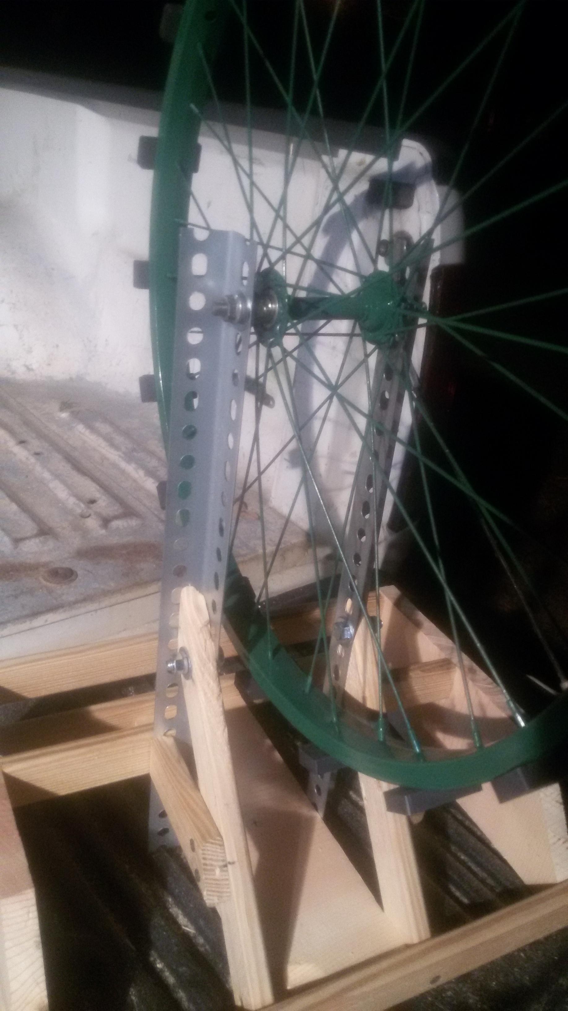

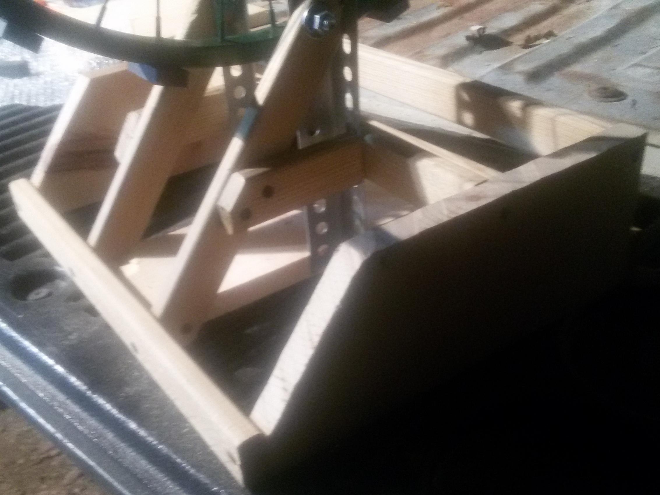

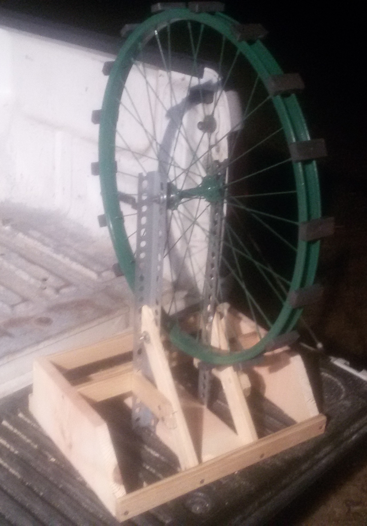

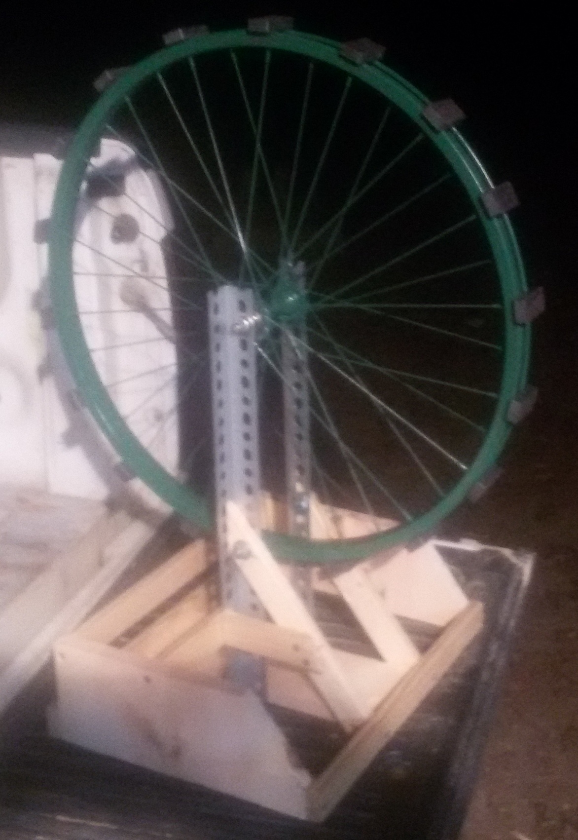

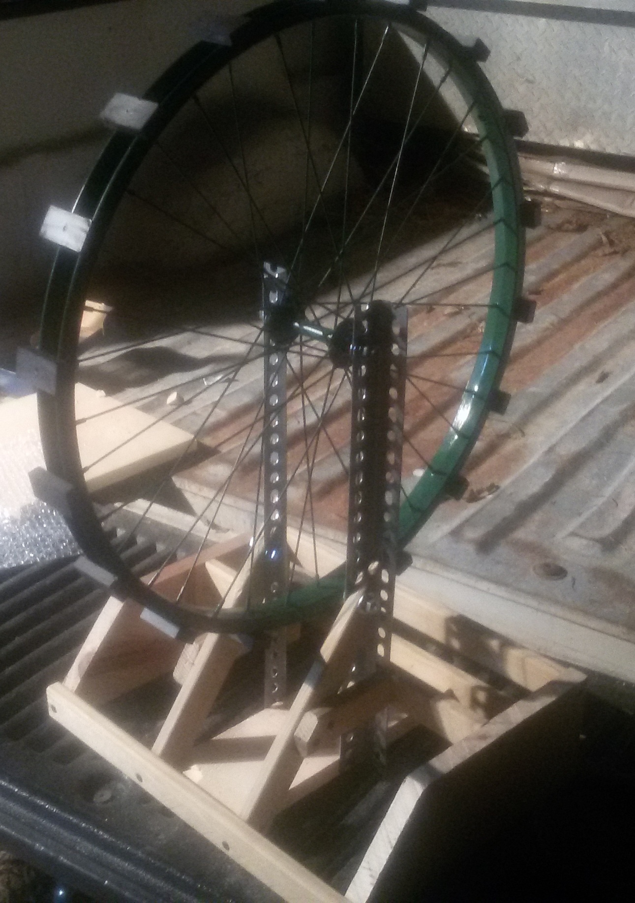

                    TODAY, even though I'm feeling quite sick (currently sucking down Colloidal Silver to help), I began building my larger unit!!! I have attached pictures of the construction so far... The magnets you see on the wheel are not "permanent" yet, I just placed them on it and gave it a good spin to see how it would do... seemed to spin pretty freely... Used 18 magnets on this 21" wheel....
ID:	47119 Click image for larger version
ID:	47120 Click image for larger version
ID:	47122 Click image for larger version
                      The symbol represents a forward PN diode between the base and the emmitter for a NPN Transistor.
                      Navneet.
