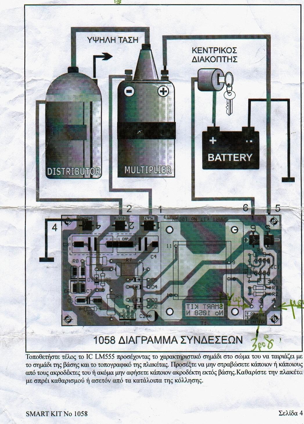

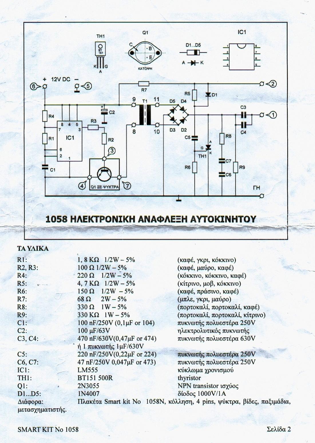

I have these two documents only, (some words in Greek but it is coded in English. For any help please tell me):
(click on the image to enlarge)

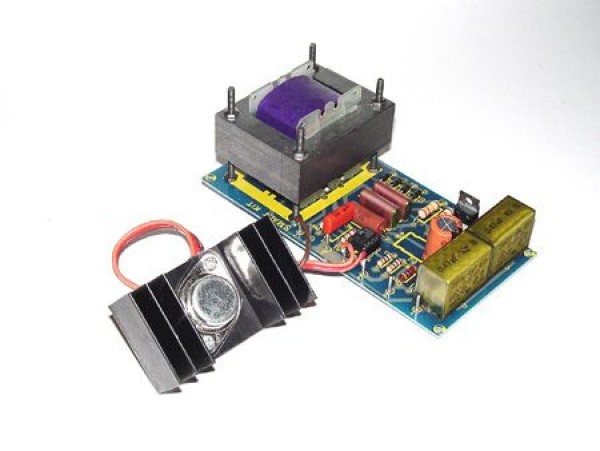

Do you want a photo of mine? (A little bit differentiated than that of the brochure, I don't know why).

Thank you.Originally posted by RichardThank you, Hellenic.
That shows the distributor points input on terminal 2 and all component values are listed except the transformer which appears to be running about 3377Hz based on the resistor and capacitor values on the 555.
Newark.com has a 1,200v 15 amp (110 amp surge) diode rated 20ns for $5.56, and that's the best speed I see anywhere in that range of amps and current with a forward drop a bit on the high side at 4.04 volts. Part number: DSEP15-12CR
The p600 I saw was rated 2.5 microseconds so the DSEP15-12CR is about 125 times faster (2,500ns/20ns=125). An depth search would likely produce some more ideal parameters such as lower forward voltage drop and lower cost.
