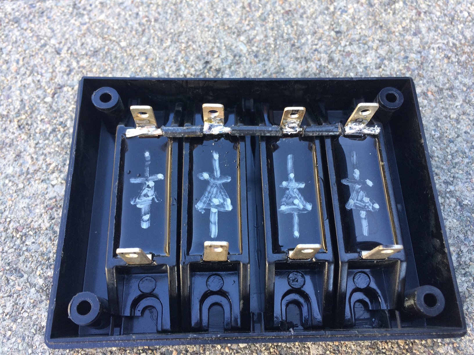

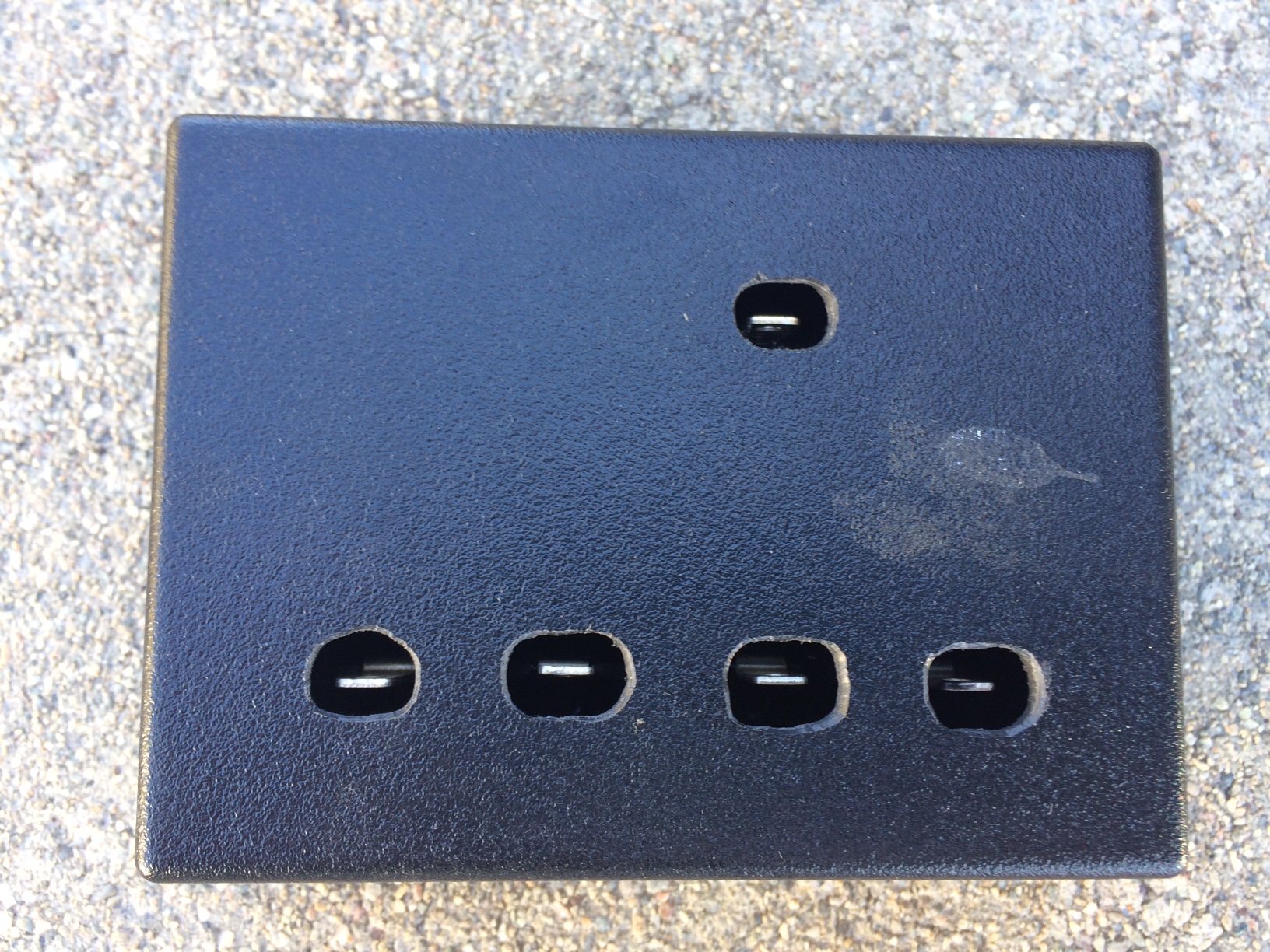

Well, I have a problem? I got my diodes and mounted them in a nice little black box and did all my connections. When I start it up it barely runs, sputters and pops. So I disconnected everything and did a test with one plug and one diode. The original direction I connected everything I get good spark and when I reverse the diode I get no spark. So why does it barely run when I have it connected the direction of spark?? Again, this is a 1996 Toyota Tacoma 2.4L 4 cylinder engine. Something is strange about how Toyota ignition works???

If the CDI/MSD is hooked up properly and it runs without the diodes, should be fine.
You said your ignition coil was upgraded to a performance coil intended for cap discharge as far as I can recall.
The positive of the ignition coil is in contact with the + of the capacitor in the MSD with a switch in between like SCR and is switched on to dump the cap when the MSD is triggered.
So having a diode from that positive to the top of a spark plug that is grounded allows the cap to discharge over the gap whenever the MSD is triggered since that is the lowest resistance path to ground after the spark jumps the gap to make it conductive.
Do you get a good spark with the diode when the cathode or anode is connected to the positive of the ignition coil? If anode, the HV from your ignition coil is positive and if cathode, then the HV from ignition coil is negative.

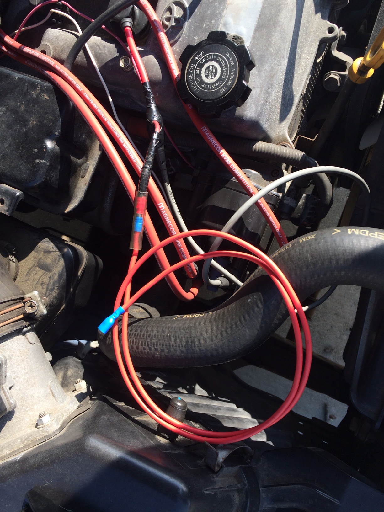

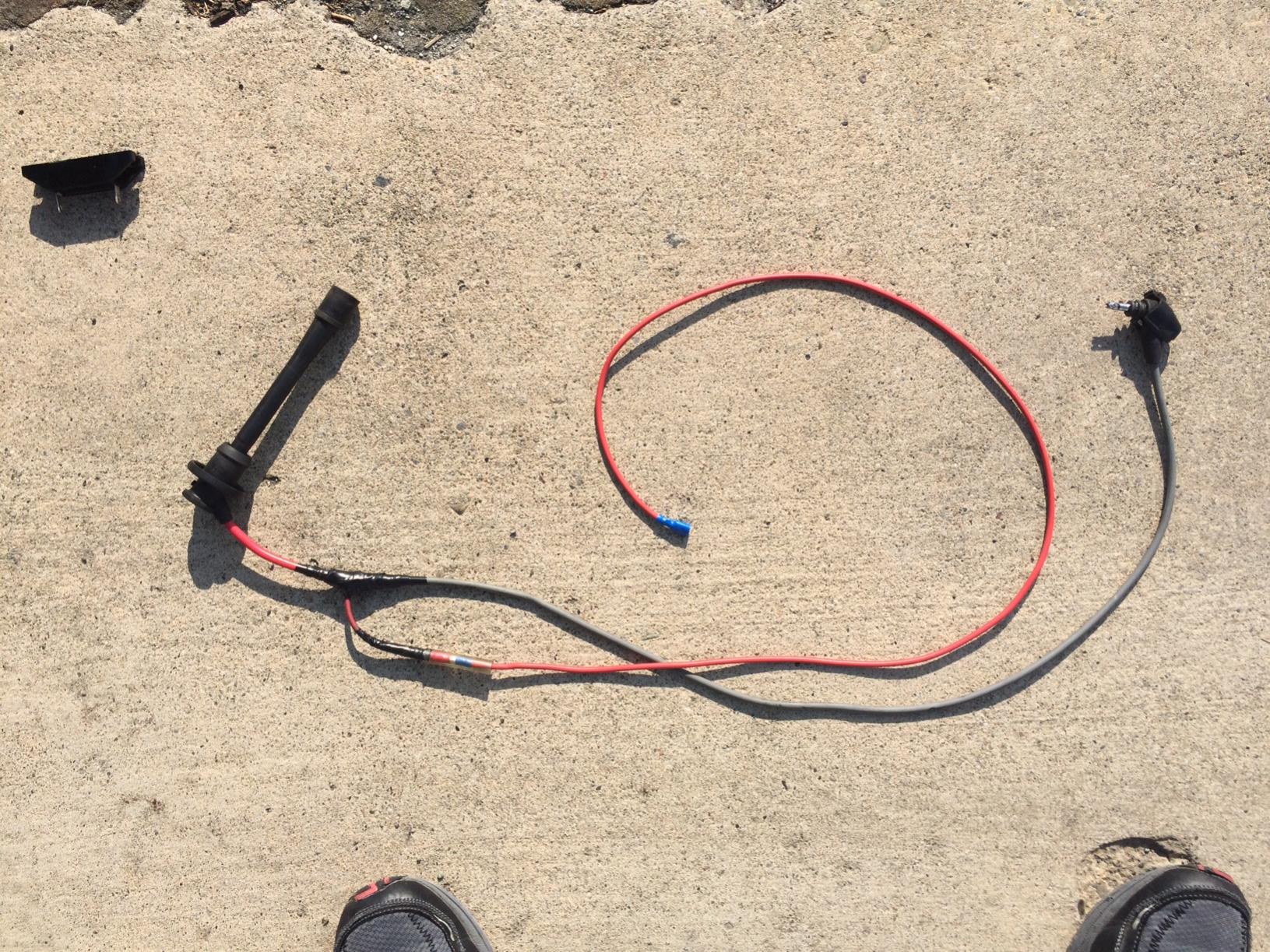

I connected my modified spark plug wire to #1 cylinder, started right up and ran good with nothing connected to it
BUT then all I connected to it was my jumper wire which would go to the diode and the whole engine started missing and died! And the other end was connected to the air! To nothing! And it just missed and chugged until it quit running??? The red jumper wire is rated at 6KVLast edited by rokan; 08-27-2018, 05:00 PM.

"Ok, new test! STRANGE PHENOMENON!!
BUT then all I connected to it was my jumper wire which would go to the diode and the whole engine started missing and died! And the other end was connected to the air! To nothing! And it just missed and chugged until it quit running??? The red jumper wire is rated at 6KV"
That's interesting - it is possible the hv is going to the top of the plug and some hv id being lost in that jump wire in invisible corona right to the air - it's possible, but not sure how probable that explanation is. It wouldn't take much to diminish the energy from the spark enough to cause the engine to miss. But if you only did that to one wire and the other 3 plug cables are connected and it died, that is worse than just removing 1 cable from a plug, which would let it run rough on 3 plugs, but still run.
