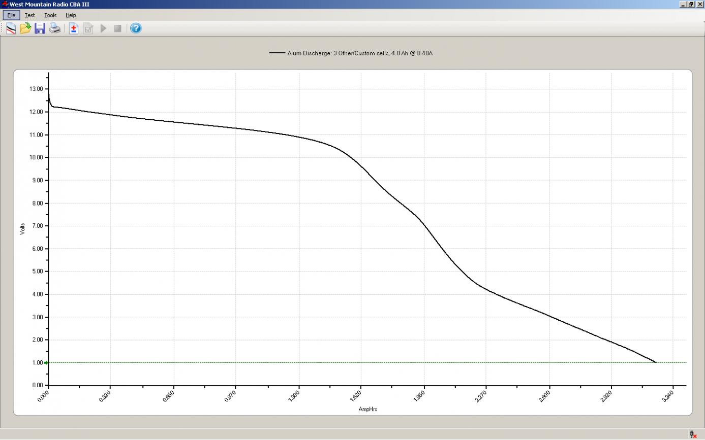

          • Ok John...here is the curve you requested. I ran 400mA down to 1V on my alum battery (with the CBA III). Two things I don't understand:
            1. In my curve where I used my DC fan, why did it die? Your 5AH battery just keeps sustaining the load..mine kinda pooped out.
            2. I'm not sure about balancing the mix. Do you think I need to buy a PH meter? I feel like my fan should ran much longer at a flat voltage like your battery does. I just don't know if I need to add more S04 or make a stronger alum mix.

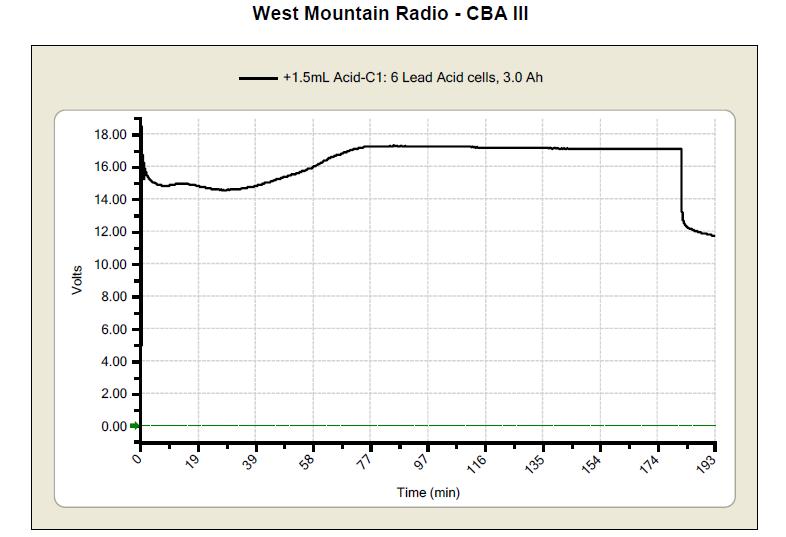

              I added 1.5mL acid to each cell, shook it up and charged my 3Ah battery with 1A for 3 hours. Here's the charge curve, it still wants to sit at 17v.
Name:	Lead Alum Battery Charge 1.5mL Acid.JPG
              I did use the pH meter I have, which is designed for pot plants but the pH did not come down much, only just under 7. For ****s and giggles I used the pH meter on a regular wet lead-acid and the pH was 5, so I'm not sure if when you said a pH of between 3.8 - 4 I heard that right as that would seem to be more acidic than a regular lead-acid battery.
              Like Branch, I'm not sure if I need to balance it more by adding more alum or acid. I'm thinking a stronger alum mix would be better.
              Anyhow, I'm running a discharge curve at 400mA. Will upload the chart in the morning. Thanks again for your help.

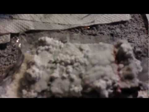

                I didnt upload this vid at the time because it was cut short....I should know better than to try and build alum batteries while trying to keep a 15 month old entertained.
                But this shows how strong my alum mix was....it doesnt look as strong as yours. But then that could also be because I used crystals....didnt grind them down, but boiled them in water in a pan until they completely dissolved.
                Regardless, this may give us some basis for comparison.
                One other thing I did differently that I know John mentioned in one of his videos....was to charge up the lead acid first before converting...so that it would have that "potential". I know you started dry, so not sure what impact that has...
