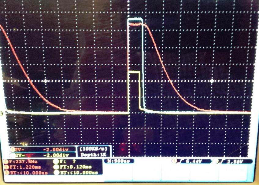

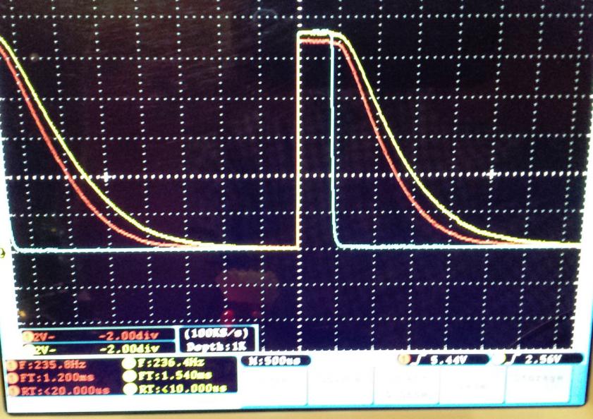

        Why "These" Transistors That Turn Off So Slow? MJL21194 & DB243 for SG / Tesla Switch
        Hi John,
        Regarding your Post #6 here in Tesla Switch of John Bedini's circuit for the single battery + 2 Cap's unit; see attached scope shots. These tranis are not great, either one, driven this way. Am I wrong? Please reply.
        I tested JB's circuit and found the only thing the Cap between Darlington oriented H11D1 internal Trani & either MJL21194 or BD243 is to de-couple waves off the Gnd, coming from the fluorescent desk light above my circuit. The diode does nothing either. So why would John Bedini himself put this 'stuff' out there? He is not even the ones selling books, so I cannot understand. I tried ~20Hz & 236Hz with 45% down to ~ 5% duty-cycle. The reason for the slow turn-off is the transistors being driven with the H11D1. The H11D1 can drive a resistor just fine, and that is about all. Not suited for BEMF applications. Am I wrong?
        Please save me some time with all your experience doing these things. After a year running Mono-SG's, SS & rotored, I never once looked at these two trani types driving just a resistor Vs. a highly capacitive trani like either of these. How can this be? I wrote Tom Childs a while back and remarked how the 1N4007 Diodes conduct in reverse above 17 KHz, and so were not suitable for solid state operation above the annoying audible frequencies. Now I am churning inside having just purchased and carefully matched 130 MJL21194's, and now I am wondering if this is another TPU Rabbit Hole? Why would a BEMF system mute the critical turn-off by using these devices arranged in "This" way?
        Am I going to have to go buy 130 MJL21193 PNP's to force the MJL21194's to shut-off fast to actually really charge both batteries? Is that the BIG secret I must buy 17 books to learn? I would rather die.
        John Bedini says in a past conference video speaking about how his 10-Coiler charges both stating "The problem is, everyone wants to change it". . . OK, so maybe the slow diodes and slow trani's must be used so that they will be slow enough to leak some radiant in before pinching off, as in Peter's Plasma Ignition explanation? But this is the Tesla Switch, where mechanically "Fast" turn-off is 10X more important than fast turn-on. Double-Diddilly-Doh! :-(
        I read John Bedini telling someone how critical it was to be sure to use "Exact 50% duty-cycle", yet Matthew Jones stating "Off-time is required to get the effect", and "I use less than 50% duty-cycle so the Caps do not short out. I tried and yes 50% DC not only shorts the Caps together instead of to battery, the Turn-Off Time of the H11D1 virtually guarantees shorted Caps if 50% were really used in a Tesla Switch.
        Has anyone ever made solid state switching fast enough to work for a Tesla Switch? Is this why the Cigar Box NiCad & Relays unit used relays, because if so, I have been working on a Ring-Counter-Gattling-Relay scheme to enable higher frequency operation.
