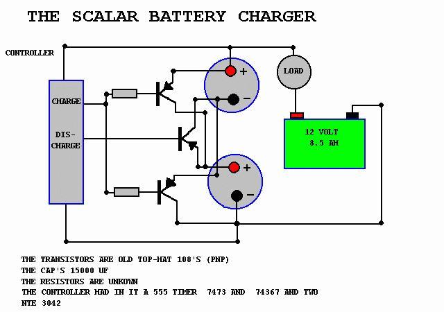

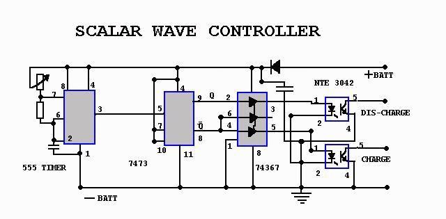

          The "Bill and Ray" Scalar Charger
          This is the "Bill and Ray" scalar battery charger that works on the same concept of the Tesla Switch, for discussion.
ID:	44694Click image for larger version

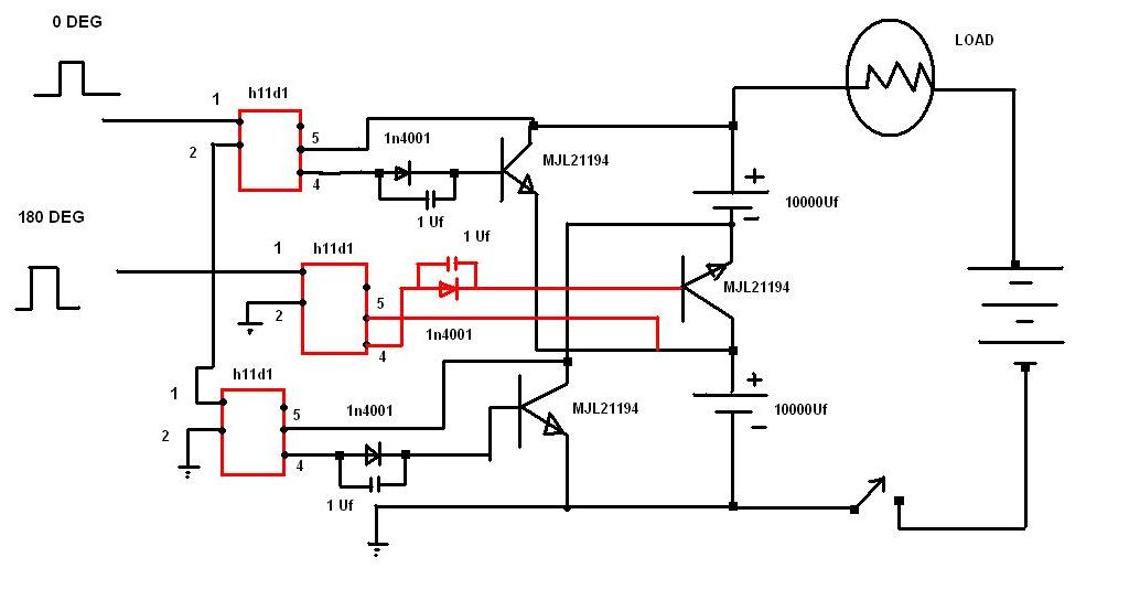

            Here is John Bedini's version of the circuit using opto-couplers:
                  [ATTACH=CONFIG]532[/ATTACH]
                  John, have you been able to replicate this? Or can you give a link to a successful replication.
                  Tony
                  I believe in the Way, the Truth, and the Life.
                    Wanted to say thanks to John K for posting those diagrams in here. I'm making progress on my TS project. I've had it running for about 4 hours before I shut it down to make additional modifications/improvements. I'm building a simplified design that only requires two switches, based on a design posted on a thread on the energetic forums, Mathew Jones is the fella who posted that, and he's been a big help. I have also proven my idea to put a coil on both sides and pull power from both works, you simply need to make the back side draw as much power as possible, huge inductive load, almost dead short. I drew 700 mA, at 60 V off the back side for the duration of my run, front load was much smaller.
                    Regarding the question from fathershand, I'd consider mine to be a successfull replication of TS, although my batteries are running down, it's expected with the design I'm using. The big benefit is I actually beginning to understand what those scalar wave battery chargers are doing now, that I've built this, and have been playing with it.
