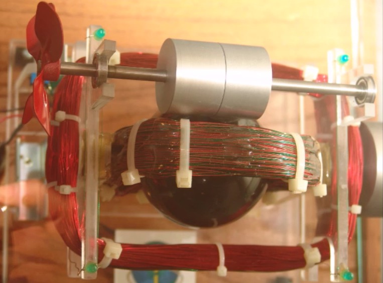

                Aaron,

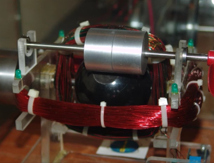

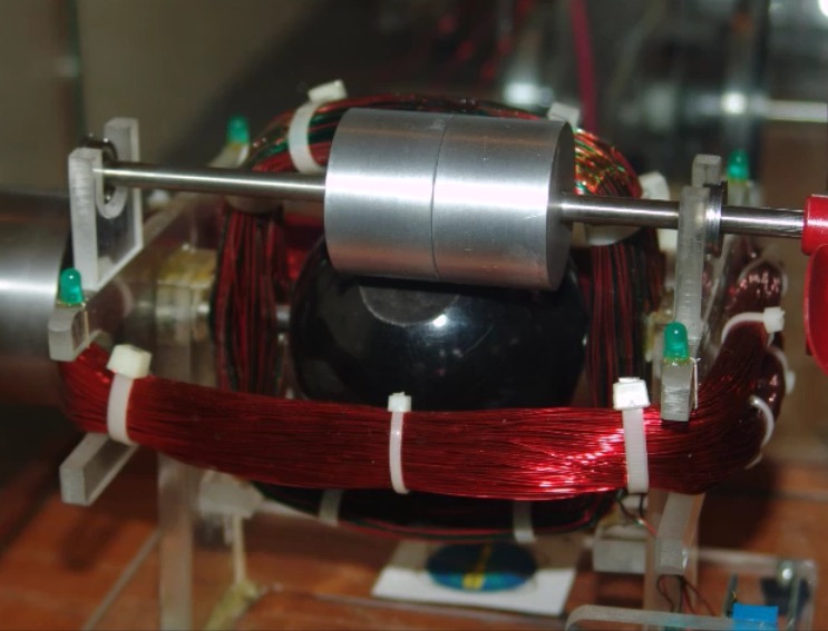

                according to the book, in the "motor with the ball rotor inside the magnetic window coils", two neodymium-iron-boron magnets mounted into a plastic ball are used, assembled on an iron spacer.
                However, it is not clear to me if they are superpole or not. They are rather not, I guess. I cannot imagine glueing two repelling neos together.
                So I cut an iron rod and mounted two neos on it as suggested in the book. Holding another magnet near to it, one attracts, one repels, the neos adhere to the iron spacer.
                For the time being, I can continue in my search for the Bedini glass case motor, making rotor, coil, plastic ball and basic configuration of circuit.
                In the meantime, there may be others here on this forum who may mave heard of some details about that particular motor type.
                I find this motor fascinating and I will stick to this for a while.
                Thanks for help,
                Elmar

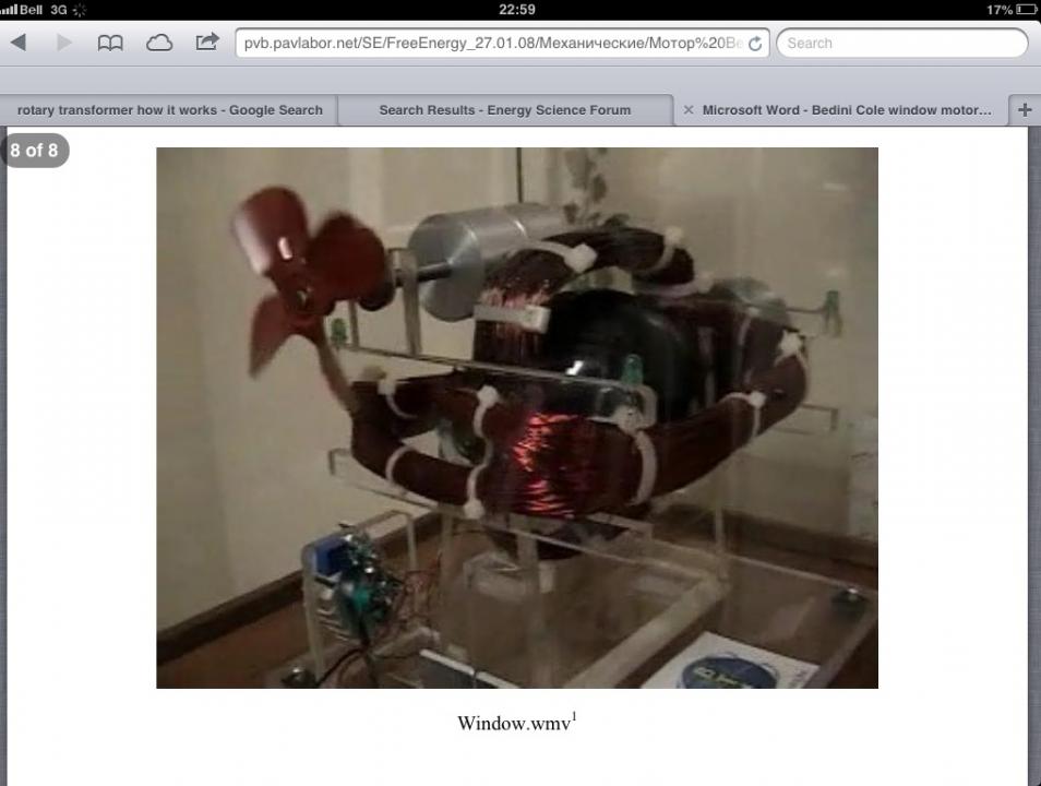

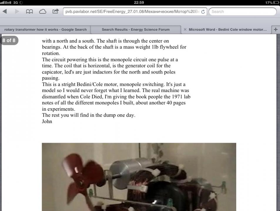

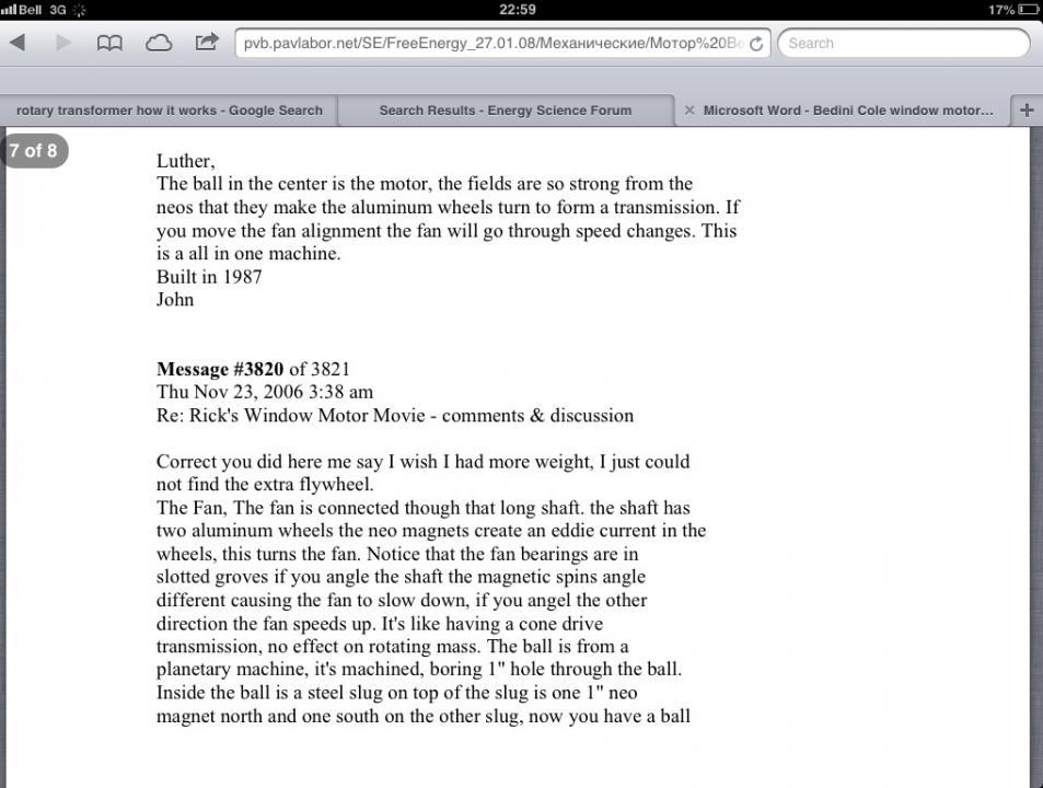

                  This may help you with some place to start until Aaron publishes the materials at some future date. These are old posts I gathered some time ago... From someone else who posted them.

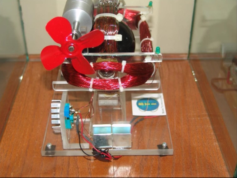

                  • Hi Elmar,
                    Here's JB having a nice little conversation on some parts of the "Glass Case" or "Space Flux" motor:

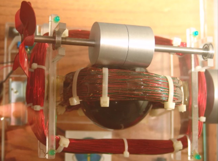

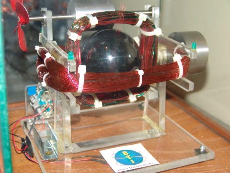

                      And some more pics...

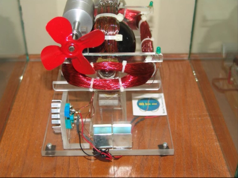

                        Elmar,
                        With the two neo magnets in the ball, they are not in a superpole configuration. One is N out and the other is S out. The iron spacer makes it like one big magnet but the point is that there is a single face of each pole facing out on opposite sides.
                        From what you describe, you have assembled the rotor's magnet configuration properly.

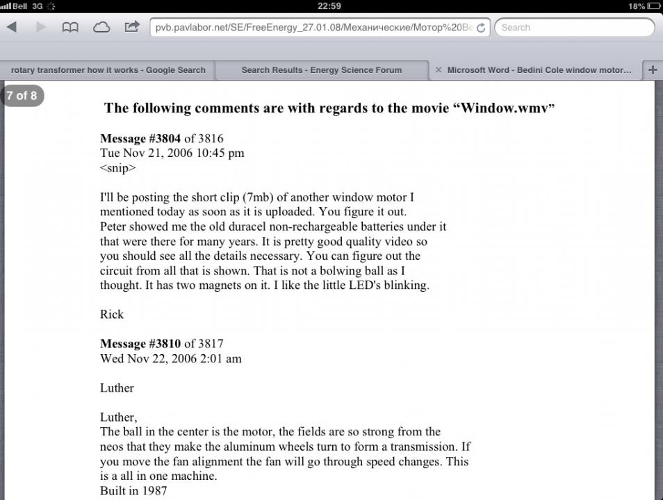

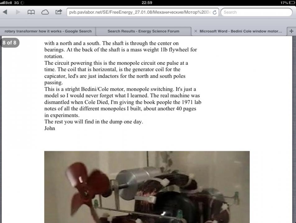

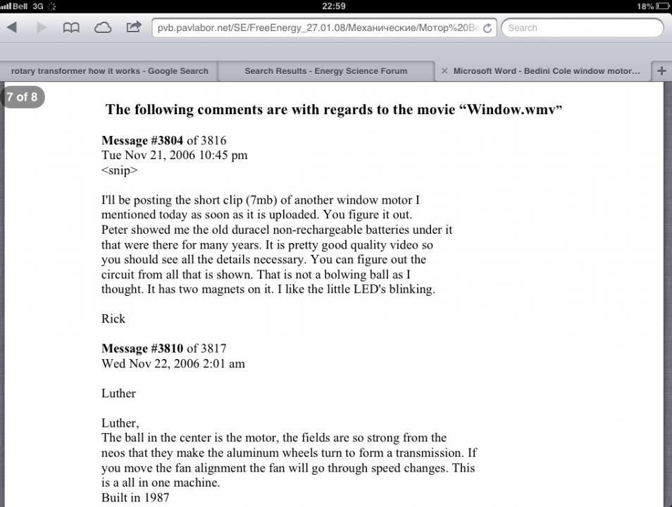

                          Hi Dave, can you post these larger? They came up very small for me.
                            Ok I resized them...
                              Thanks, that worked!
                              • Thanks to all of your contributions.
                                I understand now, in the book I mentioned: "The Magnetic Window Motor", 1971 from John Bedini, in the 40 pages there are only three pages about the motor with the ball rotor. Neos are used here, mounted on an iron sleeve.
                                The window coils are mentioned and a circuit diagram is given, no wire thickness or approximate length of wire given.
                                JB also calls it a toy motor - I start building parts of it, like the ball rotor - for fun.
                                Meanwhile I may have evoked some interest in that particular device, so that, hopefully, some more fragments of information will be collected.
