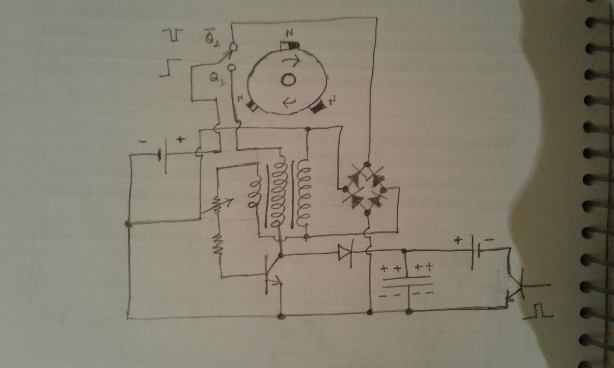

    The switch I showed does not change how the SG is triggered. It is in series with the battery so that when the long contact is in contact, the battery is connected and it runs in normal mode. When the gap comes, the input battery disconnects and the small short contact gets switched on and at that point, the recovery cap gets dropped to the front battery.
    Here is a schematic of My version of the Pat#6,545,444
    the Capacitor discharger circuit is well described in the Complete Intermediate Handbook (SG) but I think there some thing more to it..like the Back pop to front battery needs a switch that is in 180 degree phase shift to the Capacitor discharger switch. Secondly the Capacitor Charging is done in the generator mode and the Pat#6545444 does not disclose the diode there..what say??
      I understood what you thought about my previous question to you...no that's not what i meant..yes what you have posted here is perfect in its sense. what i really meant is the
      1984 machine (Single battery) uses a Torque motor, while the 2000 SG motor is a speed motor, in the 1984 machine the commutator is the only switching involved(apparently at least), while in the 2000 SG there are two modes of switching present 1) The Transistor that Magnetoelectrically generates the Spike 2) The Capacitor dump circuit with the Inverted potential switch. In your earlier schematic if you include the external genny coil and make it a part of the Magnetic circuit of the SSG would that not make it JB's pat #6,545,444 ? but having done so things change, now you would charge a back battery with the recovery coil (genny) and dump the Capacitor charged by the spike into the front battery using the Inverted potential switch.

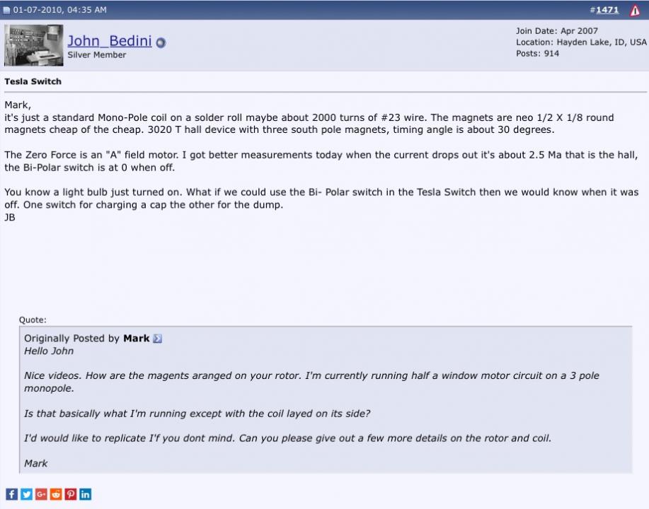

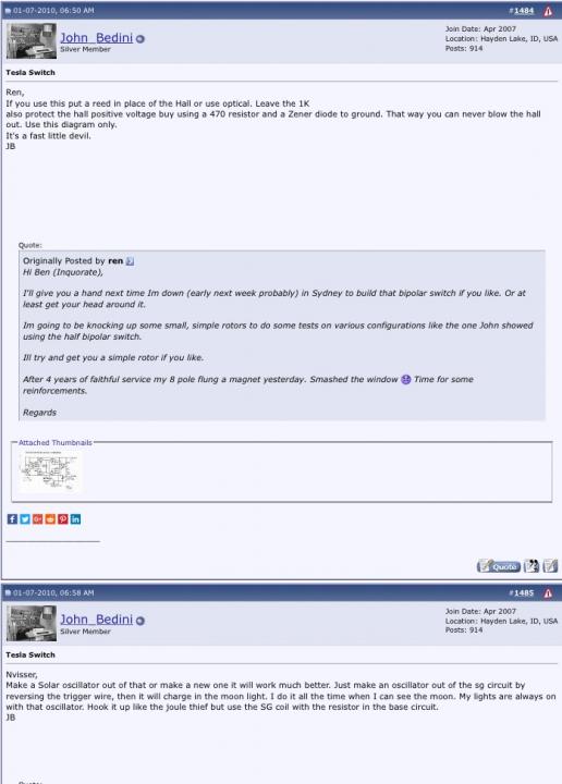

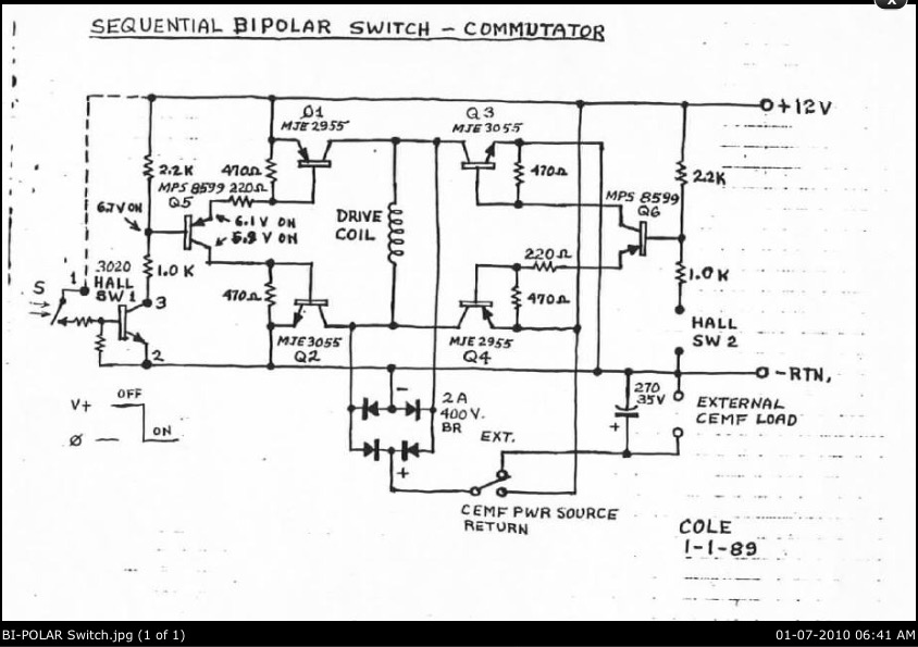

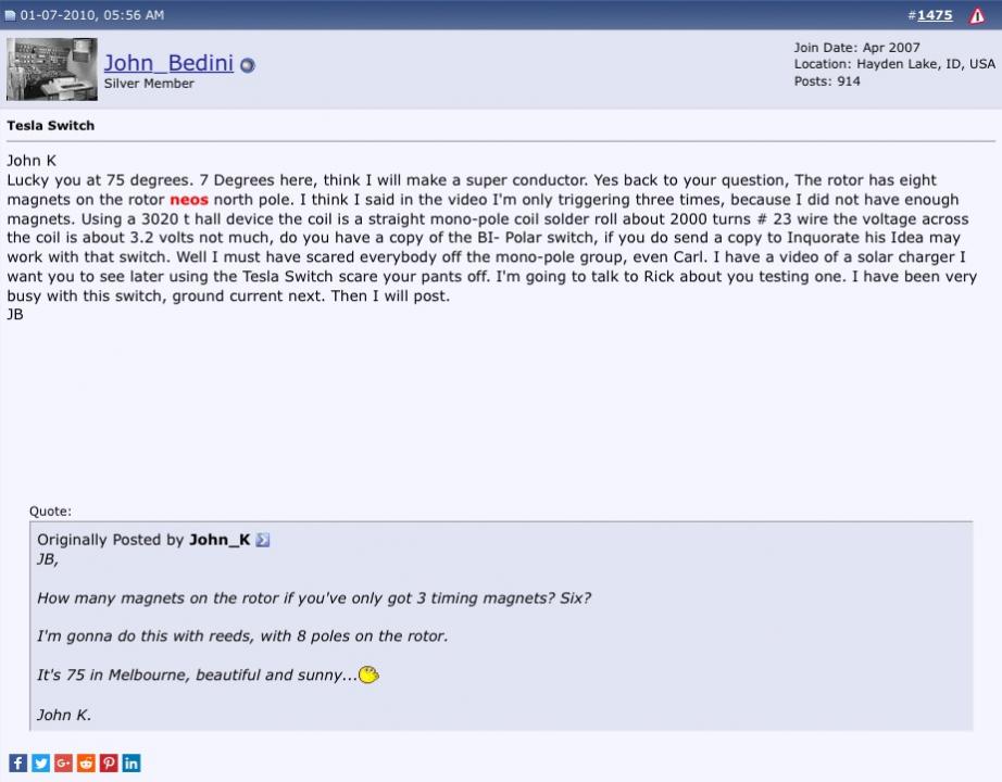

                Would like to comment the zero force motor part of your post #161, in connection with this video: http://youtu.be/3kpDMMcNQxc
                Although John mentioned in this video too that the setup was a no Lenz, no back emf setup, the scope shots you have taken from this video show it otherwise. There is induced voltage across the stator coil, the 'hump' between the two 12V battery input pulses just represents it. In fact, the stator coil was energized by the input voltage (hence current) whenever the rotor magnet(s) just swept tangentially along the middle part of coil, and a good part of every second induced sine wave cycle was overriden by the input pulse. I show this in the attached picture I also took from this video and edited a little to help understand the situation. The single induced 'hunch' shown in the Naudin scopeshot is normal when a single magnet sweeps tangentially a coil, you may have seen Naudin's Mini-Romag generator explanation attempt with the 2 coil tests: http://jnaudin.free.fr/html/mromexp.htm and the waveform on the right hand side: http://jnaudin.free.fr/images/magconfig.gif (Of course, Naudin's induced waveform is not sinusoid because a single rotor magnet was used.)
                In the very bottom of my attached picture I illustrated (by copy and paste of the missing sinewaves) how the induced voltage across the coil would have looked like when there would not have been input voltage pulses and the rotor just would have been rotated at the same costing RPM by an outside motor.
                It is fair to say that the amplitude of the induced voltage by the rotor magnets is small compared to the input 12.5V battery voltage: about 2 V peak without the inserted core and about 4.5 V peak with the core. For me this means this single stator coil setup in this video must be a motor with low Lenz effect (especially without the core) and has a certain value induced emf (i.e. back or counter emf, who prefers what term) in it.
                Regarding the input current drop from about 200 mA to about 20-30 mA (values are best estimations from the 5 Amper full scale) when John inserted the core into the stator coil: I think the explanation is that the inductive reactance (XL) of the coil was increased significantly by the core due to the increased L inductance, thus an increased impedance was connected across the battery. This invariably involved the reduction of the input current.
                Gyula
                PS: Before anyone wishes to 'denounce' me how I dare to say such things I did above on John's single coil ZFM setup, let me tell him I respected John but I think his scope waveforms can only mean the 'things' I wrote above.
                By the way, I have been in the process of replicating his advanced ZFM and will include my findings in the ZFM thread when ready.

                      Sure enough! i know the commutator you are refering to is classical to that 1984 Machine there is no discrepancy over that!! cool pal I interguied on these essence 1) the Magnetic Structure of the monopole 2) Trifilar Coil configuration 3) Switching mechanism. pertaining to JB's Pat 6,545,444

                      • no induced current feedback to the input
                        I really have no idea how John wired up the demo of that particular ZFM... And I am not talking about the half or full bipolar switch, but a generating circuit. But one thing I do know is that you can decrease the primary applied or supply current by sending the induced or generating current back to the applied or primary section to lessen primary amp draw, with minimal speed loss. Is he doing that? He could be.
                        Hi Dave,
                        There is nothing unusual in how John wired up his ZFM circuit in this video https://www.youtube.com/watch?v=3kpD...ature=youtu.be What seems unusual is the position of the stator coil with respect to the rotor disk that has the magnets like poles facing out radially towards the coil, i.e. the magnets rotate tangentially to the coil.
                        And the coil is switched on or off by a half bipolar switch (John says bipolar switch but the scope waveform does not show he used a full bipolar switch but half of it: no input voltage polarity change happens across the coil, the waveform does not show such). The (half) bipolar switch was controlled by a Hall sensor and the sensor by a timing wheel, these latter two were positioned at the right hand side of the setup.

                          Hi Gyula,
                          At the 2:20 mark of the video below John says: "And now we just accelerate because there can be no BEMF here and the motor speeds up... And now we are going to add the controlling factor." What is the controlling factor controlling? Could it be BEMF, because John says when you remove the iron "we just accelerate because there is no BEMF" which implies there was with the iron inserted.
                          John also used eight neo magnets on that particular machine with a hall triggering on three magnets... He says he only had enough magnets to trigger three times per rotation... Is that true or was he showing something or what could be done between power pulses? He also says he used 2000 turns of number 23 yet we see green and copper color magnet wire in the spool. So there appears to be at least two wires on that spool.
                          Below are the posts revolving around that ZFM, you can plainly see the schematic he told everyone to use below. You can see the FWBR in the image.
                          Like you posted here is the video link: http://youtu.be/3kpDMMcNQxc
                          Gyula if you have a demo of what you are saying I would like to see it.
                          I am still learning like everyone else and it can be hard for me to see what others are trying to say because I have my own understanding and way that I look at things and this can confuse me or I can miss what others are really saying very easily. Sorry if that is the case.

                            John mentioned this induced waveform in his forum post to John K: "the voltage across the coil is about 3.2 volts, not much", see it in your second image.jpg
                            This shows John was aware of the back emf but I think he ignored it because it was much smaller than the input voltage (the battery voltage) switched across the coil. Still he called this setup a no back emf one. I would call it a low back emf setup.

                            Regarding the switching circuit: yes the schematic shows the full bipolar circuit with 4 power transistors (pnp-npn pairs) and with 2 input pnp transistors to receive the control pulses from a reed switch or from a Hall sensor. If you check the video at the very beginning for instance 00:04 you can see only two heat sinks with one-one power transistor on them, this means he used only half part of the schematic i.e. one pair pnp-npn and one input pnp transistor (this latter can also be seen in a 'dead bug' position). Yes the diode bridge is shown in the schematic but I am sure he did not use it in this setup.
