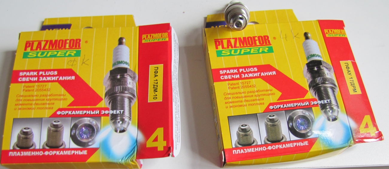

                      • Hi, I have any plugs with 0 kOhm and any with 4 kOhm

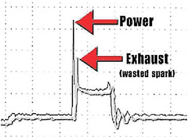

                          Faraday88,
                          The secondary windings on a wasted spark coil pack are isolated from the primary. When it fires, the HV + goes over one gap of a plug to ground and from ground to the center electrode of another sparkplug back to the coil. That is how it completes the loop. One plug will be on the compression stroke and one will be on the exhaust stroke. The firing of the plug on the exhaust stroke does nothing so is considered a wasted spark.
                          The car companies use this to cut down on the number of parts for the ignition system so they save money and there is less maintenance.
                          Whichever plug fires HV+ is always positive and whichever plug fires HV- is always negative. So the positive HV plug will have the center electrode wear down from the current bombardment and the negative HV plug will have the ground strap wear down from the current bombardment, which moves from the center electrode to the ground.
                          There are advantages and disadvantages to this kind of system, but it is very common on a lot of vehicles on the road today.
