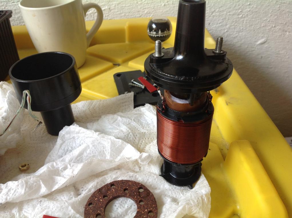

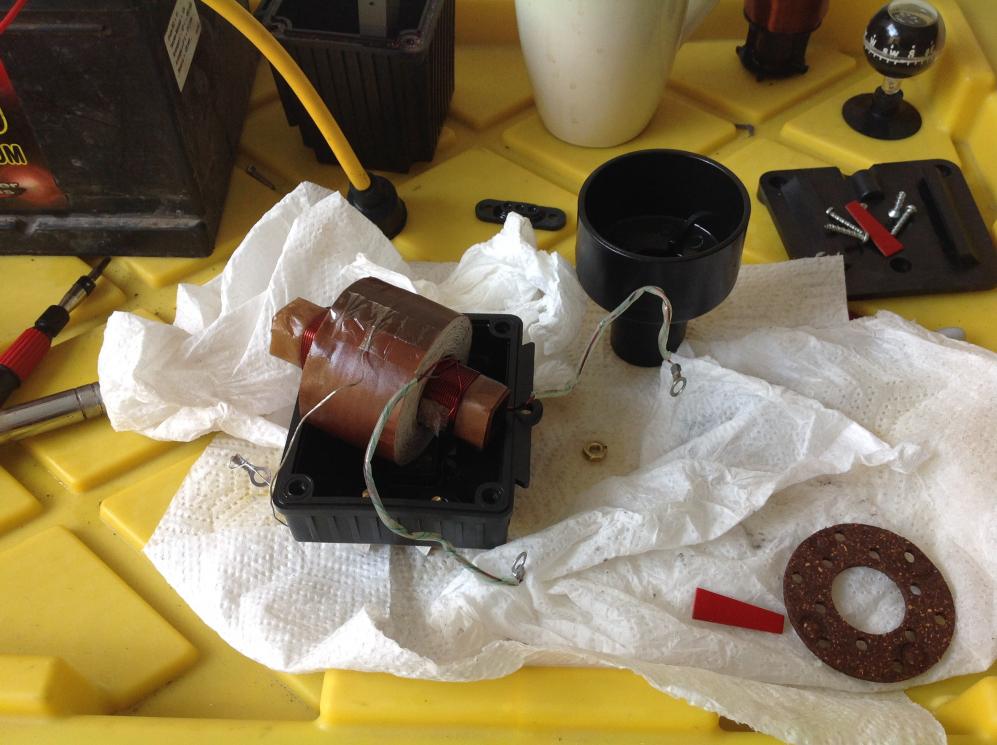

          For the longest time, I have been trying to get hold of an ignition coil that can deliver a HV (+) positive
          It has not been easy, but I know it must be possible!
          OK, so I have called Mallory, and they have told me on two different times that all of their coils are of HV - (negative).
          Aaron said that he has a coil from Mallory that is HV +, and here is a link to it.
          I have a similar looking coil, and that is HV negative.
          Now I am thinking that it must be possible to open the coil up and maybe change the polarity. Click image for larger version

          The I want HV+ is because I want to experiment with booster caps, and very big plasma. I would be forever thankful if somebody could lead me to HV+.

              Now I am thinking that it must be possible to open the coil up and maybe change the polarity. [ATTACH=CONFIG]4536[/ATTACH][ATTACH=CONFIG]4537[/ATTACH]

                • I did unwind the primary on the coil to the left on the picture above and then rewinded to the opposite direction, but that did not change any HV polarity.
                  Now I don't know what to do... but I really want to point the diodes towards the spark gap.
