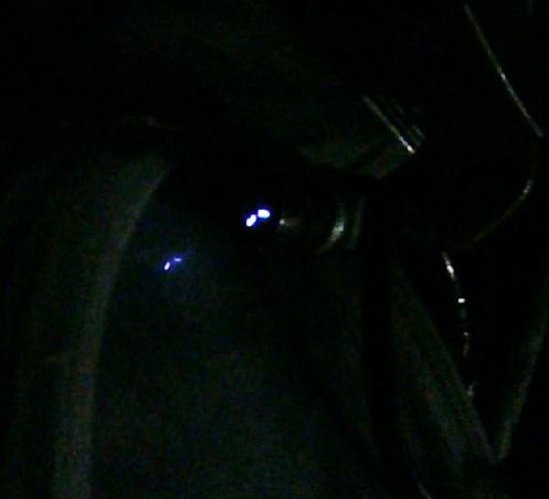

hey Realtravel - the second pic of the coil, with the green(ish?) wire just below what looks like the boot of the HV/HT wire that goes to the plug - those blackish with yellow wires at the centred terminal...where do THEY go to/come from?

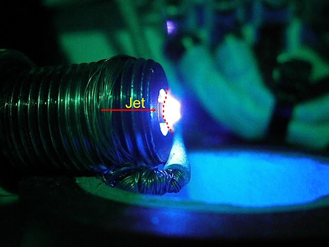

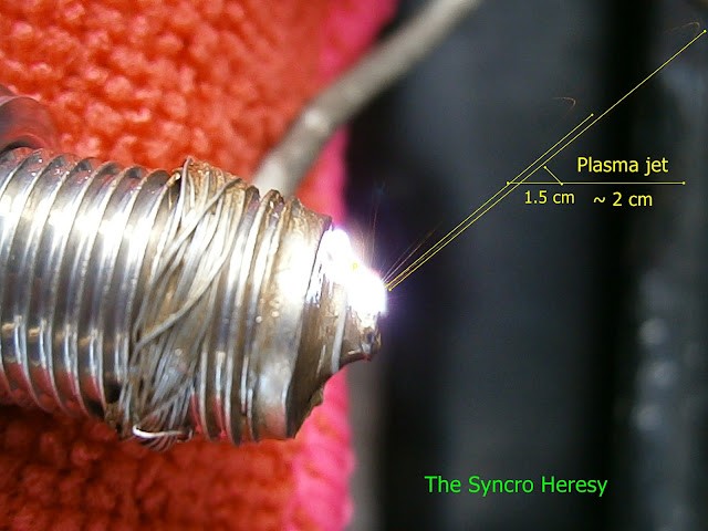

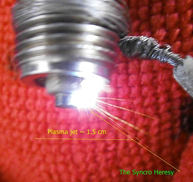

Here is mine plasma jet spark plug:
Here for more: https://www.vwsyncro.eu/p/blog-page_34.html
(scroll down please).Last edited by Hellenic Vanagon; 10-19-2022, 04:25 AM.The Syncro Heresy
