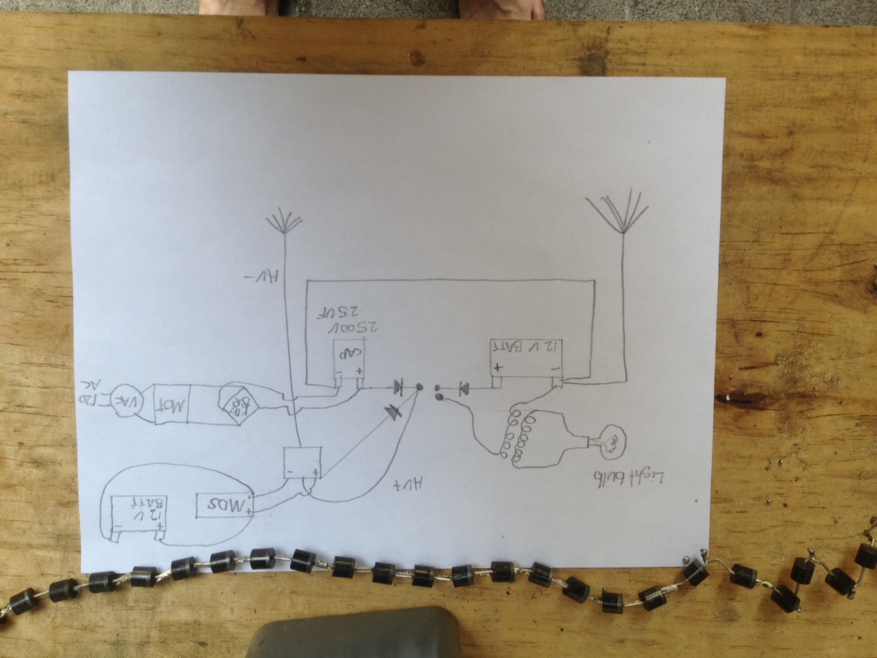

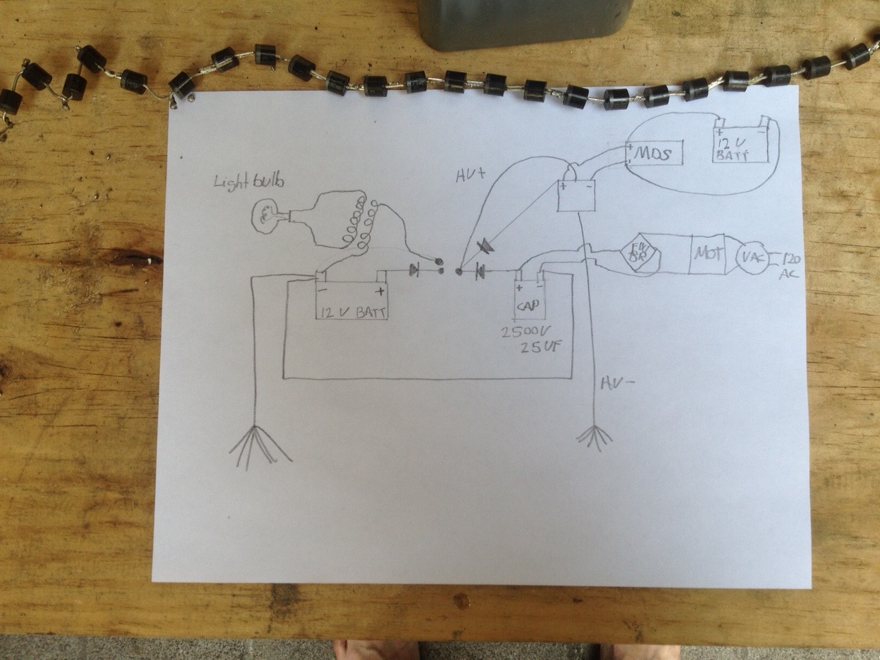

                          • Here is the circuit.
                            The filament is still working, but it does not take much to break it!
                            The coil I was using was a 23 # wire wrapped around a 2 inch pvc pipe, on top of that I used 6filiar litzed 23# wire. Just a coil from an old experiment.

                              Thank you - makes sense.
                              I doubt your 12v battery is jumping the gap or contributing - it is just there to give the HV a place to go initially before the diode shuts off and the discharge is forced through the primary coil. So if you had 24v in batteries there instead of 12v, it probably wouldn't make much difference. However, I hope you can demonstrate that you can get a battery to jump there gap through an inductor.
