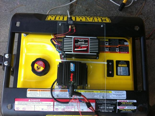

                  For my cap charger, I use this: MSD 5520 Street Fire Ignition with Rev Control : Amazon.com : Automotive
                  This unit works perfect for my jet engine - triggered with the same 555 mosfet circuit you see in the book.

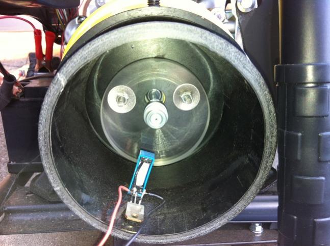

                  The unit also works perfect for my gas generator - I put a threaded rod down the middle of the generator, put on a timing wheel with a magnet embedded in it it triggers a reed that turns on a transistor to connect the msd trigger wire to ground.
                  ABS 4" end cap is bolted to the generator cover plate with the 2 bolts you see through the timing wheel. The reed switch and transistor setup is mounted to the inside of some ABS tubing that is cut about 4-5 inches long and that is pressed into the end cap. There is a bold coming through the top that I can screw down to lock it into place. Loosening the bolt, I can rotate the pipe inside the end cap to adjust the timing anywhere inside of 360 degrees so basically infinitely adjustable. Obviously, it will only need to be adjusted in a certain range.
                  When the transistor switches, the white trigger wire from the MSD unit is connected to ground and that discharges it into the ignition coil.

                  That is the Street Fire MSD unit with performance coil.
                  For real applications, I wouldn't build my own cap charger - I'd just use an off the shelf MSD or CDI and connect the diode(s) accordingly.
                  Some people get the off the shelf CDI/MSD's to work and some can't. I'm not sure why - there are too many variables. So far, I haven't been able to not get it to work with everything I've tried. Various MSD units, Street Fire (MSD's budget model), the old Tiger CDI, etc...

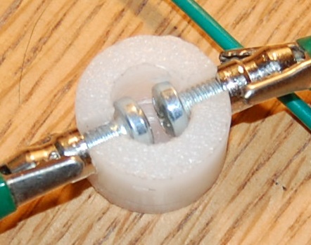

                            Secondary spark gap is a must; something like this will do:

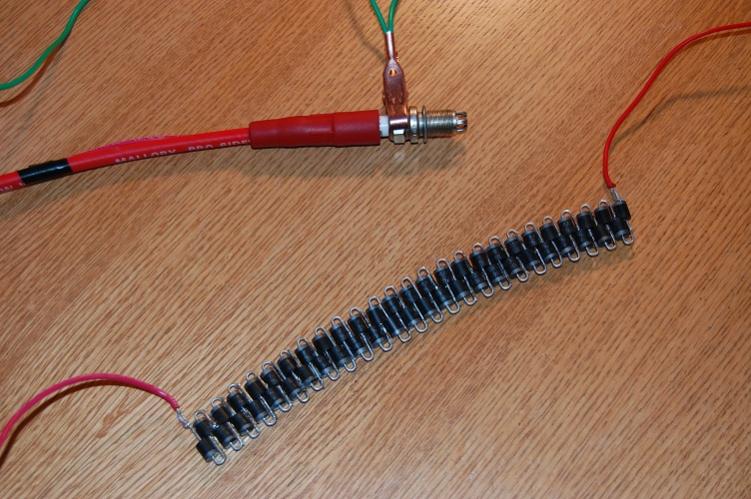

                            Crunch down the size of the diode string:

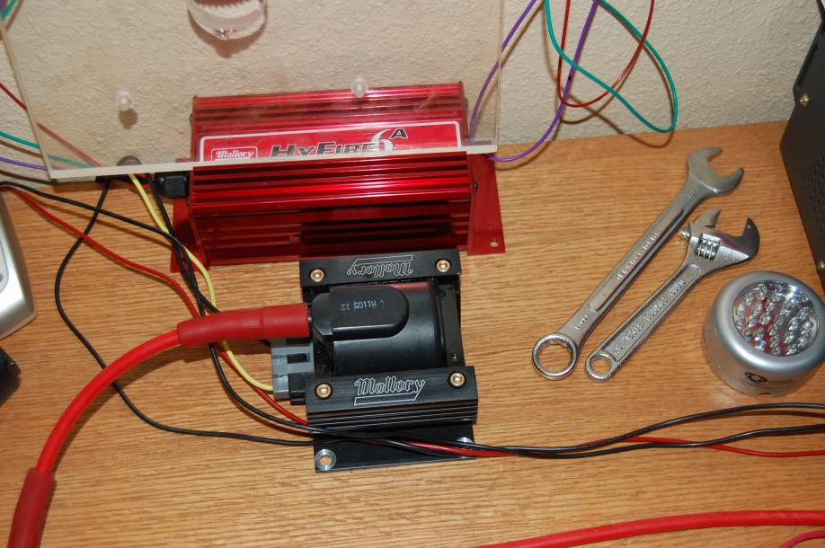

                            Grab yourself a standard ignition system:

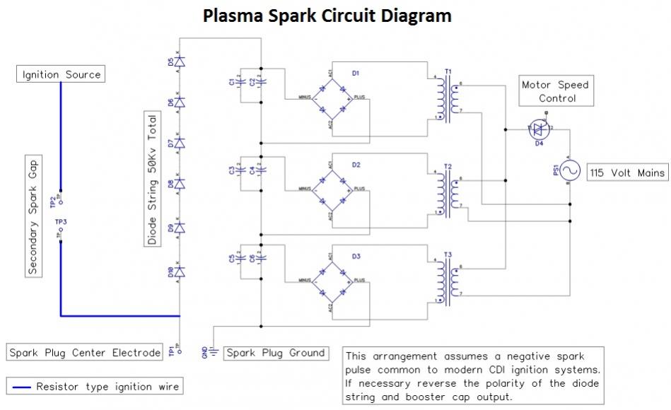

                            Build the circuit from off-the-shelf parts:

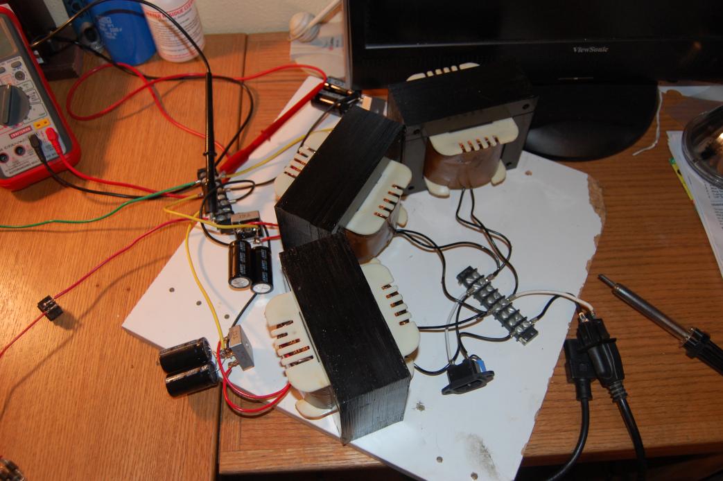

                            Tested on a single cylinder engine to run up to 3600 RPM with no issues. Powerful one inch jet shooting from plug at 30 cycles per second.
                            Hope this helps folks.
