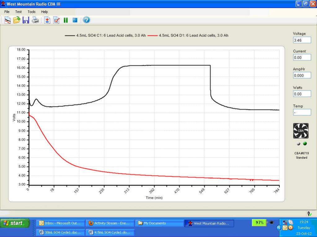

                              • Just a quick update. I loaded my battery again with the 51 super bright LEDs. At the start of the load cycle I was drawing 380mA @ 11.03v = 4.19W and the LEDs were fully bright.
                                After 801 minutes (13.35 hours) the battery voltage was down to 3.384v @ 31mA = 0.105W and the LEDs were about 2/3 brightness.
                                I roughly calculated 39Wh in and 29Wh out, but I still don't have the balance right yet. Here's a pic of my charge and discharge curves.
                                I just added another 1.5mL of SO4 to each cell for a total of 6mL added to 33mL of Alum solution. Slowly but surely...
