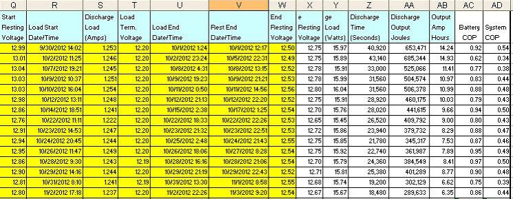

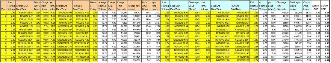

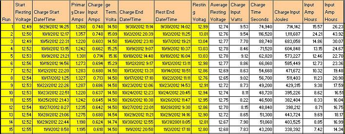

Here's an update on my 5 filar build. I've done 15 runs now and it's like watching a horror movie in slow motion. On run 1 the discharge amp hours was 14 and by run 15 it's down to 6. The charging input has a similar story. It started at 15 amp hours with run 1 and is down to 7 by run 15. Here's the 15 runs:
I see the resolution is poor, so let's try it in 2 parts:
The degradation started from the beginning and has been gradual and progressive throughout, so it's not like something just failed. Disconnected, the 2 charging batteries are holding at the same voltage so I don't think I've got a bad battery. It's more like the charger is degrading the ability of the batteries to hold a charge.
Can anybody advise what is happening? The specs and pics are on the first post of this thread. Oh yeah, ignore run 2. I must have made a mistake when writing down the times.
