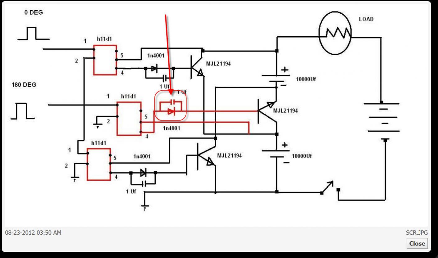

    You also asked me about what you saw in these pictures, now here again with arrows. Yes I ask "My" God, Jesus Christ, in the flesh and Spirit every day for help, to fix what is wrong with me. Sorry of I wear on you. I really cannot change much better than this so far. I'm 50 and have tried my whole life to be different and better for others.
    Thank you for showing your circuit and telling me how to see your stuff.

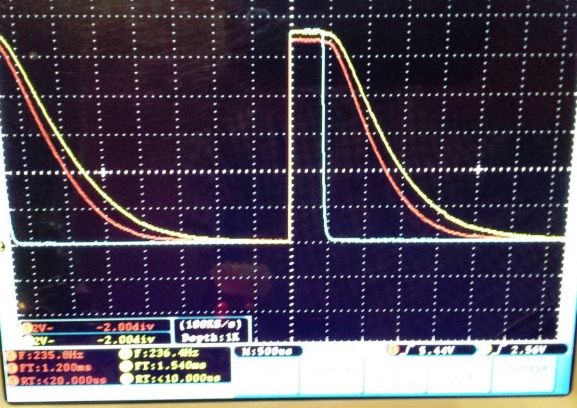

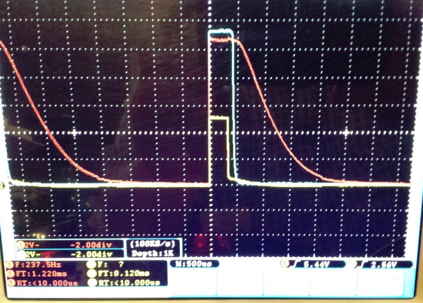

      If you find that Babcock patent, please alert me or link for me. A few nanoseconds fall-time is nice. Here is what I get with Beginner's Handbook circuit, and is same with an IRF250 FET as well. When opto drives a resistor, the fall time is unchanged, but there is a Turn-Off Delay you can see in these Scope shots.
Name:	H11D1 Woes Blue H11D1 to 10K Red MJL21194 Out Vs BD243 Out-LowRes.jpg

        I asked before whether you were using an electrolytic cap over the diode, you you cannot use one, change it for a non electrolytic of differing values suggest 0.5 - 2.5uf 400v high quality, and post some rise and fall times, also try the other modifications i have suggested.

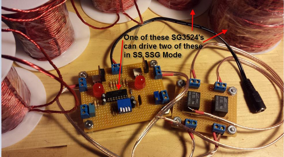

        you are running on a breadboard, a very high capacity and resistance there, bedini recommends RF style for a reason, it only needs to be on the power electronics side.
        the BC550 that is pictured is a pnp, not sure if bc550 is correct i am using a bc556, it is not run in saturation mode because all its doing is clamping the gate source when the input goes low.
        your relay switching wont last long unfortunately.
        the more you drive your bjt into saturation the longer the turn off time will be, you want to very slightly under saturate the base junction, for fast fall.
        the reason im confused is that you have a mosfet on the diagram on the bit of paper its an N type device yet you have the load on the ground side and the junction reverse biased and you are driving it with a BJT capacitor diode speed up circuit, there is not a single thing right about the diagram to me i dont even see it working at all.

                Yes 1uF electrolytic, and also tried Tantilum 1uF. What kind should it be? Stating right off saves me from asking you more and more questions.
                Yes it does work at all, and with no biasing components used (to be tried more later). Switching is just as slow on crumby Breadboard as on solder pad prototyping Bd. It is just as slow with all connections very very very short. The photo shows one channel's H11D1 / DB243 driving an IRFP250.
                Piece of paper was pointing to place where Tesla Switch schematic points to place the 1uF Cap type? in parallel with a 1N4001 Diode. If I drew it wrong, I photographed it right. What you see on the Breadboard is driving an IRFP250 N-Channel FET with a DB243, and other channel driving an MJL2193 with DB243. I got that circuit from JB's 741 Op-Amp Cap Dump. When I put speed up mod in series, it has no effect, the way I did it, with electrolytic 1uF and 1N4004 (Vs. 1N4001).
                Are you saying the Load Resistor should only be on the Drain and not on the Source? How is my IRFP250 reverse biased and still working (Slow like as MJL21194)? If just about Post-It, ignore question, as I am dyslexia afflicted so bad I still hook red to black at times. If about what is on my breadboard, please answer how is it reverse biased and should not work, but does?

                Future Fast Switching Tests for SG Monopole:
                The Relays are the fastest way to test the potential benefit of fast switching for the SG. A new relay sounds able to switch at similar frequency to a rotored SG, BUT the Break Vs. Make time will make pulse width less controllable maybe, idk yet. The tests and comparisons will take more time than I have for that right now, so for the SG application, I wait a spell to employ. To save time, when I test, I will use Cap Dump dumping Hz to judge performance. These 20A relays will last long enough for that, IF the pulse width is manageable enough. Trigger wire will still run the show, but using the one-trani to pass its switching to a relay, just to see IF the BEMP is gloriously bigger or not.

                    for driving the BJT you should be using something like Poly Non Polarized capacitors and a high speed switching diode like a 1n4148
                    if you are using a high side driver on the mosfet you need to be running a different gate power supply that the one powering the load.
                    build the circuit i posted from krill to drive the mosfet, forget about the BC243 driver with a pull down resistor its not good enough i have tried it.
