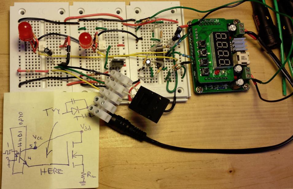

                  To measure switching speed capability, drive an Emiter resistor with Vcc. Look at Base drive signal Vs. the switching on and off you see across the Emitter Load Resistor. Next put any FET or BiPolar in Darlington fashion like the H11D1 to DB243 is, no components between, and use the same load resistor driven with same Vcc or Vdd and observe the reactive elements of the semiconductor seriously degrading the fall-time only. Not the rise-time. Base signal rise same as Emitter signal rise. Not so with fall times, unless you are driving a resistor. Please try this with your O'Scope and show me how it is supposed to look, resistor Vs. the DB243 your H11D1 is driving. Please show your schematic as I have linked what I used and posted scope shots too.
                  Can you please show the switching configuration you just advise for me, which you have wired up? Also, anyone else showing this Rx being applied successfully in this forum? I tried a 1N4004 with 1uF elctrolytic, them tantilum in parallel, and for these values and parts, they definitely do not address the fall-times i showed in scope shots. Please forgive my many newb questions or if i sound rude. My desire is to find examples being applied here, not out there, for solid state switching, as fast as possible, without IGBT's.

                          Huh? Why not? 3-Prong to 2-Prong Ground Adapter will isolate your scope Gnd. If you are to measure 220VAC, you need a 1:1 Isolation Toroidal Transformer. Do you have a 3 to 2 Prong Gnd Adapter so you can see safely, without electrocuting yourself or using a breadboard so no changing what you already soldered up (pics? links to pics of your stuff?)
Name:	How To Measure Switching Speeds  BiPolar or FET.jpg
                          You have been here longer than I. You are chasing high-voltage stimuli because you are not seeing your results are limited by crappy turn-off times. Back EMF is way way way higher, and magnet repulsion too, away from energizer coil, when turning Off very fast. Hang a Cap on your switching output to Gnd and feed your Energizer coil from that and you will see performance crumble because the SG is turning Off even more slowly. The only benefit from Fast forward EMF is attracting the magnet because the over-shoot reaction at rise-time is so tiny. This is why the Blocking Oscillator is so popular for sharp turn Off applications using asynchronous timing. The SG outputs 1N4007 diode passes whatever bucking 'energy' that is not used to repel magnet as a charging pulse that would have been heat-loss otherwise. Key word is "Pulse". Sharp. Fast. If you minimize BEMF with pulse motor designed to capture it, what do you think??
                          Can't you see this Scotty? We do not need "More Power". We need Faster switching. Do some tests and see fast rise-time is worthless when compared to fast fall-time. It really is "ALL about the Pulse".
                          I only tried the speed-up Cap in series with Q2 Base drive of this Darlington type config with H11D1 to DB243 like yiu use, and to an IRFP250 instead. My photo shows the load resistors on Emmiter / Source of each. Measure between H11D1 and either kind of Trani. Show me how you made it better please. Thank you in advance.

                              what is that i see over the diode connected to the base? is that an electrolytic cap?
                              whats that arrow from the diode cap doing? and why is there a mosfet in the diagram not a BJT?
                              im so confused
