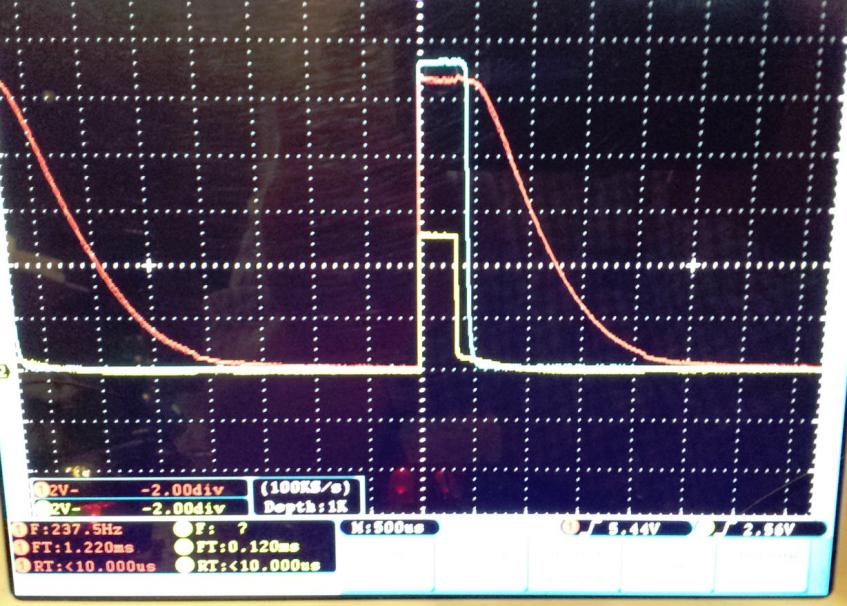

                    So Farraday, as my first responder, please mentor me! See my scope shots of very poor t-fall times from these trani's: http://www.energyscienceforum.com/sh...ll=1#post16909
                    I cannot find another soul on Earth who will put two wires together, and the more electronics people know, the less interested they are in Bedini Tech or even OU. I need mentoring help, and I have lots of other knowledge to share back with. I am gonna die soon, and this is my only wish before I keel over dead: To make the SG that charges "Both" batteries, and the Tesla Switch(es) that does not drain batteries. Faster switching Off is needed. I am now considering buying some MJL21193 PNP's to use Active-Shut-Off to force these MJL21194's to turn off "Well". NPN for same active-turn-on, but add PNP is series for active-shut-off so we can get some "Real BIG BEMF". The Blocking Oscillator is favored for that job in many places. Off is 10X more important than On for Back EMF, and that is not happening in the Beginners SG Handbook, "Approved by John Bedini". Hmmm.? Hmmm...
                    Until later Mr. Faraday88

                        It is John Bedini's Tesla Switch schematic shared by John Koorn in this threat Post #6, I should have linked bask to it, sorry. Here:
                        http://www.energyscienceforum.com/sh...full=1#post815 "Here is John Bedini's version of the circuit using opto-couplers:" John says there.
                        also:
                        Here is John Bedini's version of the circuit using opto-couplers: John Bedini says here: "Here is the fix for the SG 3524N," However, Rt should be 1M Pot, and Ct should be 0.1uF up to as high as 0.5 to 0.6uF before it starts stalling. 33K to 43K in series with Duty-Cycle Pot prevents < 1&#37; d-cycle from making signal disappear. Oh ya, I was carpel-tunneled out after soldering together 2nd SG3524 PWM, then saw this EBay SG3524 for $2.21, needing onlt removal of Rt and Ct to expand lower frequency below 1KHz. I am waiting for two in the mail now.
                        The H11D1 to DB243 is using the LED for optical de-couple, and is why H11D1's Trani cannot be biased in the Tip120 way with 8K R1 to Q1 Base, and 120Ohm to Q2 Base. PLease show me how you have learned to make these switch Off faster? For low-power system, I am already using IRFP250's in parallel for one-battery Tesla Switch. It really works, but really runs batteries down. I will feed it some relays and try it again the fastest way possible
                        Yes I tried loading Q2's base with resistors to shorted to 10K. These efforts, and Diode in parallel with 1uF Capacitor do absolutely nothing, and do not improve fall-time. Please show me how you do it so well, with FET's and Bi-Polar.

                          where are you measuring the rise and fall? across the transistor yes? that looks like a capacitor discharge curve, i dont really know where to begin, its got a 1uf cap across the diode see what effect removing / doubling has on rise and fall?

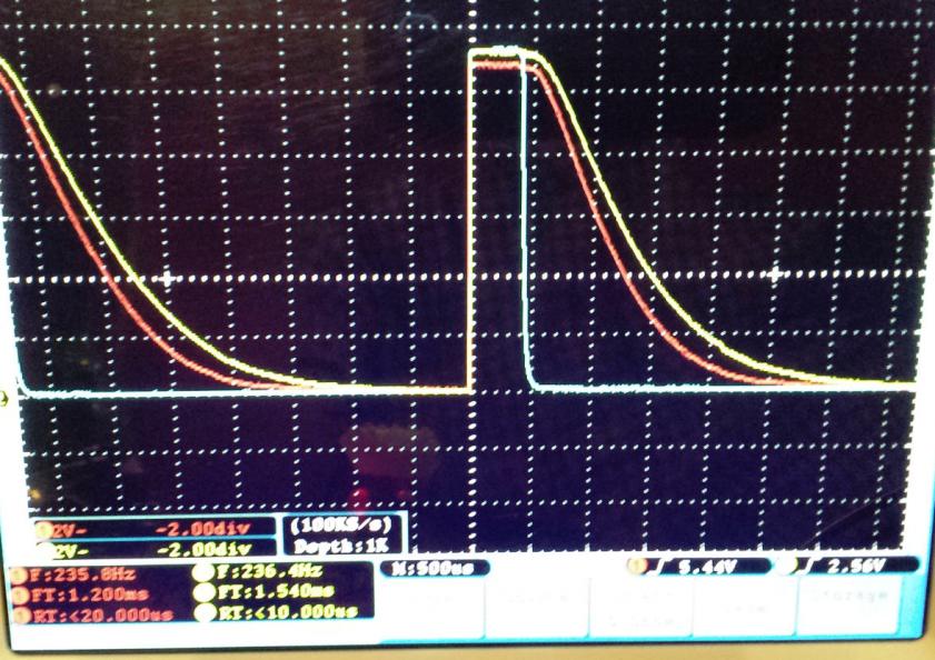

                            Hello BigMotherWhale.
                            I measured with respect to Gnd at H11D1 input (yellow trace without slow fall-time), H11D1's Emitter driving: 1) a simple 10K resistor, 2) a DB243 driving another resistor, and 3) an MJL21194. Yes it does look capacitive, but I consider now this is likely typical of any transistor run in saturation mode. The conductive region does not turn off as fast as it does on, because Off depends on relaxation instead of energizing. The names in the files I just attached here have the traces defined in the file name.
                            To preserve duty-cycle, cannot just tie NPN to PNP sharing same Base signal, else they will just oppose each other, always. The Normally On PNP must be driven differently somehow, maybe with some inverted signal, considered only while the original Base signal is high for a negative edge detect?
                            Tell me please, are you and other seniors here "Really" still using just one NPN with super-slow turn off in a system designed around creating Back EMF??? Is anyone at this forum showing the NPN and PNP, or N & P-Channel FET's in series to address this fundamental problem? What rig have you built and for how long?
                            About your other comment; It was the intentional obscuring of the "Real" best known methods that made me start skipping meals and sleep to sift through the true and false. I almost died from exhaustion, and that is what opened the doors. I did not ask for it or seek it. I could not stop it. This in context of not completing my build of BB's TPU which you asked about. For me it revealed the mechanisms by which the unseen is perceived, and I found the beat frequency induced state similar to the dual-frequency CD's you can buy for mood altering where each ear hears only one frequency that is a few Hz different than the other, where the differences are between 0 and 20 Hz, where the brain waves activities operate. Take note, the Holy Spirit is the Only Spirit we are allowed to try to contact. It is written. Every day I ask God to fix what is wrong with me and to make me a useful and productive member of His team. I am still waiting for the finish.
                            • #29
Name:	H11D1 Woes_Yellow_SG3524 Blue H11D1 to 10K OUt Vs Red MJL21194 Out-LowRes.jpg
ID:	46504Click image for larger version
Name:	H11D1 Woes Blue H11D1 to 10K Red MJL21194 Out Vs BD243 Out-LowRes.jpg
                              Trying to attach scope shots again.
