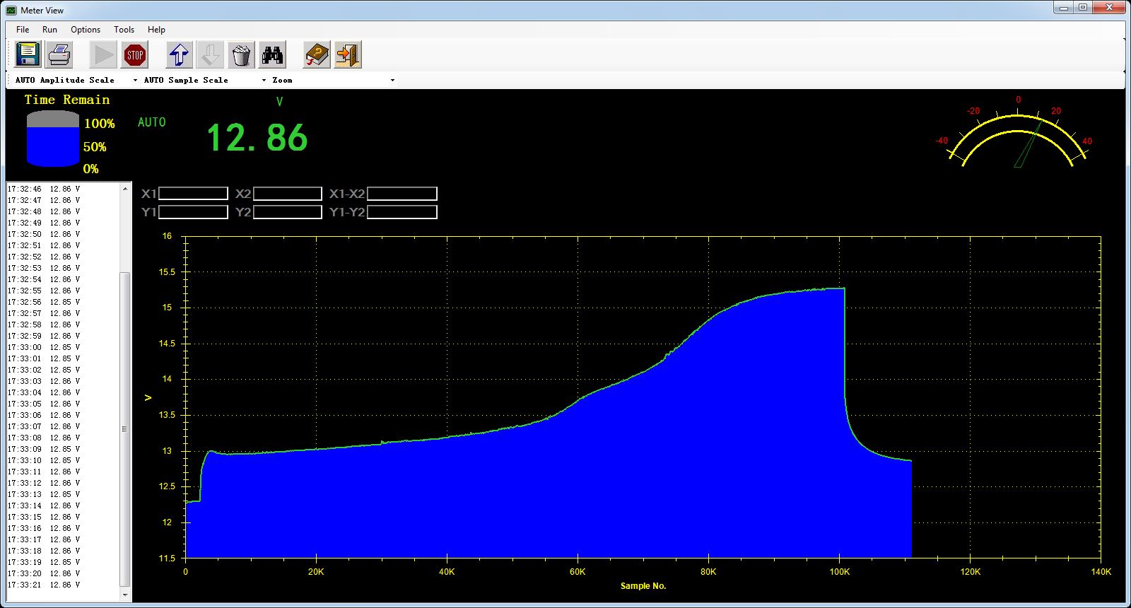

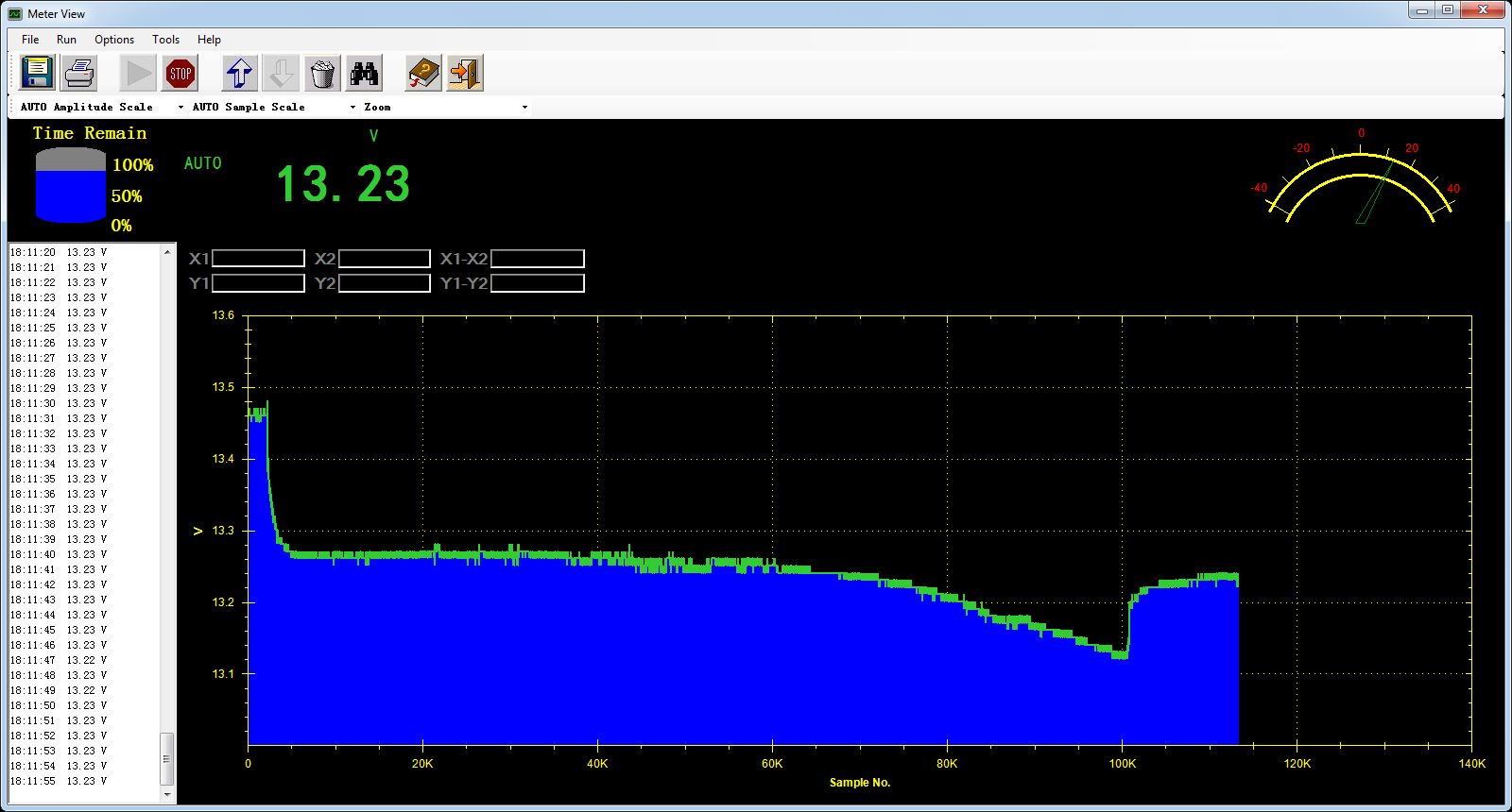

                Today I am posting a chart and video of the machine doing a mode 1 run on a garden battery.
                Draw is about 700ma and it was about 27 hours but I actually let it run a bit longer than it needed too. This is teh build version exactly as described in the builder notes, SSR with 3 sets of coils in series/parallel.
Name:	BZ-9 pole mode1 chg.JPG
Name:	BZ-9 pole mode1 Pri.JPG

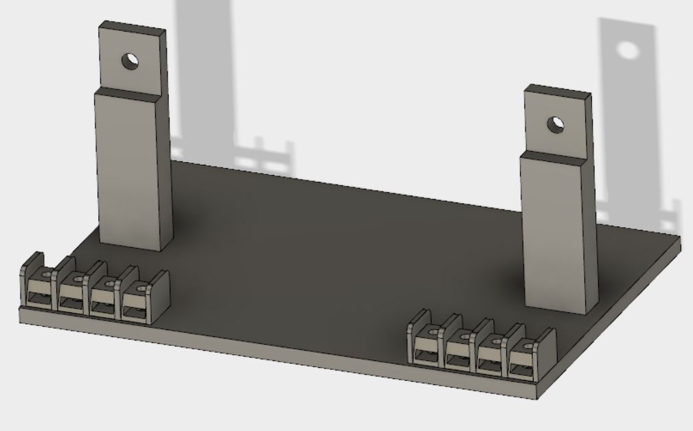

                          Everyone I am posting an optional file to the folder for this machine "DeckwTblock". This deck has terminal blocks built into the file and you just need some #8 screws/washers and some square nuts to slip in for anchoring the screw. It saves some space and money compared to the store bought terminal blocks.
                          Generally speaking you want to always check the folders before you start printing the model because I may add things. With this new file I would recommend printing the version with T blocks for the front and the original for the back.
                          Here is the link to the folder again, this has been posted already in this thread and does not change as things get added.
                          https://1drv.ms/f/s!AmzmftzD-V0miHNbZQMvNTgPddSR
                          Here is the optional deck:

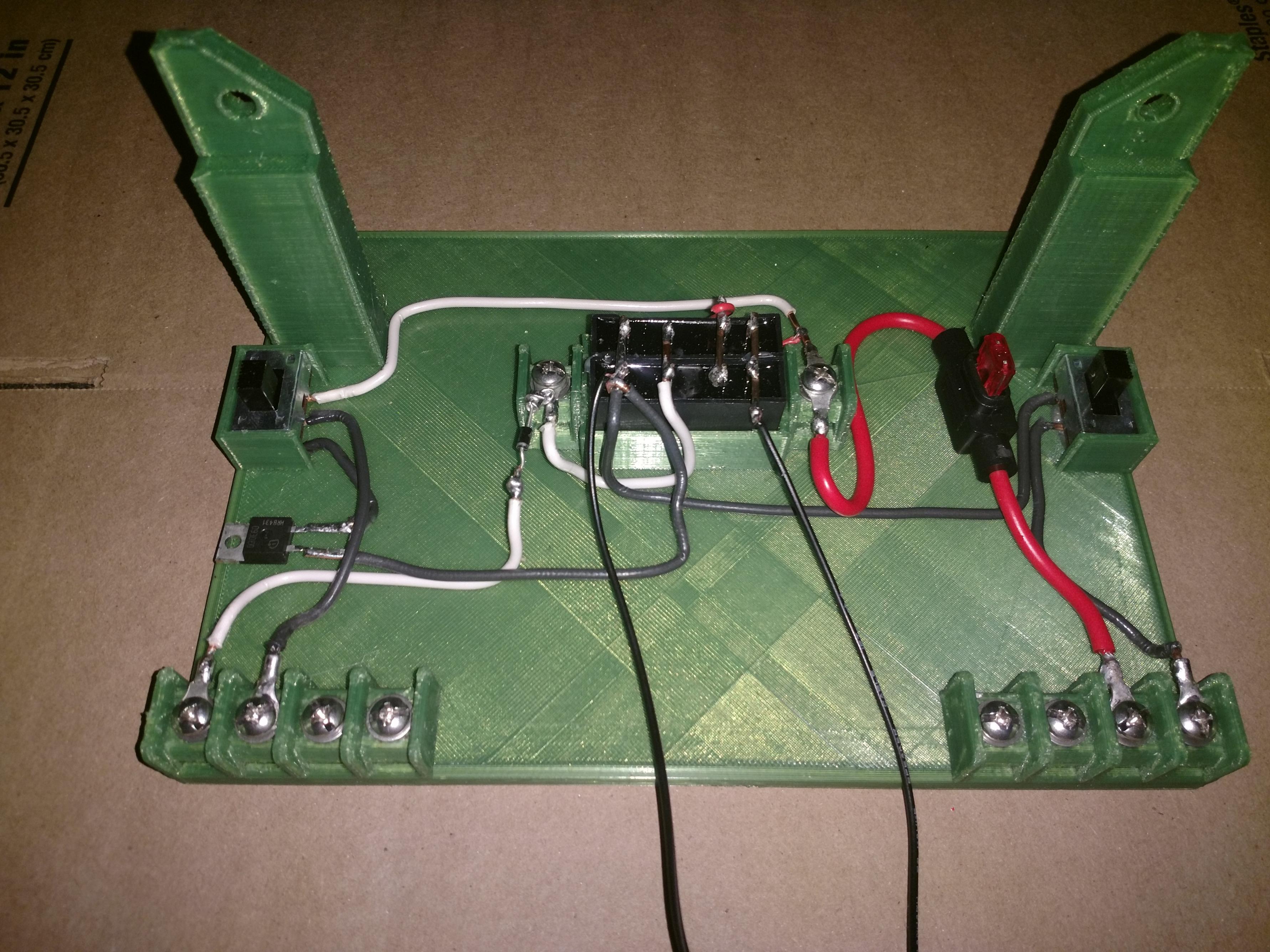

                                Here is a picture of one I finished building tonight with the cheap SSR's. It's not tested yet but should be fine. I will just have to unhook the coils from the old deck and unbolt it and put his one on instead.
                                Here is a short video I shot where I am explaining how the circuits are hooked up. If anyone grabbed the old files I would just scrap them and download the latest version. Many of them are the same anyway but I'm just saying the folder has been updated with new stuff that has had more scrutiny by me.
