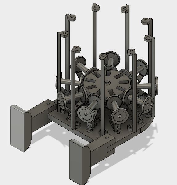

    I have been working on a new machine design in Fusion360 and I thought I would start a thread for this project.
    This will be a nine pole mechanical setup. The coils are about 2 inches tall, it's a pretty small machine. Each frame upright accommodates 9 coils so the initial design can have up to 18 coils and then I could build it back with more uprights and a longer axle but I'm not sure if that will be necessary. The magnets are going to be in super-pole configuration on the front and maybe a genny setup on the back with wider magnets, haven't decided on it yet. I will most likely use SSR and reeds for the switching.
    I have never used a 3D printer before so I am hoping I have not gone too overboard with the design. I plan to do it in ABS filament and use nylon bolts everywhere possible. My printer was supposed to already be ready but they sent me a kit instead of the assembled model I paid for so I had to send it back and they are shipping me the correct one Which should arrive sometime next week.
    Here are some pictures from the design software:

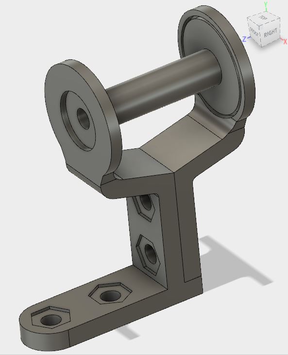

Name:	Bobs 3D spool Mount.JPG
    The last one is what I came up with for coil mounts, this was probably the hardest part to get right.

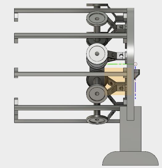

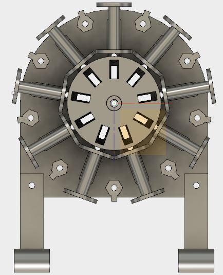

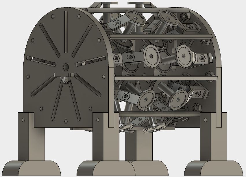

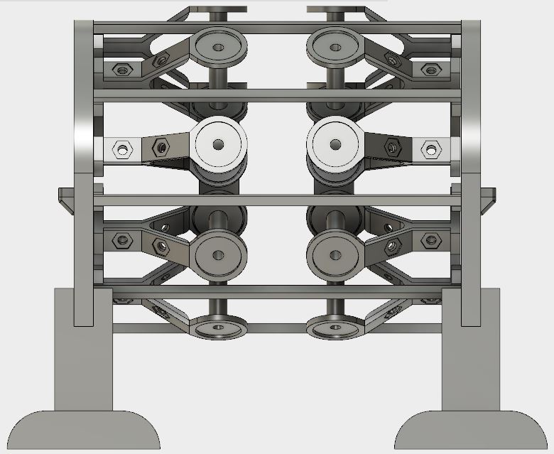

    I discovered when I did a full mock up that a few things needed adjustment.
    Here is how it should basically look with all the parts.
Name:	Bobs 3D angle2.JPG
Name:	Bobs 3D right2.JPG
    And I had to rework the spool holder
Name:	Bobs 3D spool Mount 2.JPG

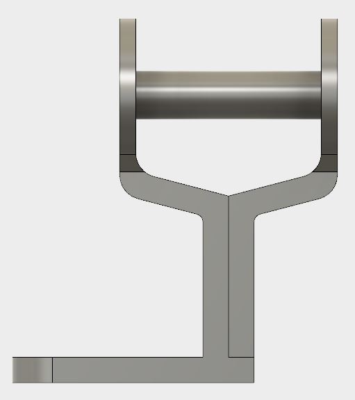

        My only suggestion would be a small change to the spool holder by making it in two pieces rather than three. The base and one side could be made in one piece which might make it stronger, and the other side would be the other piece. So instead of bolting three pieces together you would only have to bolt two pieces together.

          Gary I think your right on that spool mount. I am going to try making a simplified 2 piece version. I had concerns about it's strength when I was looking at it too, Funny how our brains work sometimes, as soon as I figured out that "mirror" tool I was committed to what I came up with. I think I was just stuck on the idea of the same part just flipped over but DUH,, 2 pieces is a great idea. I'm also not sure on the spool core size, I might widen that up a bit but it's going to take some tinkering once I have at least a single coil machine from these plans up and running.

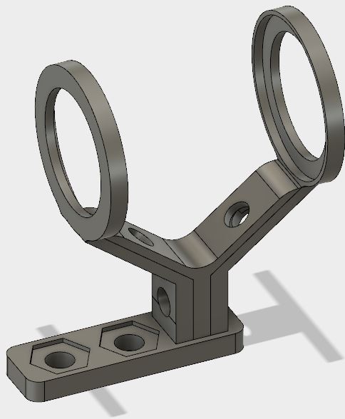

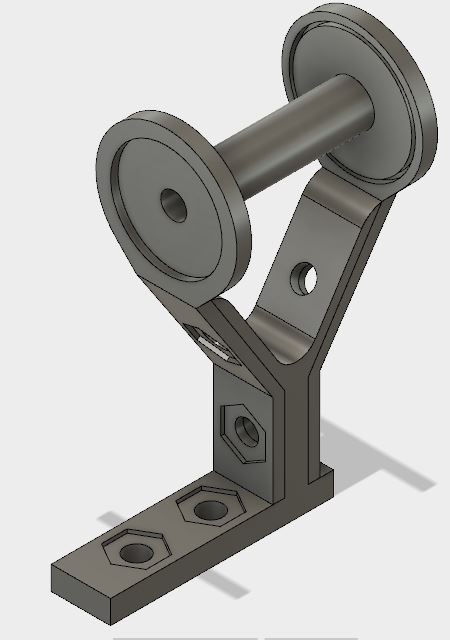

            New version of the spool holder after Gary's suggestion.
Name:	Bobs 3D spool  Mount v2 side.JPG
Name:	Bobs 3D spool  Mount v2 angle.JPG
            Those bolt holes are basically for 1/4inch nylon bolts and nuts. I keep looking at them and wondering if maybe it would be better to use some smaller brass screws like M4 with a flange washer. I could see either working nicely but it's getting to be decision time because I need to order all the parts soon like bearings screws and such.
              Hi Bob,
              That looks a little stronger to me. For the screws you could use nylon, brass, or stainless. And you would only need one screw at each location if you printed in some locking tabs and slots for alignment as well.

                Maybe I should call this Gary's machine ,, Just kidding. I really appreciate your input Gary! You are right once again. I think I will try like built in pegs on the top piece that slide down into the bottom with a bolt through the middle, or maybe like a dimple kind of thing. I get what your saying though.
                I know why I am not seeing some of these design modifications on my own. I have to change my thinking. I have designed a lot of stuff, way more than the finished products you guys have seen in the past that I had fabricated, but it was always with plate metal in mind. Basically pick the thickness and add holes and bends and cuts. This extrusion element really brings out so many more possibilities than I had with the machine shop plans. I mean yes it was possible to make parts more 3D but the cost would always be way too much. Like starting with a 1/2 inch thick material and removing 1/4 inch of most of it just to make a post at a 90 degree from the finished surface. With this 3D printing your not removing all of that material but just building it up where you want, I'm not used to thinking that way.

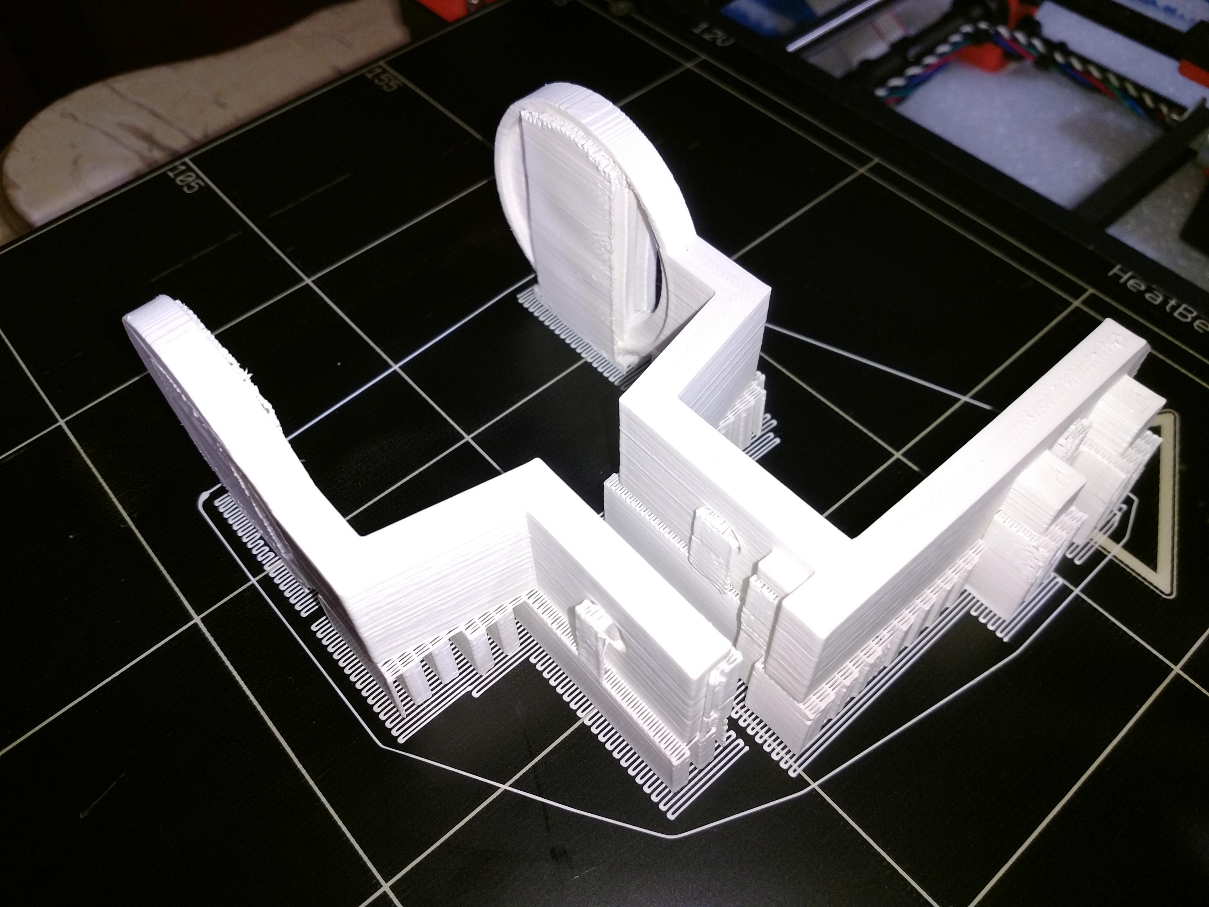

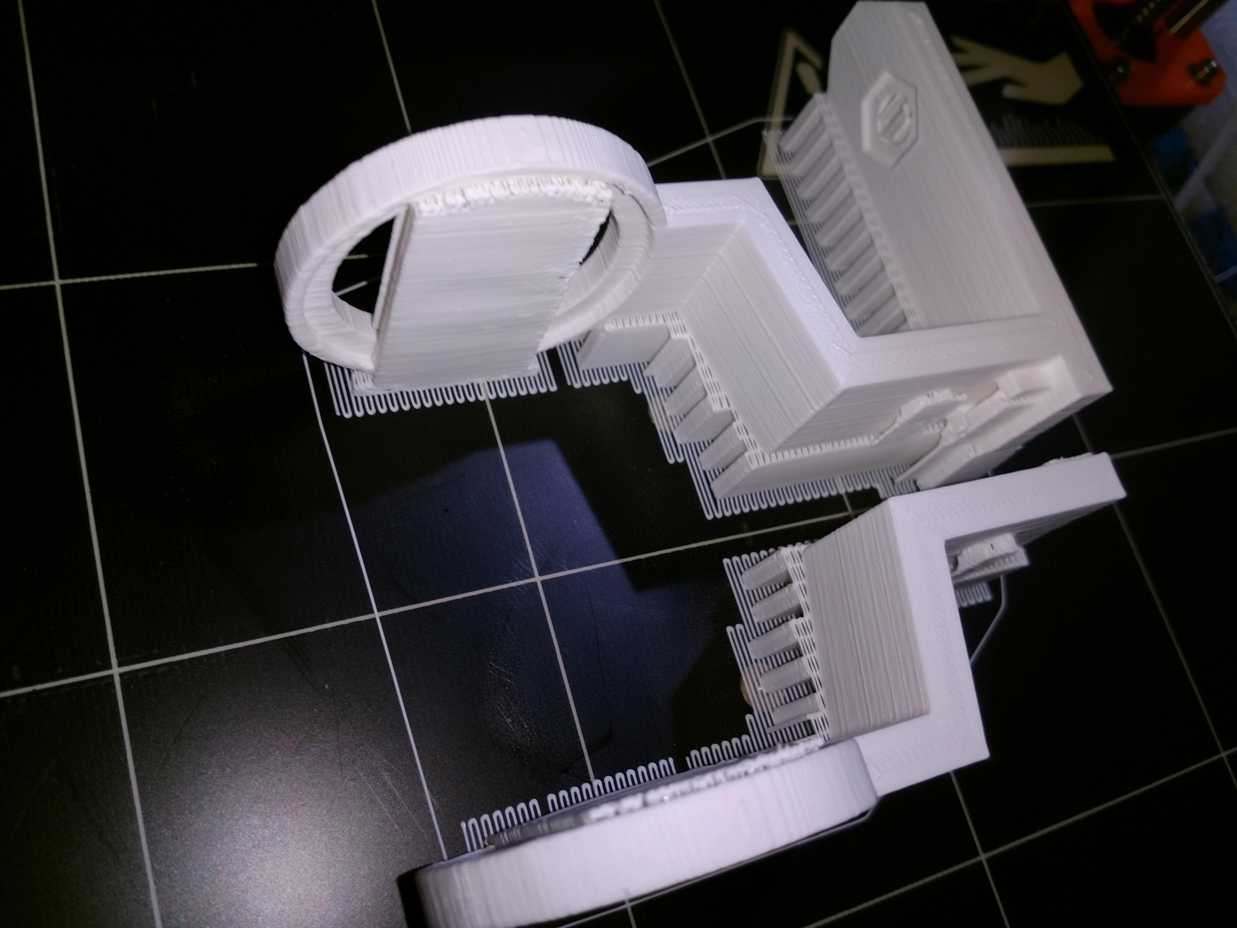

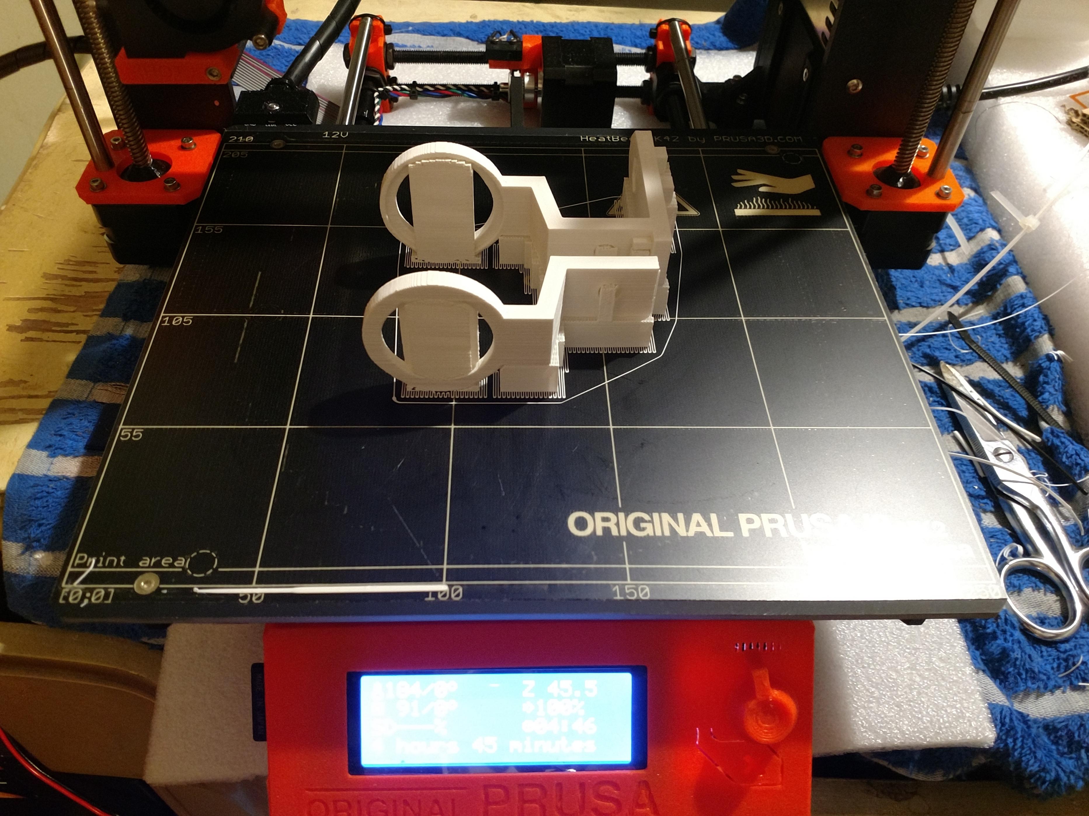

                  Good news,
                  I have my printer up and running now and I just printed a 1st try spool holder. I am letting the bed cool right now so I have not even tried inspecting it really. I am hoping these supports come off because if not it's all for nothing lol. I can already see that I need to play with the slicer program and try to get better definition. This was basically a "normal" setting that I tweaked only a few things on, like the wall thicknesses I set to 5 instead of default 3. It's ABS filament and the temp was 255 on head and 100 on bed.
                  I'm going to clean it up tomorrow and test the bolt holes for fit and if it's good then I will start cranking out the rest of them.

                    Very Nice Bob
                    Did you get your printer already assembled?
                      Bob,
                      ABS really likes an enclosure, even just a cardboard box. check your slicer thickness, for small parts .2 MM is what I like, you can also increase the number of shells (that is the number of walls on the inner and outer surface of the parts befre it starts generating infill. let me know if you have specific questions.
                        Hey Brian,
                        Yes I did. Originally they sent me a kit by mistake so I had to go through a return process which is why I said finally got it up and running. Not because I was working on it but it was a long wait. It was on back order for a few months to begin with. Prusa is just swamped with orders.
                        It's worth noting that although I had some issues initially with them, I would still say that their customer support is TOP notch and a great company. I was a little concerned about it because they are in Czech Republic and I thought their could be problems with returns or getting help but it is quite opposite.
                        The spool holder came out decent after I cleaned it up but not perfect by any means. As I said I know there are settings I can play with to change the results but I am re-printing one right now with the same settings but I flipped the parts 90 degrees to see if they do better that way. I will show another picture when that is done and we can see the difference. Over all I am very happy with the results even as they are. It might not be perfect looking but it will perform it's function no problem.

                          You were typing your message at same time I was answering Brian... I did increase the shell from 3 to 5 on these. I didn't have any problem with warping and it stuck to the bed nicely. As I said to Brian I am trying it again with it flipped 90 degrees. I think the big circle's will like that orientation better than having to sort of bridge the whole thing together.
                          I am contemplating purchasing simplify3D for my slicer. I have seen a lot of video's and some look like it is way better but others show prints where free software beat the pants off of it so it's hard to decide if it's worth it. These were sliced with a Prusa edition of Slic3r, they did some tweaks to it to make it their own release. I might try Cura just to see how that does too.
