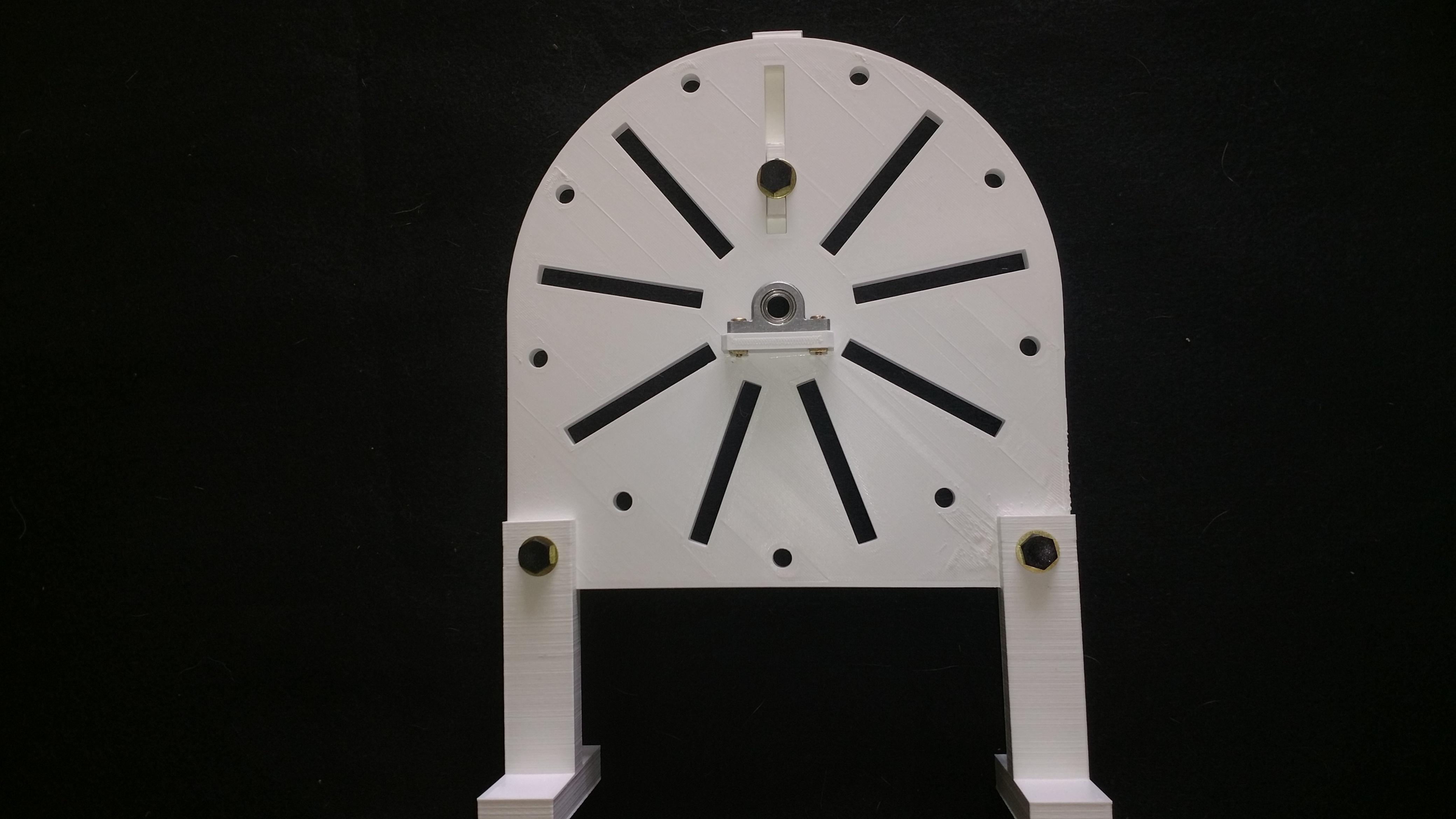

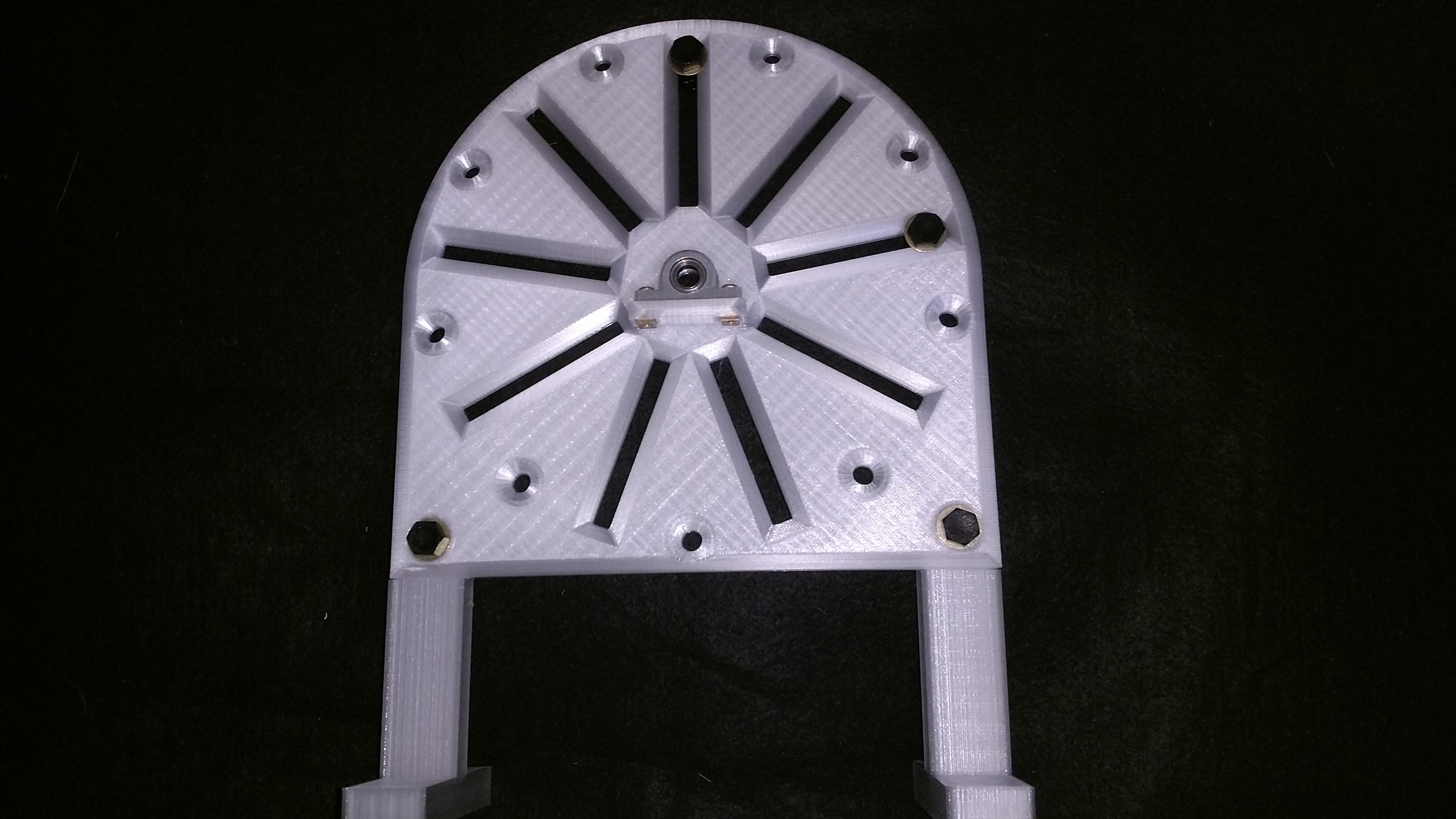

    So I spoke too soon on the ABS. My first few things had no problems but now I am starting to see some warped prints. I am gong to have to put a box around the printer as Tom suggested (thanks Tom). It must be temperature because I know that when I first started printing it was hotter, the room the printer is in has no AC so it tends to follow the temps of outdoors to some degree. If it gets hotter outside so does the room or colder the same. Well it has gotten significantly colder the last few days and then the warping started.
    Over all things are going pretty good with the project. The holes all line up so far and have clearance for the bolts. They may be a hair too large but I think I will leave them so that later on if someone trys a print on a different model that maybe prints a little different tolerance than mine it should still work. By the time you tighten the bolts up it makes no difference really, there is a little play but not much adn when tightened up it is fine.

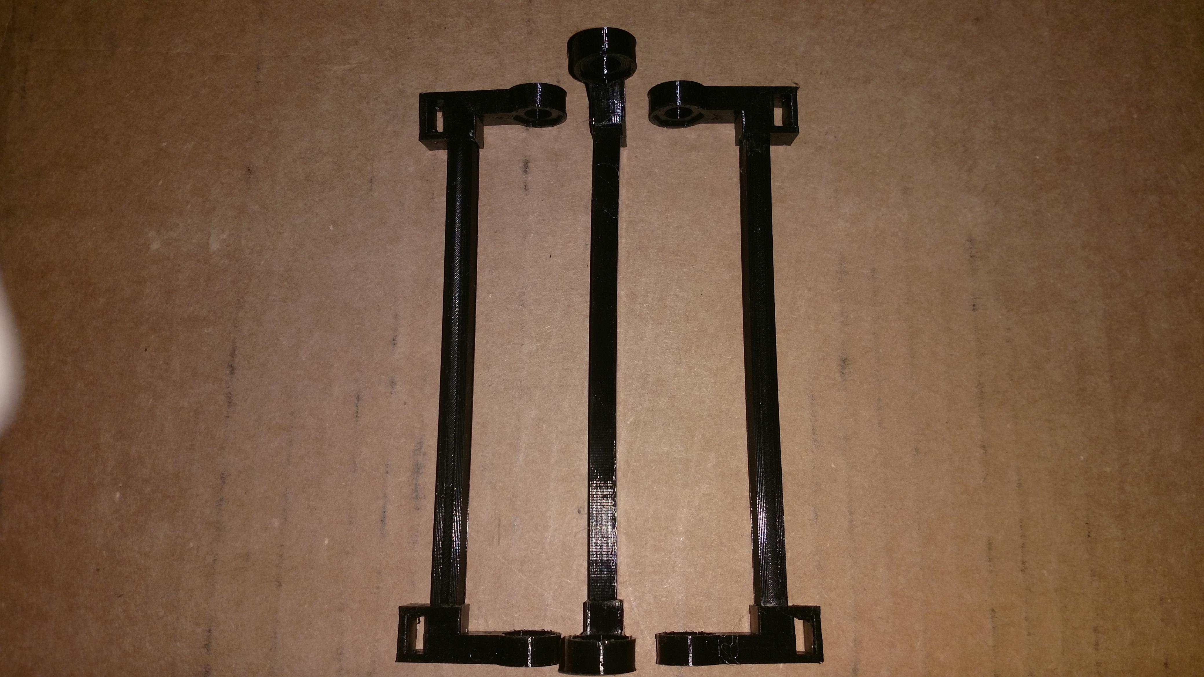

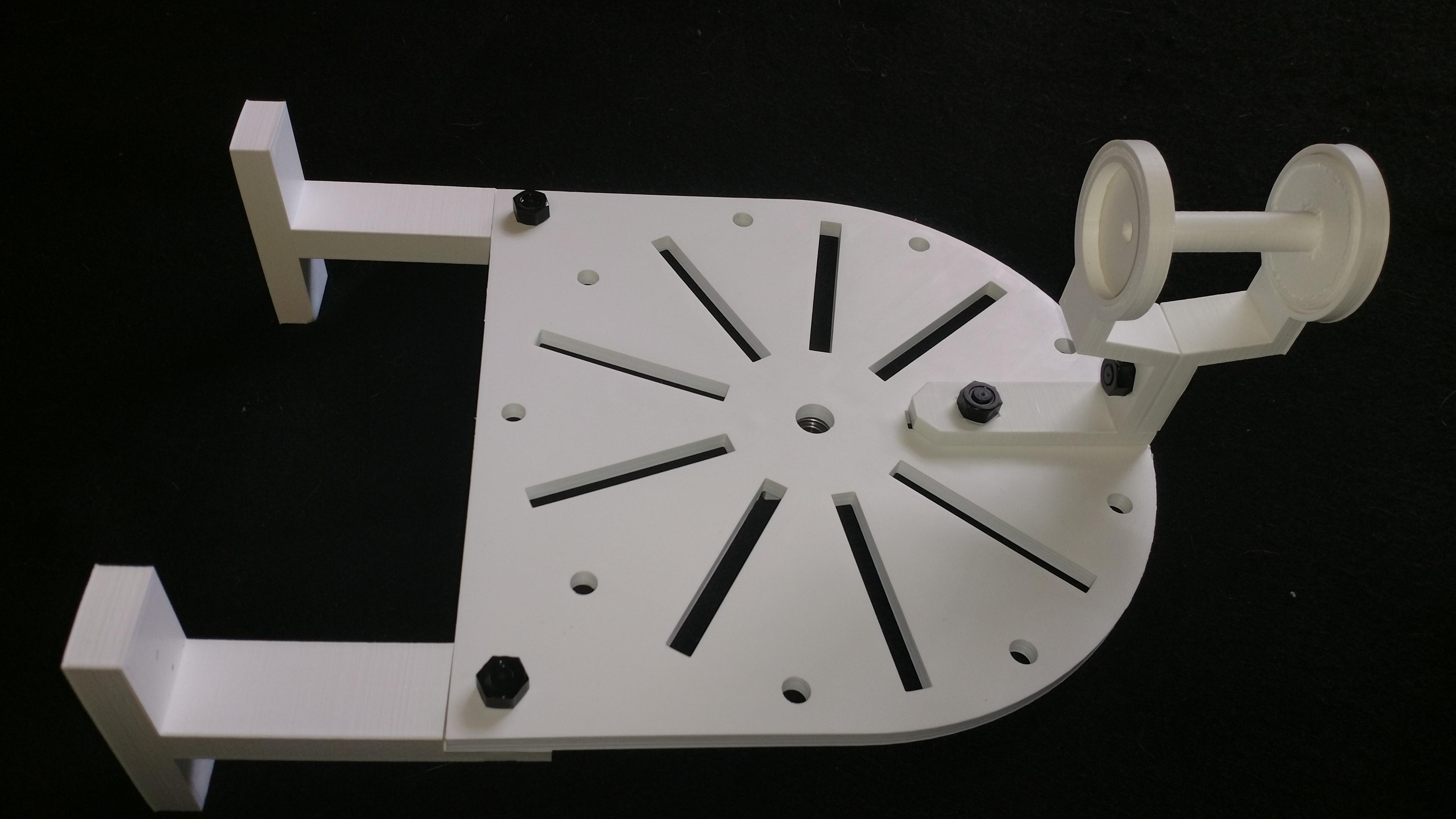

                So I got the Hatchbox petg and it also works pretty good. Below are some support rods and end caps for them. The rod was one print and the caps another and then I glued the caps on with gorilla hot glue.
                The machine is coming together nicely. I have a wheel on tonight and then I need to do all the coils and holders. I'm doing the whole thing in petg, I had some ABS stuff printed already but I want to keep it all the same material. The ABS stinks a bit too where the petg doesn't.

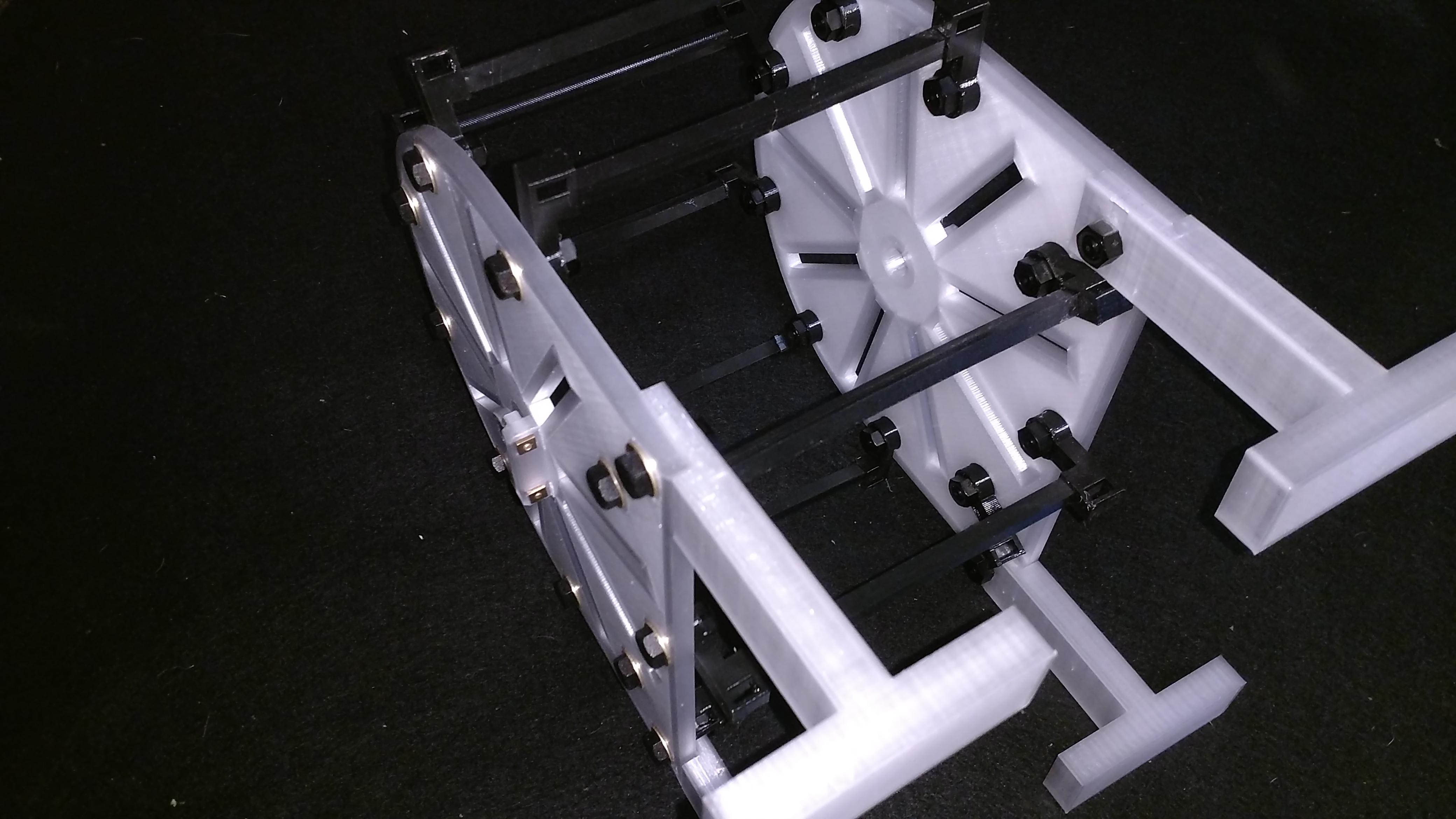

                  Here is a shot of the components as I have then now. Notice the wire guide on the support rods, I think that is a nice touch ;-)

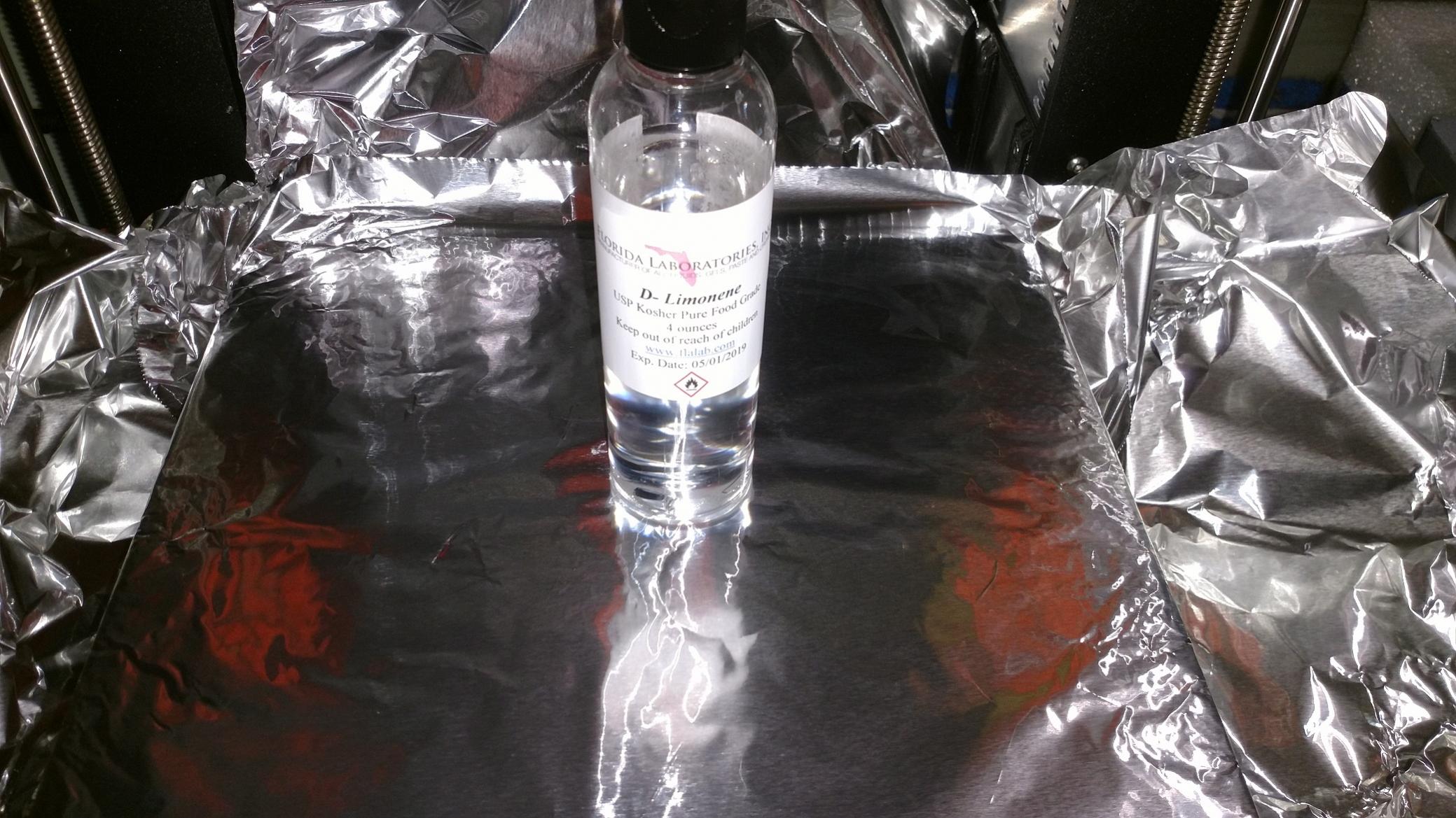

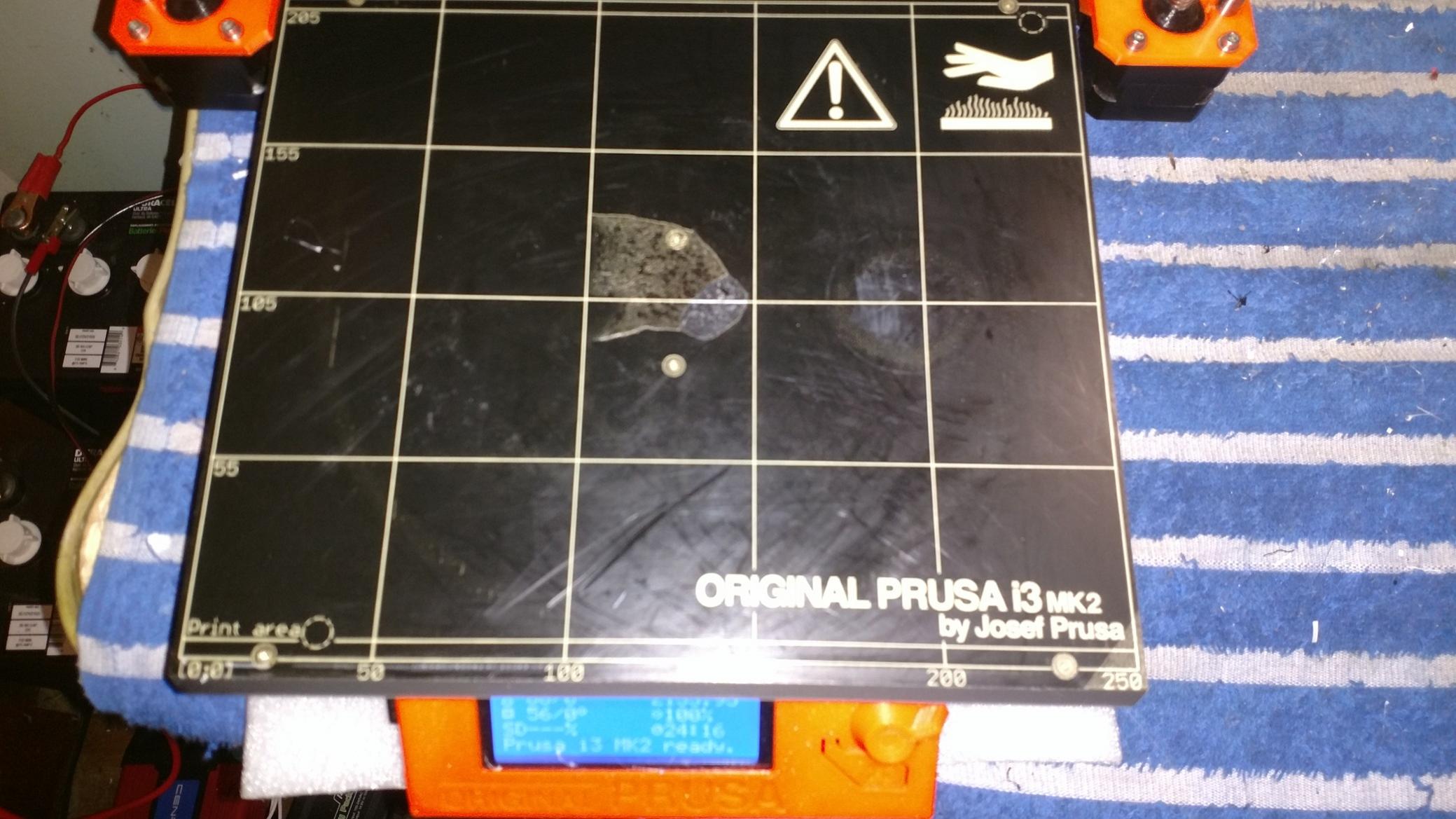

                            Here is a picture of the old damaged bed with the giant tear in the middle:
                            The first step I took was to run the pre heat function and then unload filliment and then stop heating. While the bed is still warm I pcked at the corner of the film with a spatula until I could get a grip on the film. Slowly I peeled back the old film until I had the whole thing removed. This leaves a lot of glue behind on the bed.

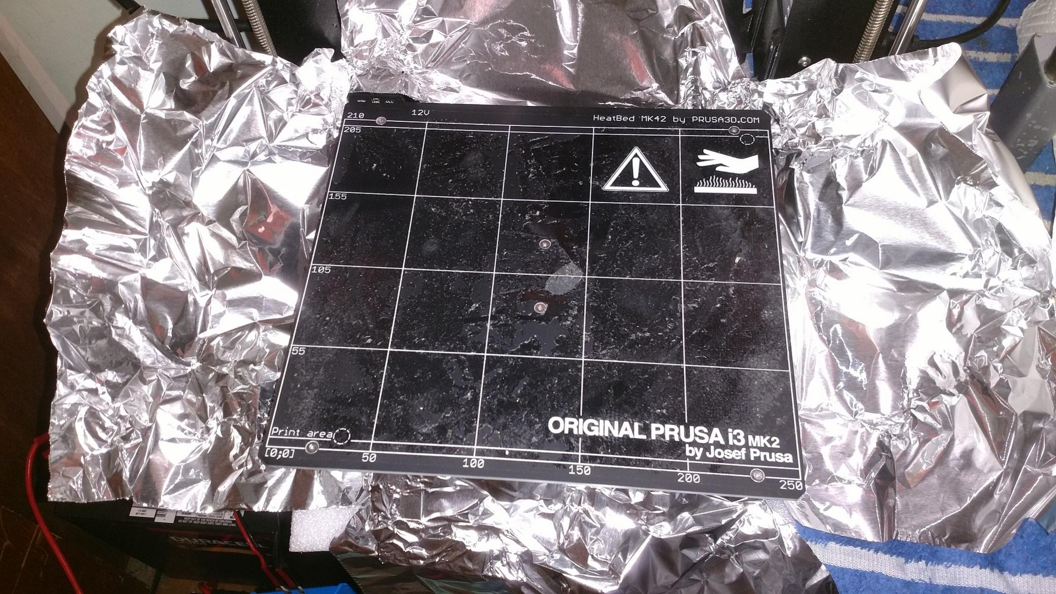

                            Here we see the bed still dirt with glue but the film removed. I took aluminum foil and made a protective covering around the bed so that in the next steps no glue or cleaner would get on the printer parts or belts:
Name:	BZ-film removed.jpg

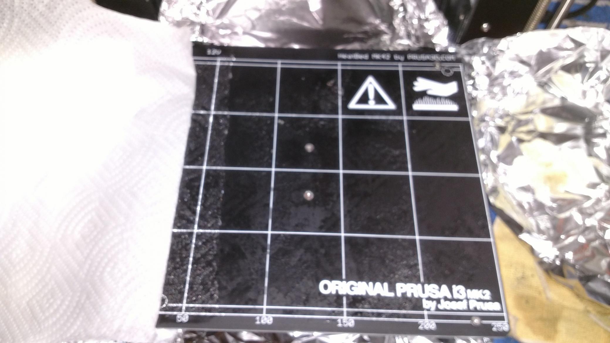

                            Next I lay a paper towel over the print bed and pour D-Limeonene (can find on ebay or amazon) over the bed and towel to just enough to saturate and cover with aluminum foil to keep it from evaporating. I let this sit for about half an hour so that the glue starts to break down.
                            This next step was repeated three times but this is a picture of the first. Once the glue is broken down I pull back the paper towel a little at a time and scrap the glue off with the spatula. You can see on the left an area not yet scraped. Notice the blob of glue on the right side on the foil cover. This is how much glue came off on the first pass. So as I said I soaked it again and did the same three times until all the glue had been removed.
Name:	BZ-glue strip.jpg
                            Finally after making sure the clean bed was free from any debris I attached the new film. Peel back only a half inch of the stcky backing and line it up properly. Then slowly press the film in place with the spatula working your way across the bed a little at a time, trying to ensure no bubbles on good adherence. Smoothing everything down as you go, maybe an inch at a time. I don't have pictures of that process but here is a shot of the new film with a first layer being printed.
