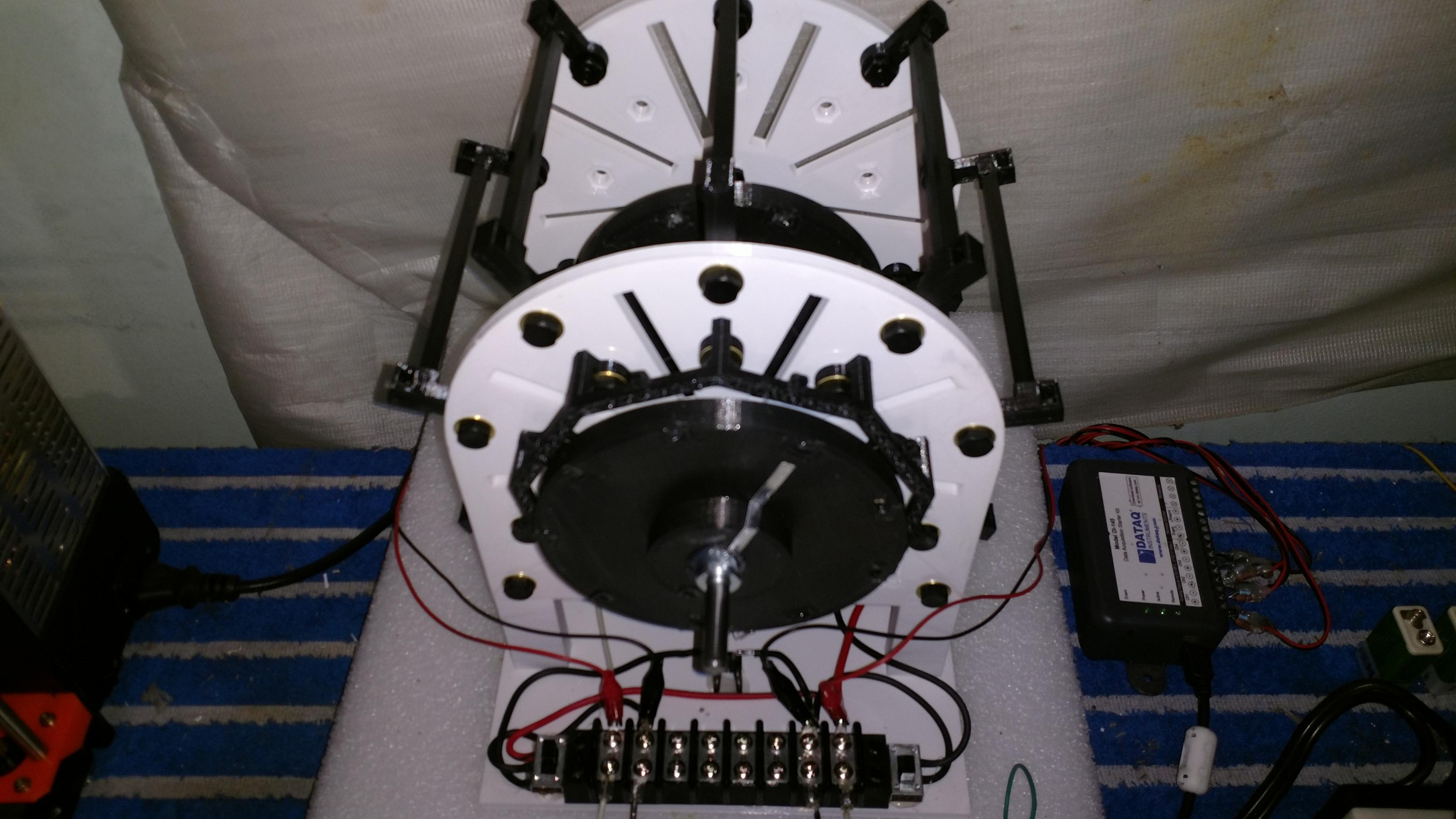

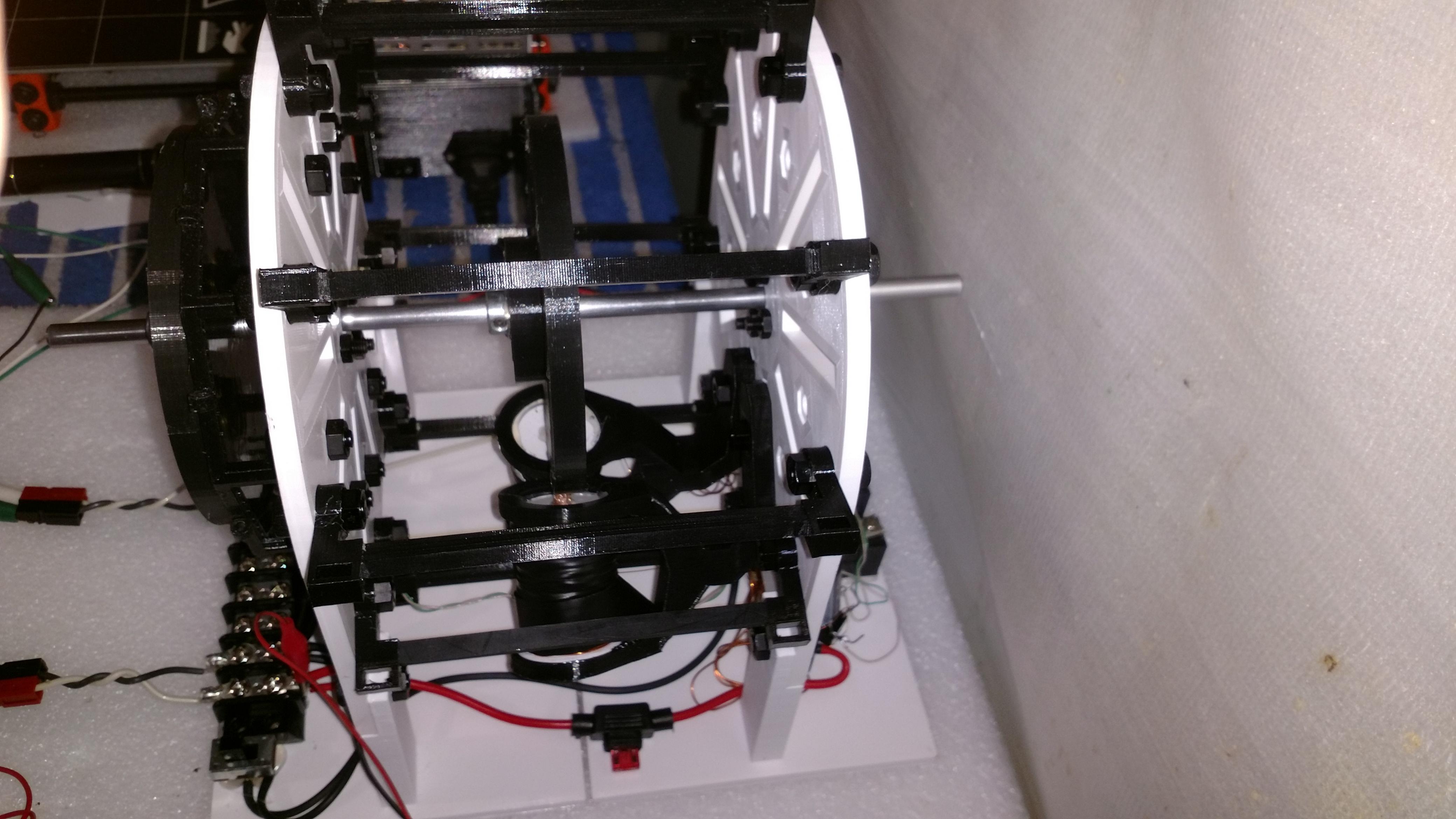

      Here are a few stills of it:
      I go over it in detail in the video so I'm going to keep the text minimal but some basic info on it:
      It has one 30awg pickup coil which is feeding the solid state relay, one 21awg power coil, the magnets are 1/4 inch X 1/8th samarium cobolt, Obviously since I just said it , the switching is on a SSR and I have mode one and common ground configured on a switch.
      The video is showing it hooked up to several sources. I started on some 18650's and then some 9volt, and finished on regular garden batteries. I wanted to show how minimalist this thing can be by using the small batteries. The video is not of a full run, it's just a few min in each battery and in each mode.
      Let me know what you think,, thanks--Bob

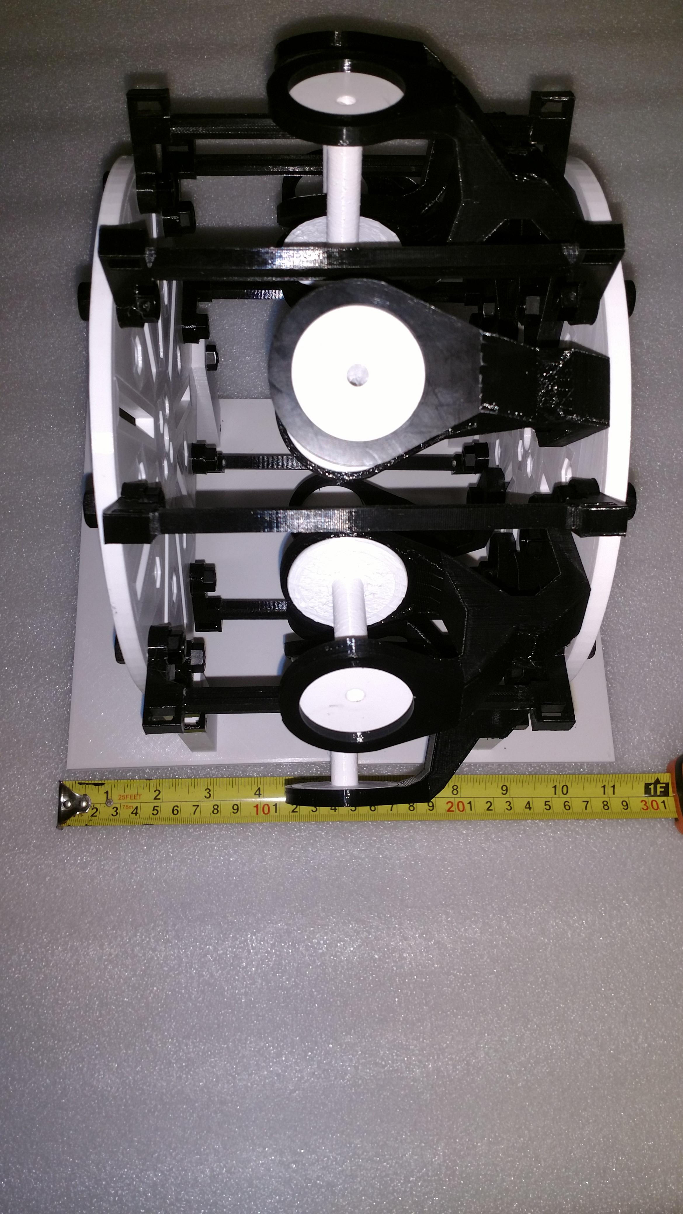

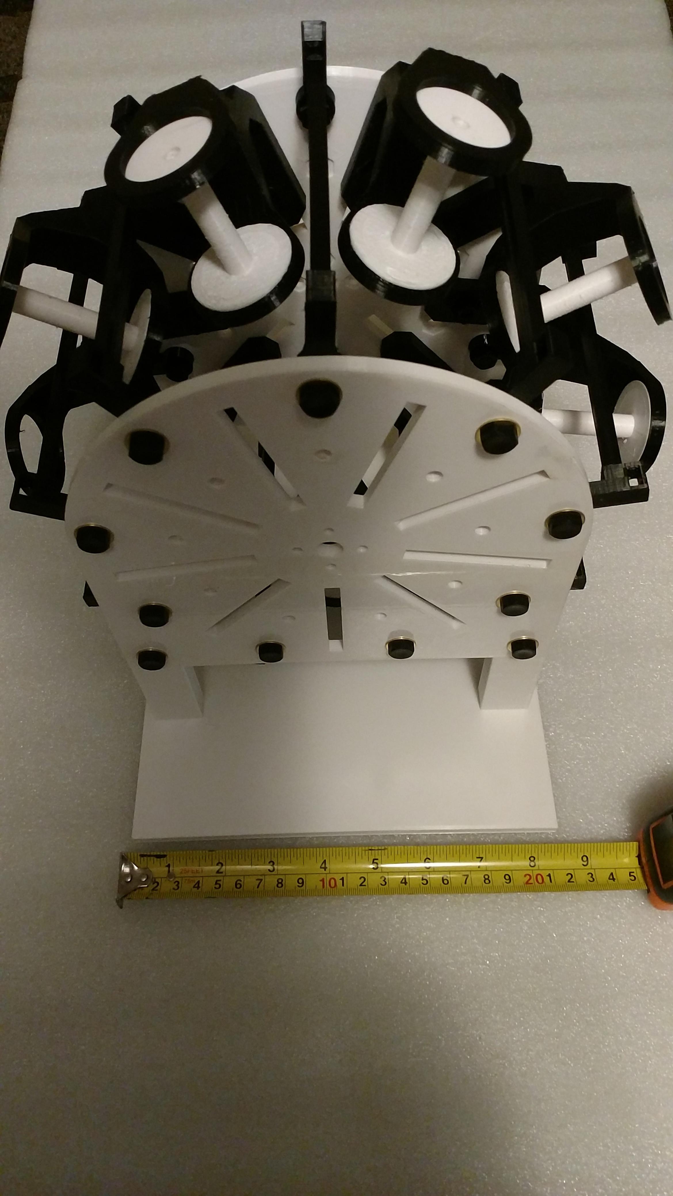

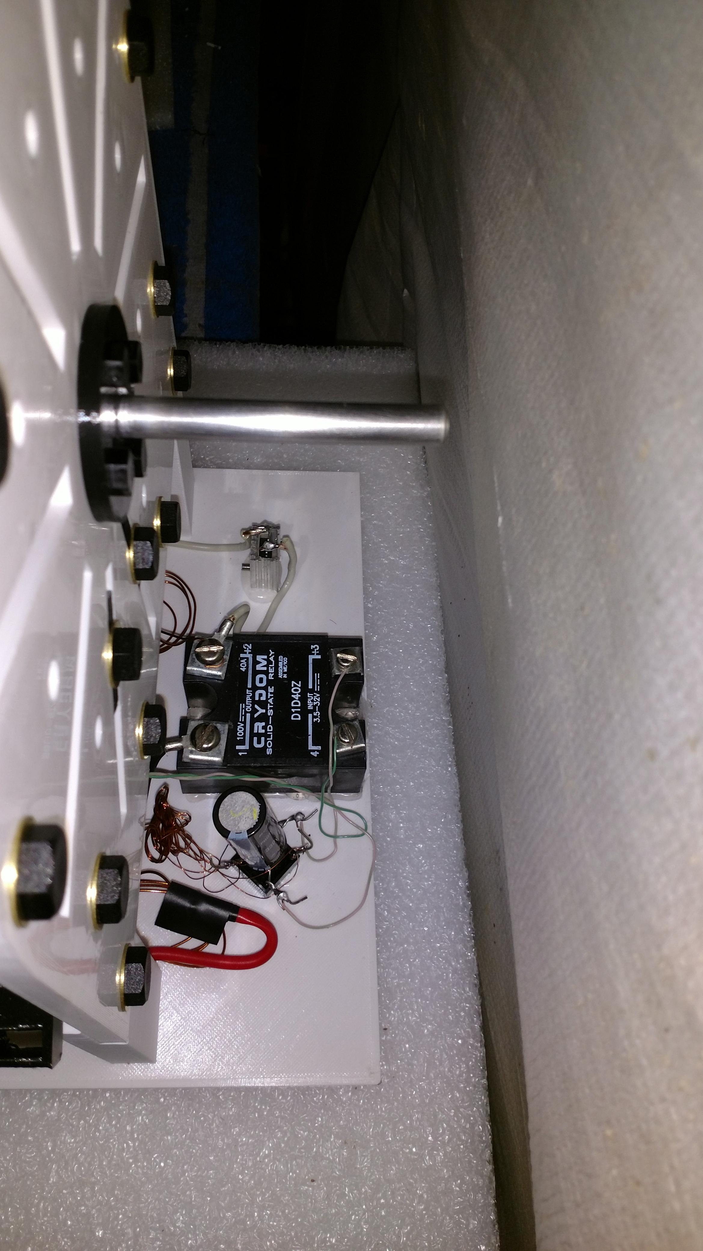

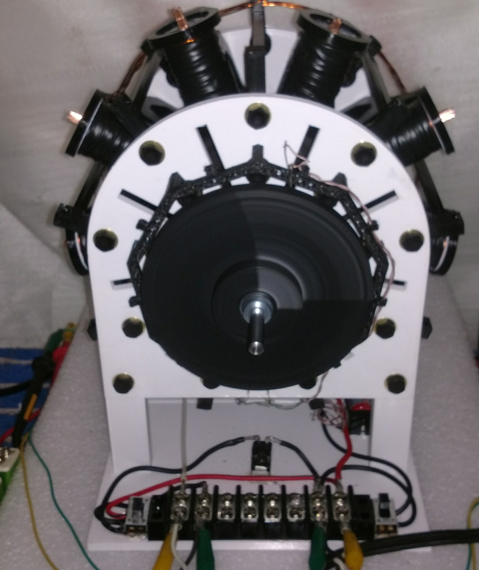

                    Posting a few pics today.
                    I have added all the coils, 8 power and one genny. I did change the circuit around a bit when I added all the coils. I now have one SSR per coil with independent diodes. I found that the genny coil setup I was driving the single SSR with was not strong enough to drive the 8 new ones so I added a 18650 battery to supply the trigger for now.
                    Brian I started a garden battery run a few hours ago and took some video so I will post something tomorrow as I monitor this run.
                    Here are a few pics of it:

                        Hello group,
                        I have changed the circuit back to a single SSR and am using the genny to supply the trigger again, how it was originally. I blew a fuse with the other configuration and suspect that one of the SSR's had shorted out but I need to take the bus bars off of the array and test them to confirm. I liked the way it ran originally so rather than muck around with the smaller relays I decided to put the large one back at least for now.

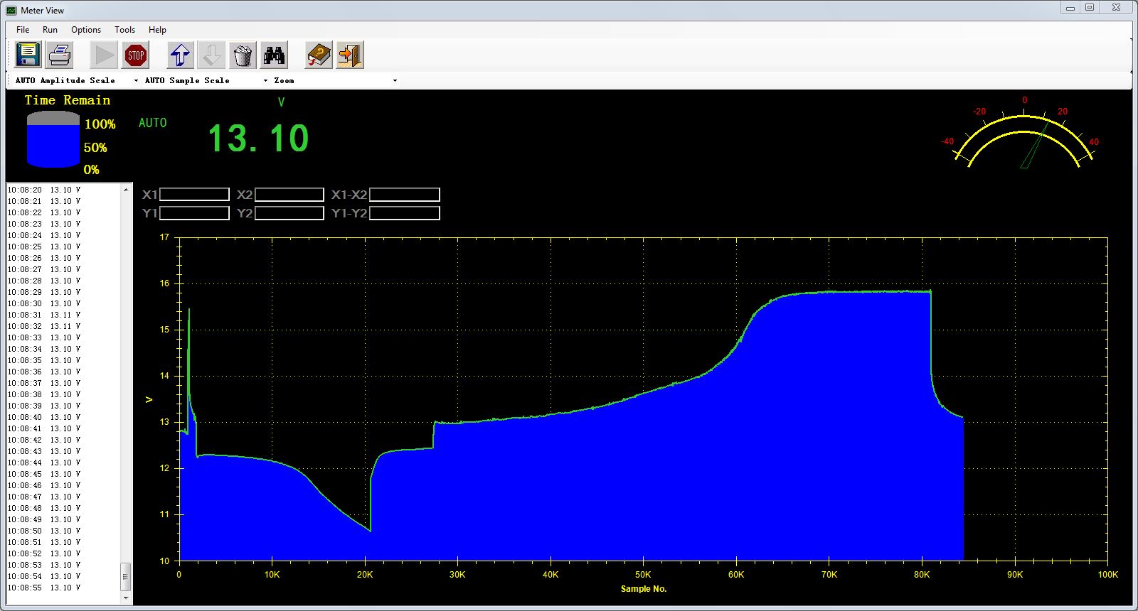

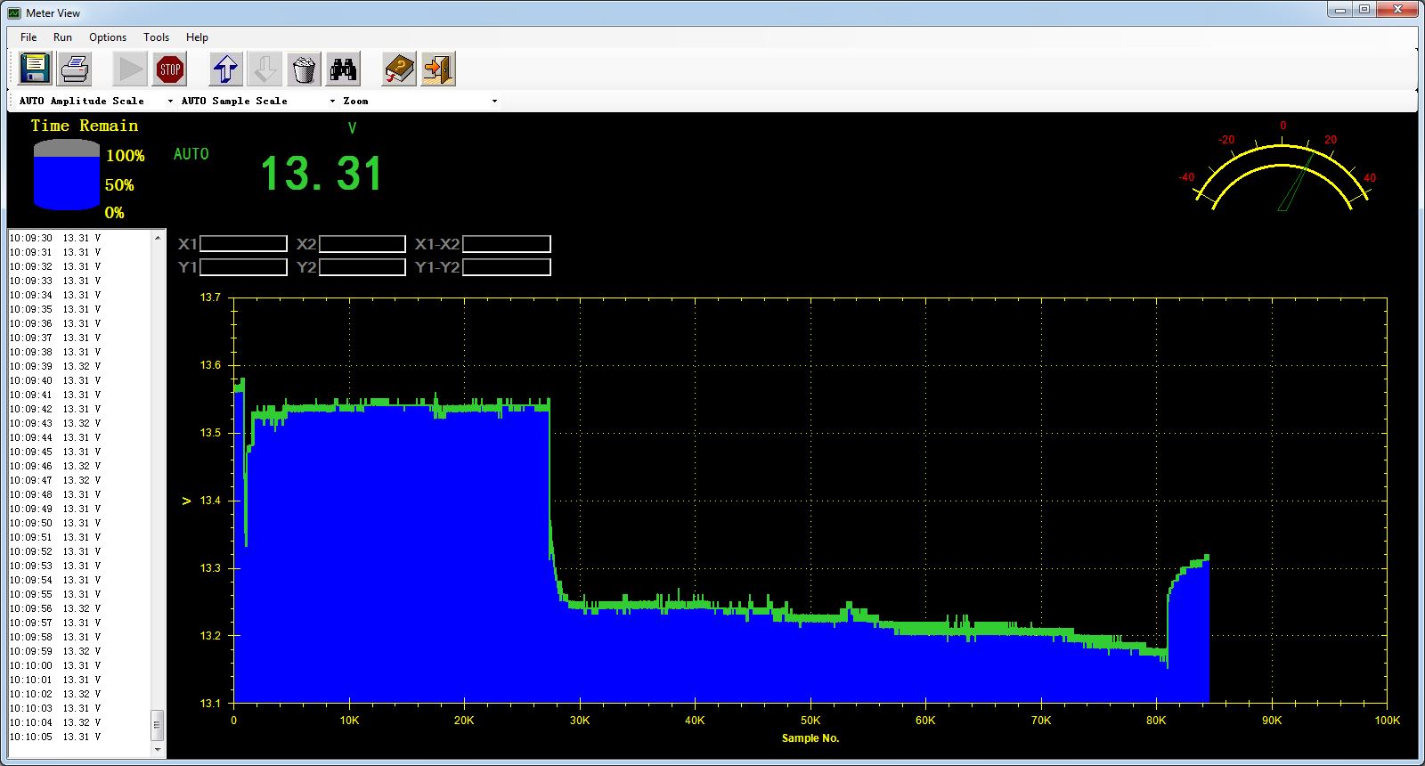

                        Today I am posting a chart and video of a full discharge/charge on a garden battery. It is explained in the video but I will give the basic info here in text also.
                        The chart shows where at first the battery is fully charged and I just gave it a quick spin up. After that I did a load test on the CBA pulling at 1A down to 10.5v. That is more like a C10 rate for such a small battery, in hindsight it may have been better to do it at a C20 rate because it sort of skews the results but this is just for fun anyway. So at the end of that the CBA reports 5.444 AH were consumed. Then I charge the battery back up in mode 1. The machine is set to draw about 1A in mode 1. I had to go to bed before it was finished charging so by the morning it had already been fully charged and was just wasting energy and keeping the back at 15.8 at which time I shut it off. I may do this type of run again and try to monitor things a bit closer and use a C20 rate on the discharge but for what it's worth I am happy with the results of this run. I have also charged much bigger batteries with the same setup but the garden is something everyone is familiar with.
