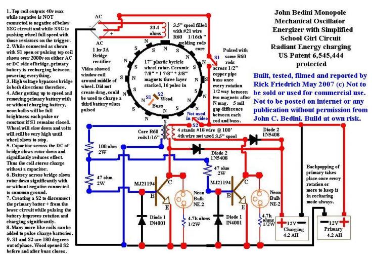

  • Tom, you're giving RF too much credit - this coast of his was NOT sending anything back to the primary as S2 disconnected the primary from the ckt completely so S1 could dump back to the primary.

    The only way to do this is as I have shown on my vid and have explained in this thread. I'll give him this... at least RF had a DPDT switch on the trigger to help prevent blown transistors. Although that's not what he used it for, many people did.

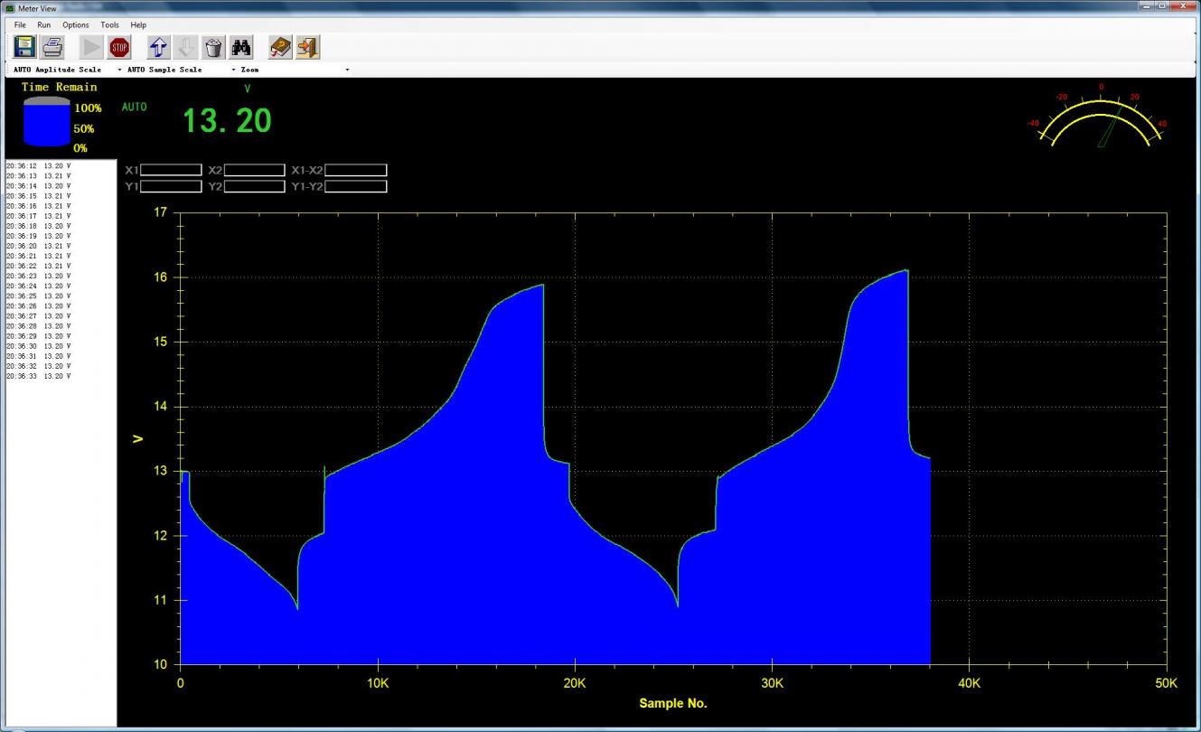

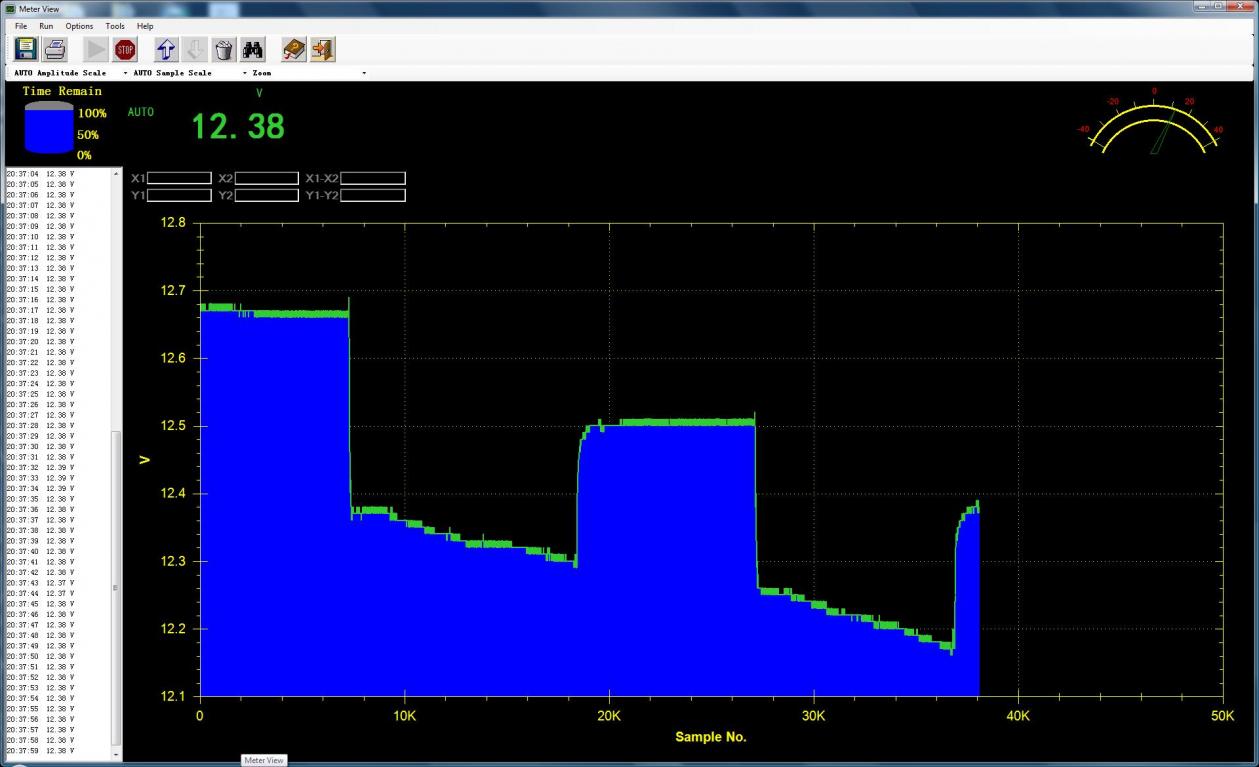

              • Ok so here is that run I spoke of.
                I did two disharge/charge cycles on a little garden battery. The machine was running at about 5A in GEN mode and the discharges were done at 5A as well.
                I say it in the video also but keep in mind that 5A is way over a c20 for such a small battery so the meter readings are not very helpful. This was mostly just to show some gen mode action on the machine.
                Here are he charts:

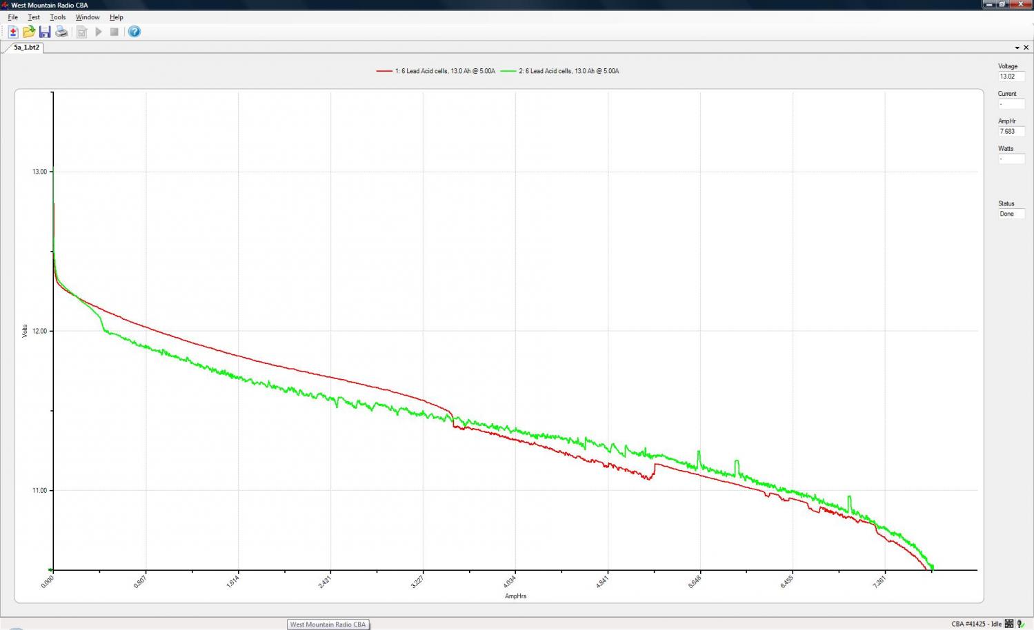

                      • yes sir that is it // the C coils tried to get the magnet to pass as deep in the C Click image for larger version
ID:	46962 as possible
