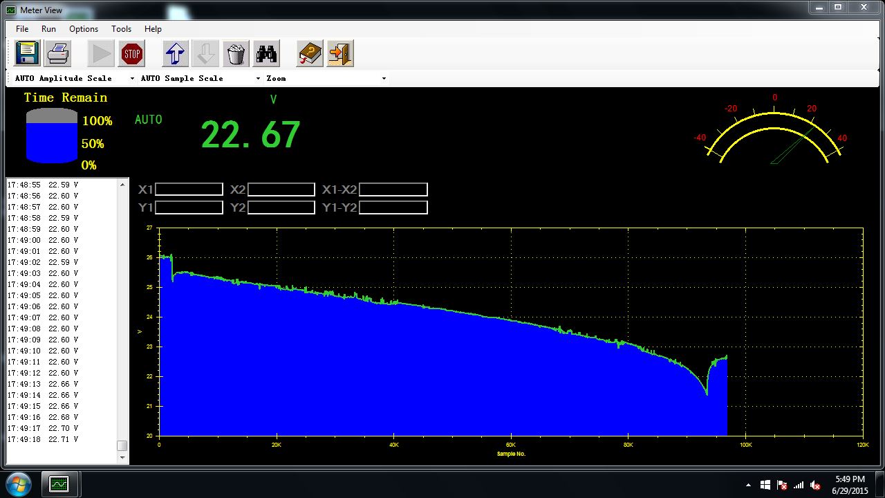

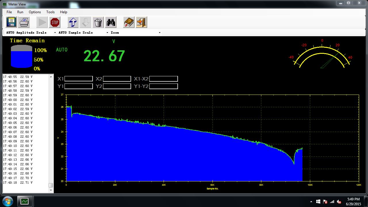

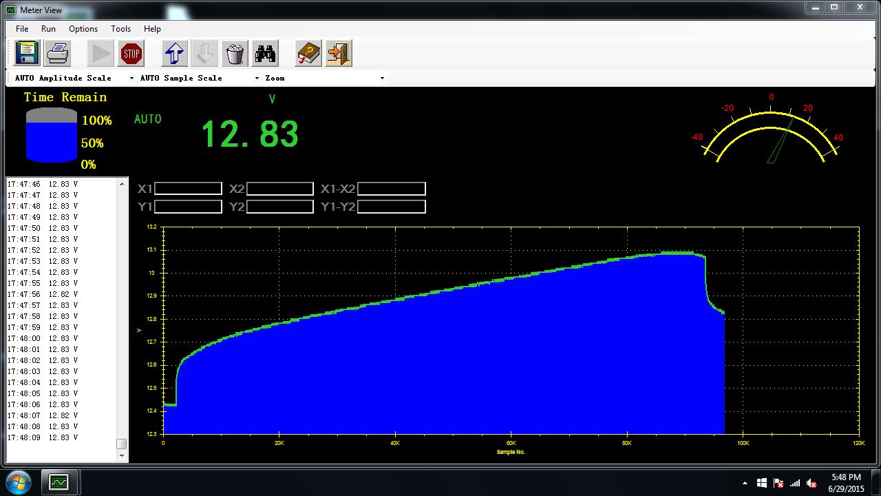

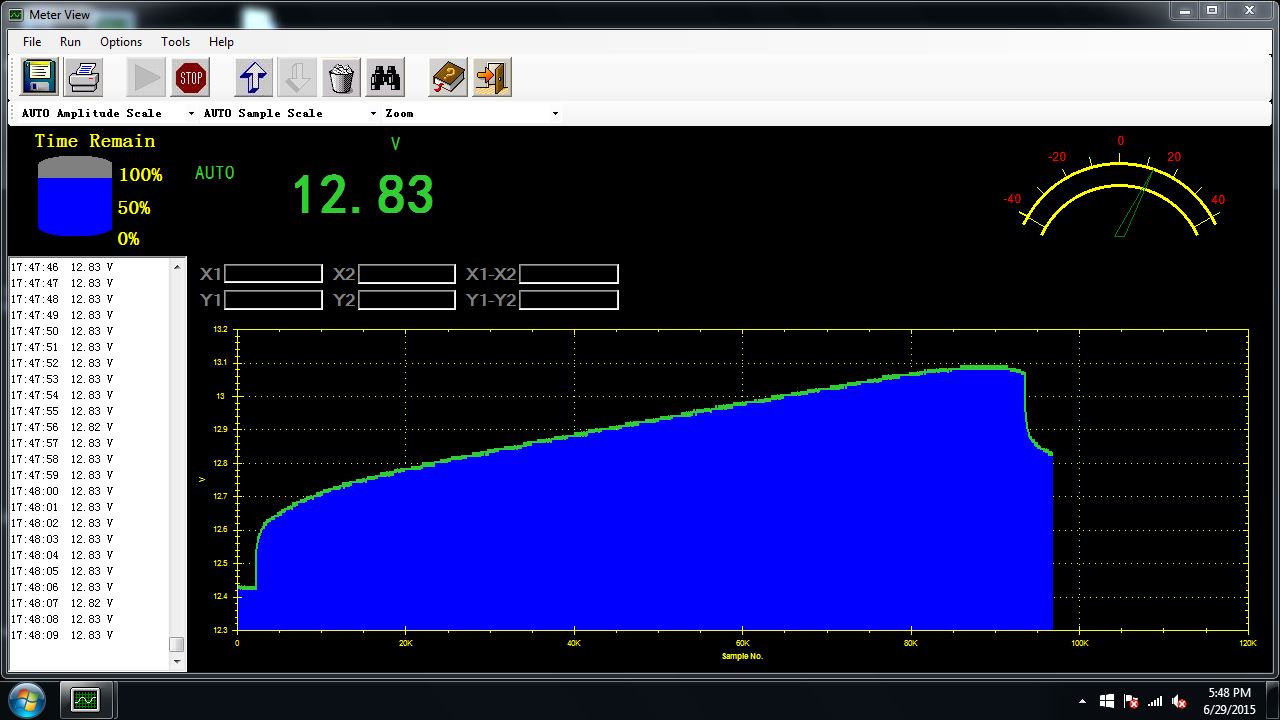

                  • I am posting another run here today. This one is done with the superpole wheel installed.
                    On the back I have 4 large batteries. Two 75AH and two wallmart deep cells all in parallel. On the front I have 2 100AH in series. This run did not make it all the way to full charge because the primaries ran low before the back made it all the way up however it was a pretty darn good charge for such a big back bank. I am sure if I had more on the front they would have pushed all the way up. This video is not to prove out a full charge but rather just to get a look at the machine running on a large bank with the superpole.
                    The video will show but I started out at about 3A draw which sagged to just over 2A by the end because of the voltage drop. It was tuned in the retarded timing. I say in the video but I think a better term for those settings would be BDC and ADC (Before dead center/After dead center) meaning when the trigger coil is aligned dead center with the magnet the slave magnet is either before or after the slave core.
                    Video:
                    http://1drv.ms/1HuqBxQ

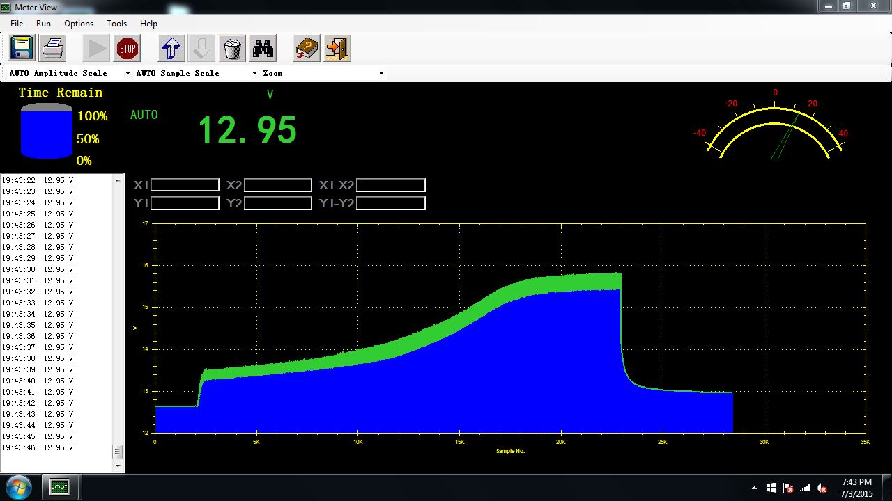

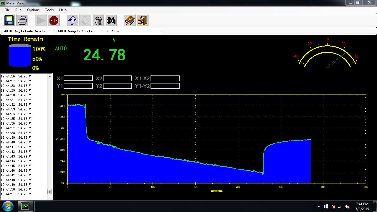

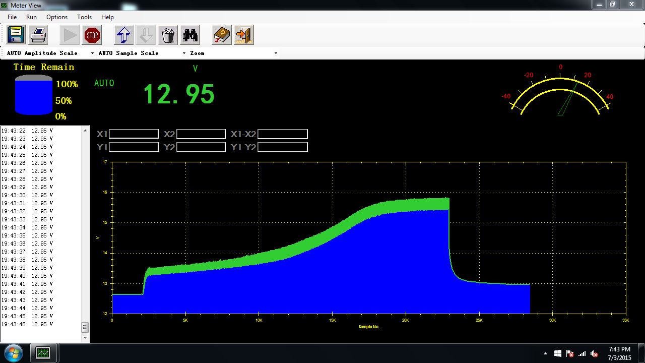

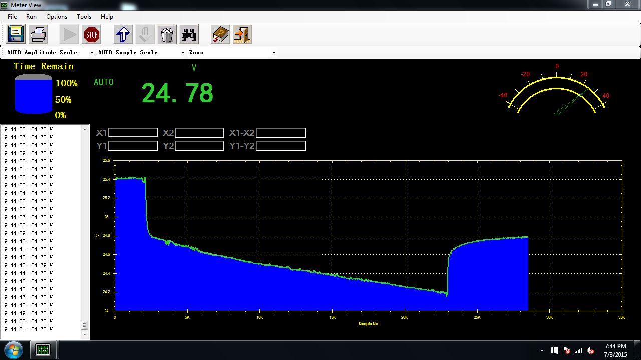

                    • I rebuilt my cap dump board and gave it a turn. This run is a cap dump on two garden batteries in parallel and two walmart deep cells in series on the front.
                      The garden batteries were not fully discharged to start with, I was basically testing the board and it did pretty well.
                      Video:
                      http://1drv.ms/1H5jcBD

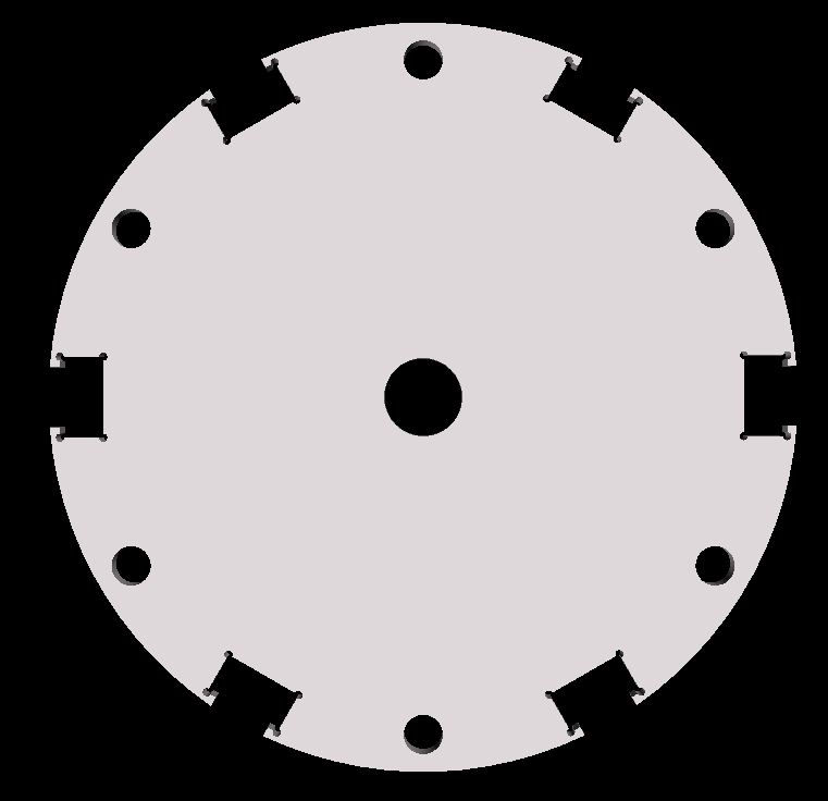

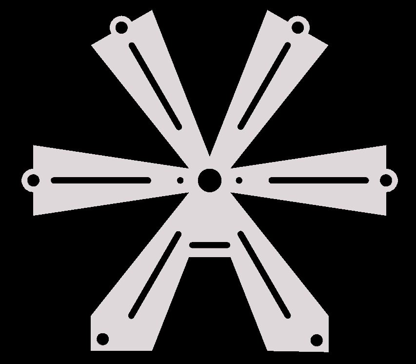

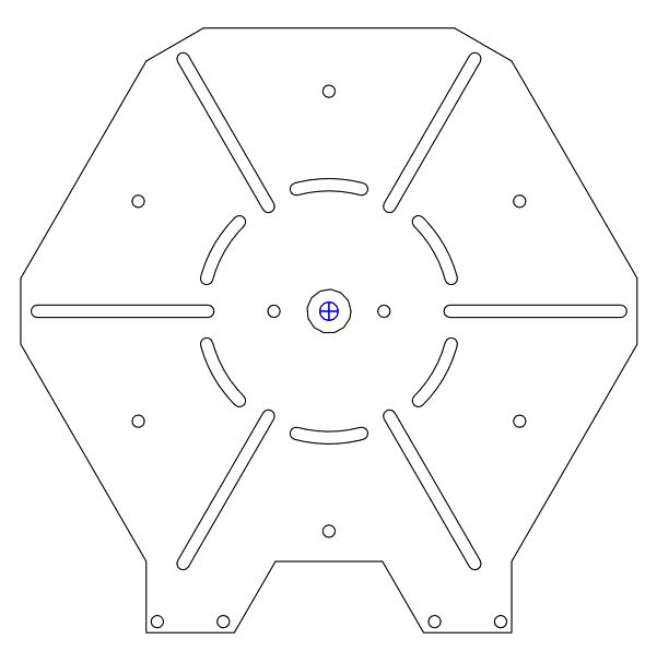

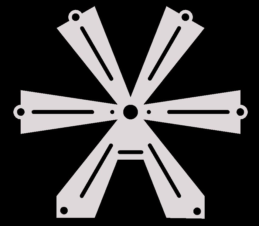

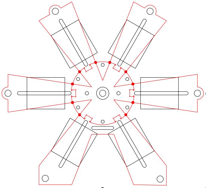

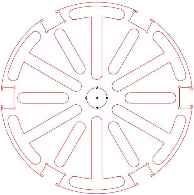

                      • I have been working on a new machine idea and finally got to where I think I might be satisfied.
                        So far these are just plans but I have the files to get it fabricated. It would be a medium sized machine with a 5 inch wheel and three inch coils.
                        Here is the frame, there would be threaded rod between them as supports through the holes in the arm ends.
                        The wheel:
                        And mock up of what it would look like:
                        I am thinking about having the whole thing in Aluminum but I could go plastic too.
                        Excited?

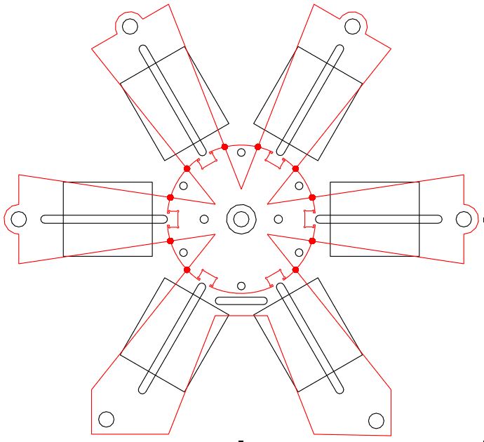

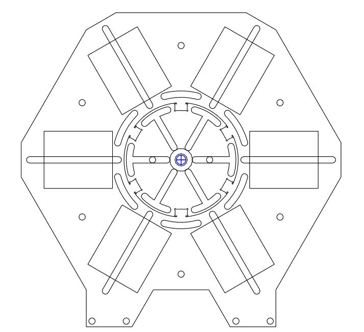

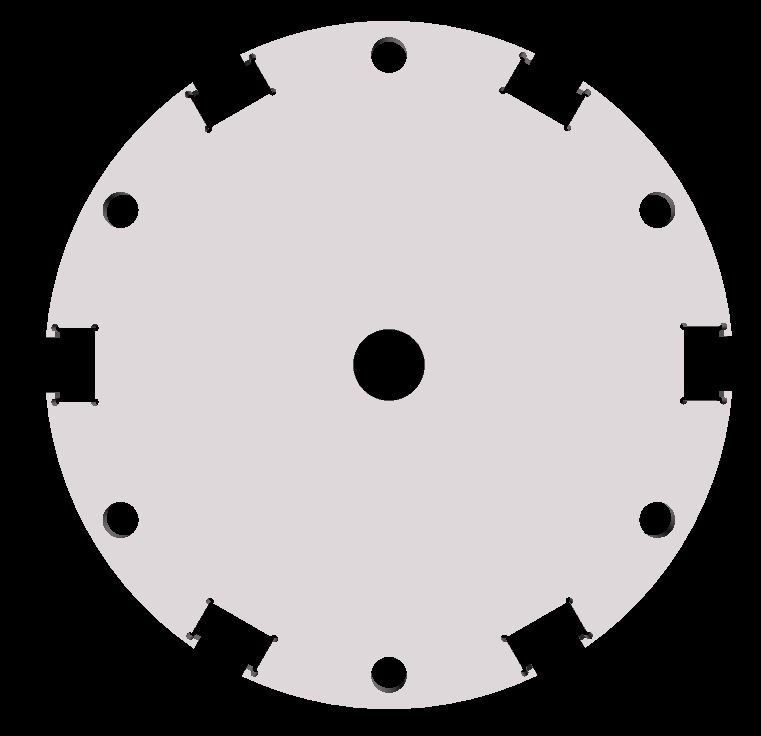

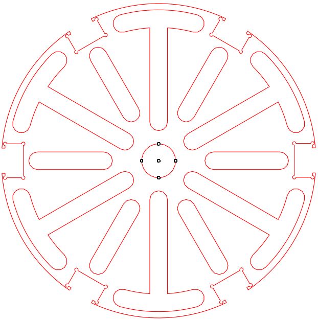

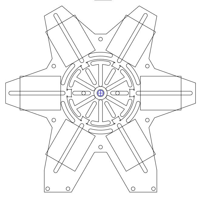

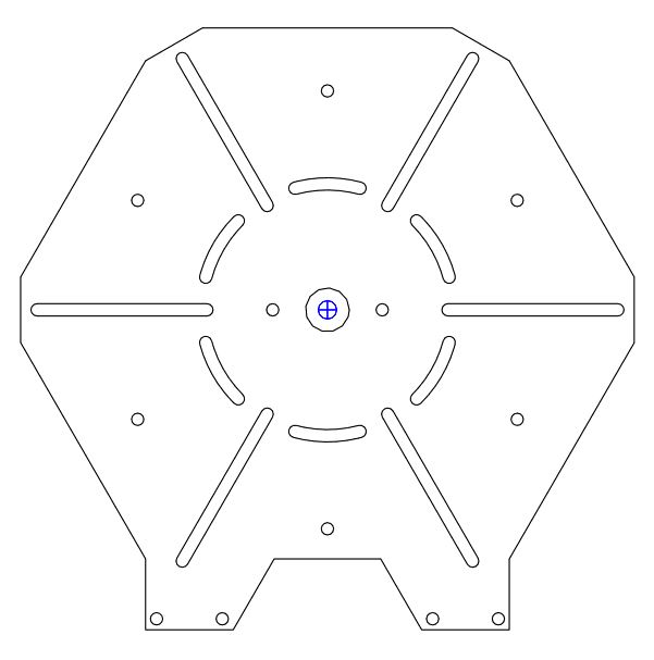

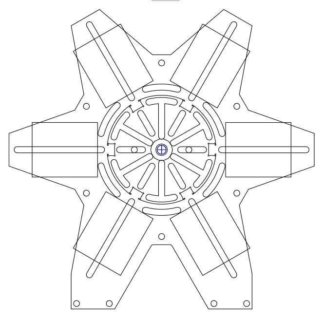

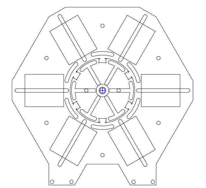

                              So here is a different mock up of some plans I have been drawing up. This should be much more stable than the first one I posted but I liked all the cool lines on the other one.
Name:	Latest Mockup2.JPG
Name:	Latest Mockup.JPG
                                The wheel:
                                Excited?
                                Bob,
                                plastic please, aluminum can get eddy currents in it, if the aluminum is not spinning it will affect your build. let mew know about the coils, if you have a design I can print it for you, and can make the bobbins any size you want.
