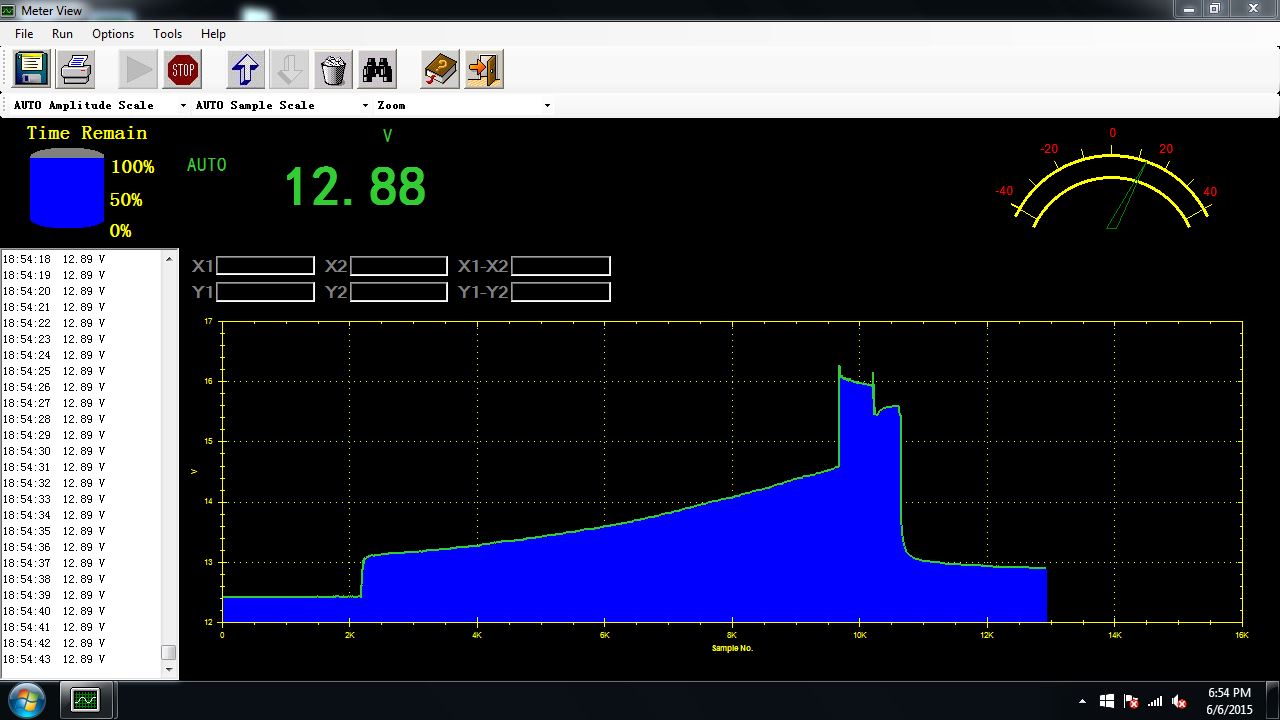

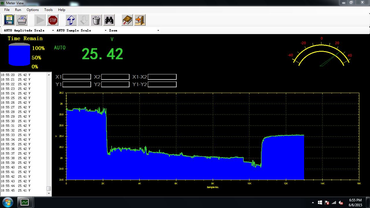

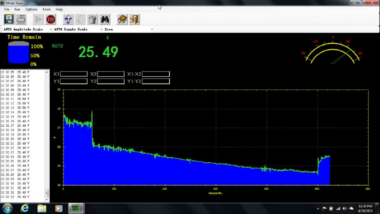

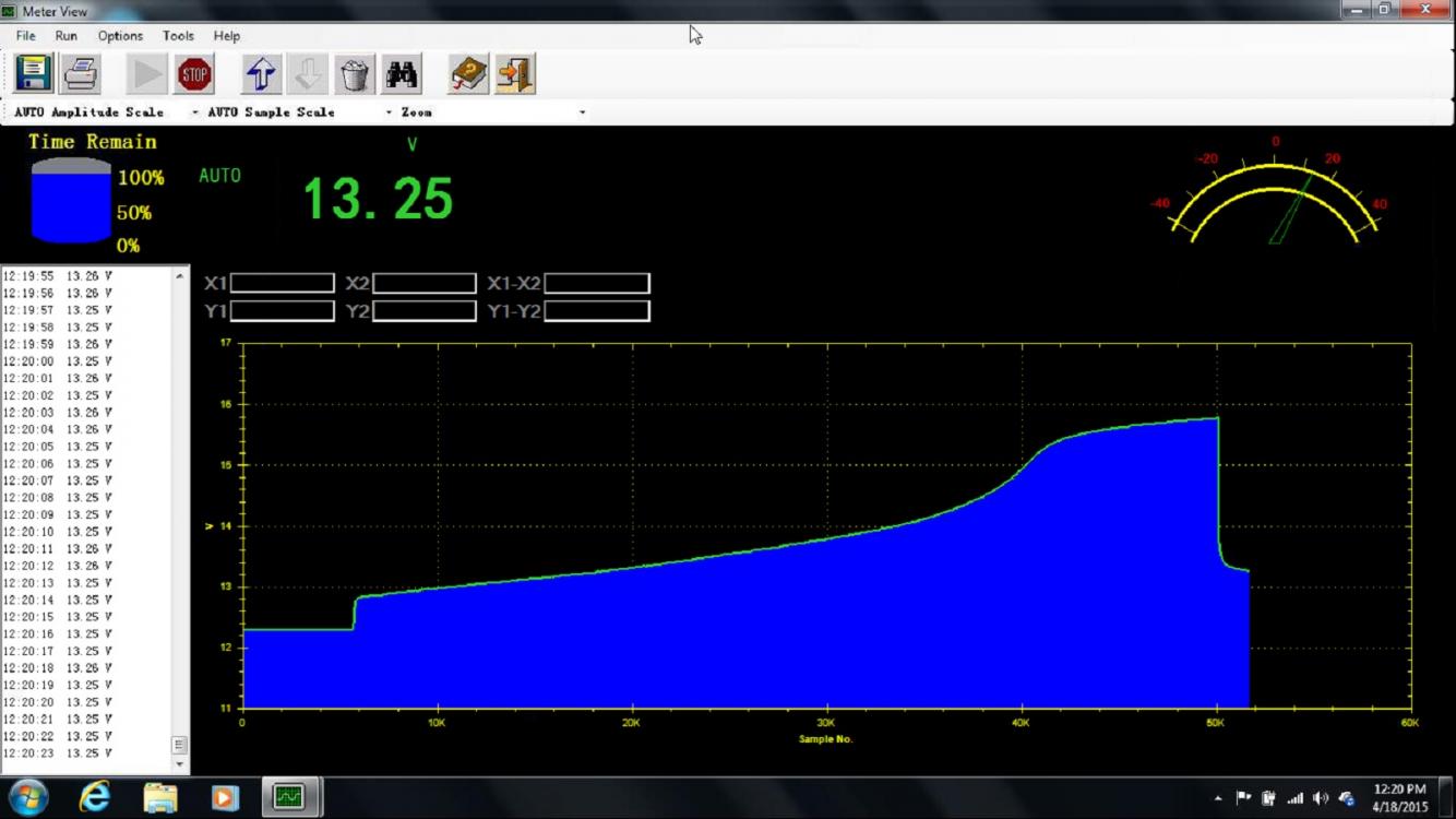

    This run is on two garden batteries in parallel for 12v. The primary is two Walmart deep cells in series. I was pulling about 2A from the primary.
    The wheel is changed out for the original SuperPole and we are running in mode 1. All four coils are connected so we have 16 transistors firing.

    • Looks like a solid run. Just watched the video. What is the capacity of your deep cells vs the garden batteries? What did the voltage of the primary end up resting at?

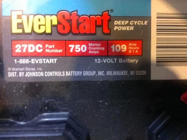

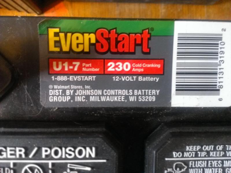

      • Hey Branch,
        It's hard to say exactly what either of them are rated at AH wise. The Walmart ones have a goofy sticker that says 109AH @ 1A.
        I think Tom has a formula to figure out CCA to AH but I don't remember. If I had too guess I would say the deep cells are about 60AH at 2A and the gardens are about 16AH @ 900ma for C20 rates.
        The primary crept up a little more but not much,, probably 25.6v or so. I did not let it settle much longer because I wanted to start another run.
        Here are some pictures of the batteries labels:

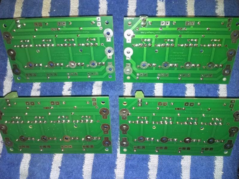

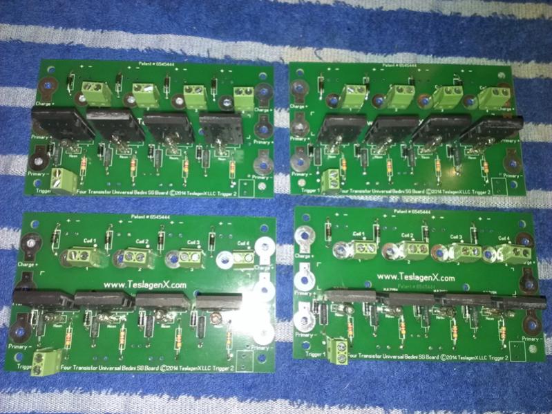

          I soldered up 4 new boards today. Next I will be working on the coils and then we will see how it runs fully loaded.
          By the way Tom if your reading, I love these boards! I was on the fence about just building some out the way I had been doing on my own when I decided to build this machine BUT I am really glad I went with these from TeslagenX.
          They are easy to assemble the first go around and easy to take off and replace transistors when necessary (which I have done many times).
          Anyway here are some pics of the boards:

          • Bob, the U1-7 looks like the same as JB has. From memory he rated them at 13 Ah.
            • Thanks John. What draw rate would you estimate is right for c20 on a typical garden battery? I'm guessing about 800ma?
              I have a CBA so I will do a run down test but I am curious where others consider to be a c20 rate.
              • Hi Bob, For that U1-7 I'd got for about 650mA.

                          • I'm back with a new run. This one is not a perfect run by any means. Towards the end of the run the machine jumped back from one spike to two and it shot the chart up and pulled hard on the primary. I decided to go ahead and post anyway as these kind of things happen and it may be helpful for beginners to see it and understand what is happening.
                            *EDIT*
                            (I planned to do the two runs but I am going to cancel that plan for now. I want to make some adjustments on the machine and that would not be a fair comparison)
                            This run was the first of two as I described in the last post. We have two garden batteries in parallel on the back and my two 100AH in series on the front. In hind sight I needed to let this one go maybe 15 min longer because they rested down to like 12.8 and I know they usually will rest around 13. The double spike incident threw me off and I thought they were done. Maybe we will do this one again for a cleaner go at it but for what it's worth here are the charts and a video.
                            http://1drv.ms/1JzufF7
